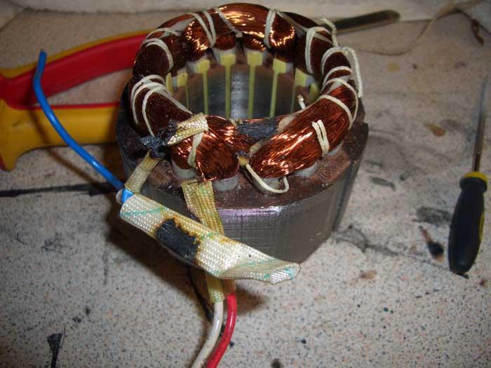

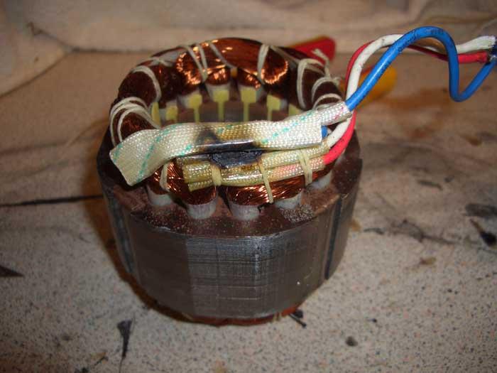

I took it apart, it looks as though it is the end of the road for this motor. The windings are burnt.
Where can I find a cheap 100w motor? I thought about a sewing machine motor but the one that I checked
was 6000rpm, but I suppose that I could use the speed control. It might be quite useful on a scroll saw.
Any other ideas?

Re: Electric motor fault
« Reply #13 on: September 19, 2012, 06:09:50 AM »
Norman, it looks like the connections are burned, not the coils themselves.  I suggest carefully cutting those 'cloth' sleeves off and looking at what is inside.  My guess is that you will find a poor connection which you will be able to repair.

« Reply #14 on: September 19, 2012, 11:10:10 AM »
YABBADABBADOO!!!!!!
John, I followed your suggestion and found a broken wire. I rejoined it and reassembled
the motor and now it is runnung at normal speed and with plenty of power.
Thank you those who made suggestions, I would have given up sooner without your help.
