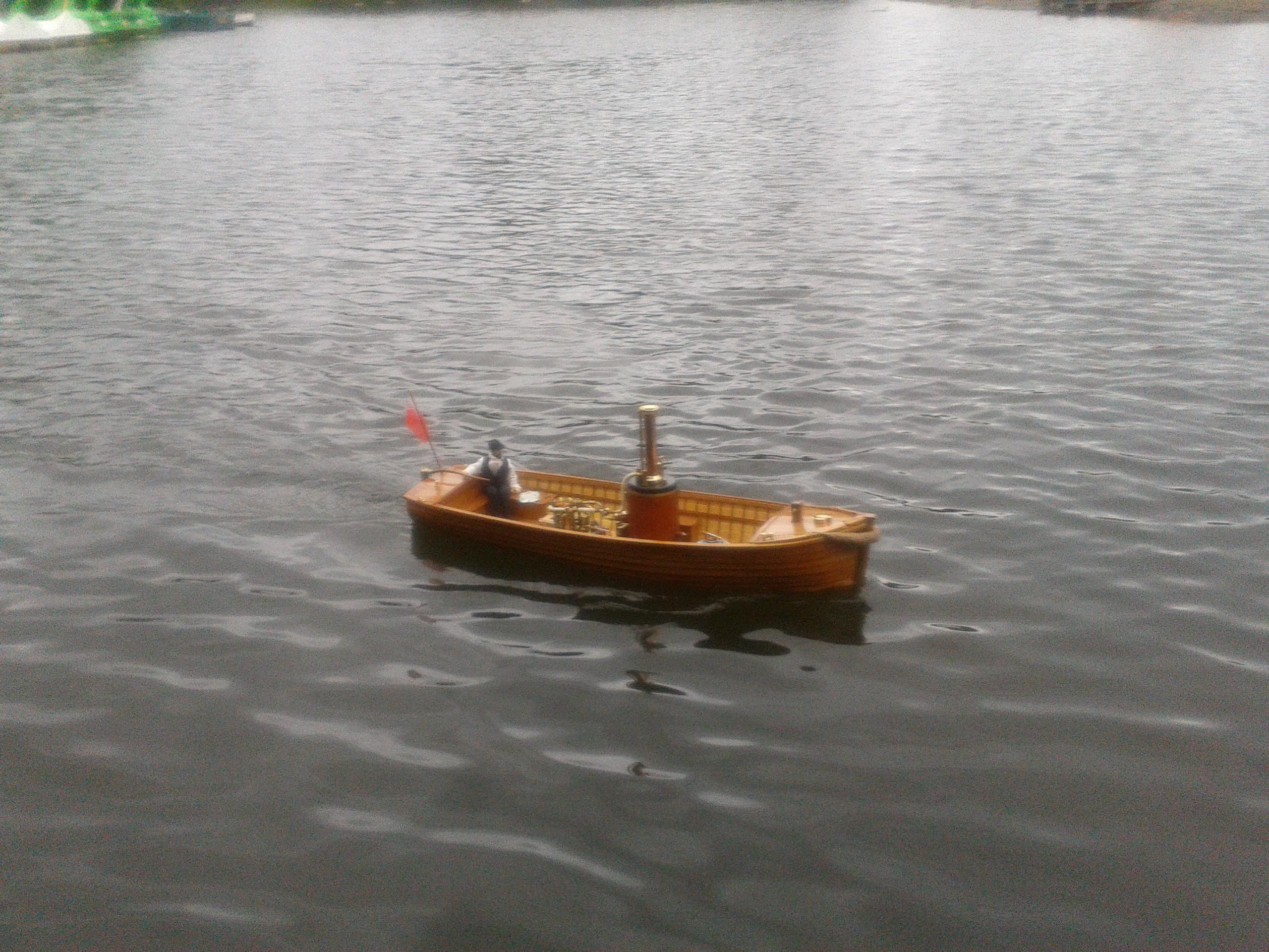

This is the finished project (well really I still have things to do but its on the water).
Mark

Nice looking rig Mark.    :clap:    What engine is that?
Nice speed on the water.
Ray

« Reply #6 on: August 11, 2012, 11:04:07 AM »
Its the Borderer engine 5/8th bore and stroke built using stock material a first venture into model engineering.
Mark

« Reply #7 on: August 11, 2012, 12:23:24 PM »
Yes much better, it now does some justice to your work! Looks that good in the video it will look much better in person! A very nice launch and power plant, it really is very nice for a first foray into model engineering  :thumbup:
Is the launch planked board by board or just scribed lines on the hull on the inside. You have fitted it out well.

« Reply #8 on: August 11, 2012, 12:54:40 PM »
Very nice!!!   :bow: :bow:
We need more details... :poke:
What is the boat...
More details on the engine and steam plant..I'd guess its gas fired..
I need to get on with my River Queen... :dremel:
This might just be the tonic I need :scratch:

Hi and Welcome Mark
Stunning launch  :bow: :bow: :bow: :bow: ,,, i like how you disguised the throttle servo as a crate  :clap: :clap: :clap:
Is that Saltwell park Gateshead ?

« Reply #12 on: August 11, 2012, 07:22:30 PM »
 A little bit of background:
I am a member of Saltwell park model boat club Gateshead UK
The model started life as a Wide a Wake but changed along the way,it is a lapstake hull so called in the USA clinker in the UK.
With an overall length of 52" and a beam of 16" its a bit of a lump not sure about the weight but it hurts.
I have used a range of timber including: cherry ,pear, walnut and mahogony.
The boiler and pump followed the building of the engine, at the moment a modified camping stove provides the heat.
I have started to look at the gas supply side of the project including making an Attenuator based on a design by Malcolm from the Paddle ducks forum.

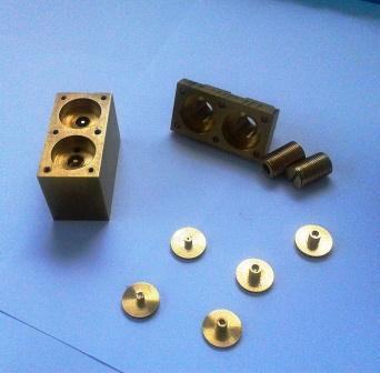

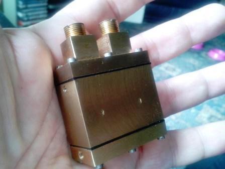

I have been been working this for a friend.
First test run
I have noticed that the flame goes out when I open up the steam valve .
I think this is due to the steam outlet which exits at the base of the funnel any advice would be welcome.
