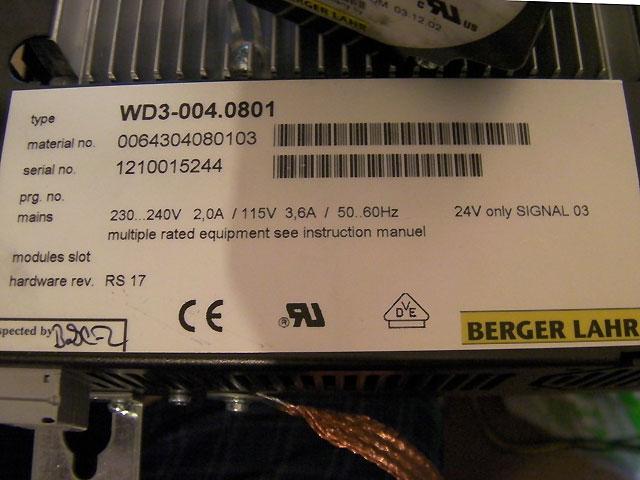

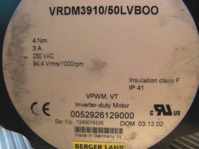

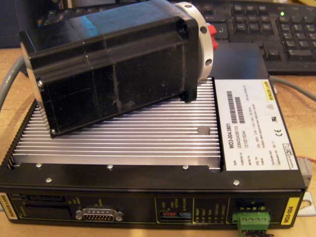

A friend of mine promised to keep an eye out for any stepper motor stuff for me, and came up with this. I know it's good quality industrial stuff, and I can get a bit of tech help off him if I can use it, but I'd in the dark about it's suitability for my home use being a CNC novice and all. I have a mind to use it for a Z-axis drive on a CNC mill project, I figure I can use this and perhaps a lighter duty setup for X and Y.
So, can anyone tell me - can I easily use this stuff? Apparently the drive has settings for 1000 and 10000 steps per revolution.

« Reply #3 on: July 27, 2012, 03:39:19 PM »
Pretty sure it's a stepper, but my buddy said he thought it could act as either, or the drive could run either, or something...
Does the attached pdf shed any light? From what I can gather it'll take normal step & direction except it runs on higher voltage.

« Reply #5 on: July 28, 2012, 04:53:29 AM »
That is a servo motor that can act as a stepper. There is an encoder at the back that acts together with the drive and usually more accurate than the stepper because once you give the order to move in amount of steps, it will do so and complain by giving an error information if unable to comply, unlike stepper who will skip steps without the controller knowing.
Re: Got a stepper and drive - but how much use is it to me?
« Reply #6 on: July 28, 2012, 05:14:27 PM »
Mine has no encoder - but the drive has a facility for one as an option. Will I encounter any problems with the 24v signal votage requirement?

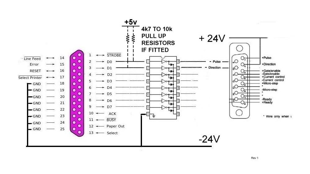

Hi Pete ,
to use the stepper drivers you will need to either convert the 5V TTL logic signals from your breakout board / printerport
to 24v levels as  used by industrial   controllers
or modify the stepper drivers to the 5v input version by changing a few resistors
to avoid modding the stepper drivers
you will need to use either a TTL logic IC with a open collector output like the 7407 or transistor array like the ULN2803
http://www.cedmagic.com/tech-info/data/7407.pdf
http://www.datasheetcatalog.org/datasheets/90/366828_DS.pdf
of the two IC's,  the ULN2803 will be the easiest use on a piece of veroboard (perf board)
as all the inputs are on one side  and the outputs on the other
with a +24V supply connected to the drivers + step ,+dir and +enable inputs
 using a  ULN2803  ,the +5V TTL logic outputs from your breakout board  will  be able to switch the drivers - step , -dir and  -enable inputs to ground
when a breakout board output is at 0v the ULN2803 output will be switched off and no current will flow through the LED in the stepper drivers input optoisolator
it will be possible to modify your drivers if you had the circuit diagram or traced the connection to the optoisolators
for each input you will need to change the resistors that limit the LED current
for 5V inputs the resistor will be  about 220 to 330 ohms

HI Pete ,
yes its safe to connect the ULN2803 input pin to the printer port output
the ULN2803 has an internal   2.7K resistor connecting the darlington transistor base to the input pin
this limits the current that can flow from the printer port , into the IC input and then to the printerport ground -
the IC commmon 0V pin 9 is connected to the printer port ground pins 18-25 and the -24V power supply terminal
if you look at the data sheet for the ULN2801 to ULN 2804   IC's
you will see they all have 8 darlington transistors with a minimum current gain of 1000
 the difference being the components connecting the input pin to the base of the transistor
the first transistor that makes up the darlington transistor provides most of the current gain and the second low gain transistor can switch a current of 0.5 A at 50V
this in effect gives you a high gain power transistor but with a base emitter voltage of 1.2V instead of the usual 0.6V for a silicon transistor
with  a  +3.3V logic 1 out of the printer port
the current into the IC will be 2.1V/ 2700 ohms = 0.78 mA
or with a +5V logic level  3.8V/2700 = 1.4 mA

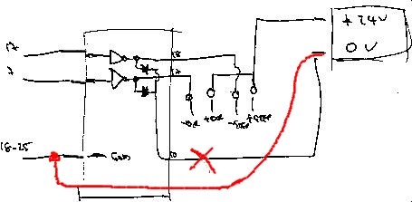

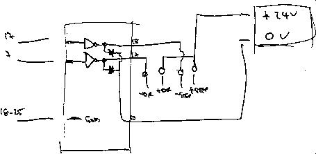

« Reply #21 on: October 02, 2012, 02:10:51 PM »
I've now got my Darlington IC mounted in a test board, and I want to wire it up to a parrallel port cable. I figure the IC needs a 5v supply which I'm going to have to run from the PC power. If I just want to control a single drive, just for testing, is it a matter of powering the IC, configuring one axis in Mach3's ports & pins to two pins and running those two pins through two inputs on the IC then taking the corresponding outputs to the drive? Is it that simple?

« Reply #22 on: October 02, 2012, 04:03:49 PM »
Hi Pete ,
you don't need to connect a 5V supply to the ULN2803
but if your printer port output  is low   you may need to connect pull up resistors
from +5V and the outputs

« Reply #23 on: October 02, 2012, 04:43:30 PM »
Thanks John, I had come up with this, obviously electronics is a weak subject for me. Can you give me a quick appraisal so I know where I went wrong.
Offline John Swift
  • Posts: 344
« Reply #24 on: October 02, 2012, 07:10:15 PM »
Hi Pete ,
just move the -24V supply from the IC pin 10 to pin 9
you need to connect the negative 24V supply terminal to the printer port ground ( pins 18 to 25) and the ULN2803 pin 9 - the common connection to the eight transistor emitters and not to pin 10 .
in this application you don't need to connect pin 10
pin 10 is connected to the the cathode of eight diodes that are normally connected to the positive supply for inductive loads like relays and motor coils
the diodes protect the transistors from the back EMF when the transistor switches off
