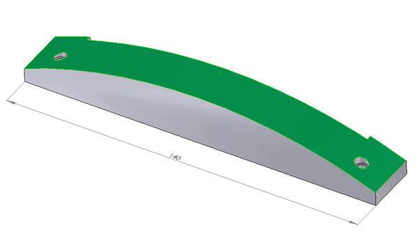

I should add I'm presuming something quite large here - if its effective diameter is less than about 8" then I have a rotary attachment which with a suitable jig would allow it to cut.
I'm think laser engraving rather than cutting
This is the piece I had in mind (i.e. engraving on the green surface)

I tried a quick test, flat piece of ply supported on a 20mm block at one end and focussed the laser in the centre so the height varied +/- 10mm and 'lasered' a line along it's length.
As you'd expect the line width varies. Either end it was close to 2mm wide with signs of charring whilst at the focus point it looked like a line that had been drawn with a scalpel.
Finding the right power setting would improve things no end but assuming the material doesn't burn then at the very least I think you'd lose resolution at the ends.
I think it would be possible to make a jig that 'rocks' the part as the laser moves along it but unless you had a production run or could think of a simpler jig than I envisage I doubt it would be worth the effort.
Oh well :(
Thanks for trying Steve. :cheers:
