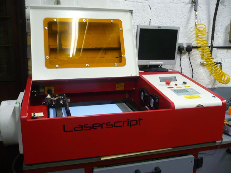

OK the laser.
Thats an A3 piece of perspex on the bed to give an idea of scale, never thought to measure it but I know from the bench it's 700mm deep say 28" and I reckon it about 40 to 43" long.
I have been too busy today with work but small son has been playing with some 3mm coloured perspex doing key fobs to sort settings out etc. Nothing fancy but all helps.

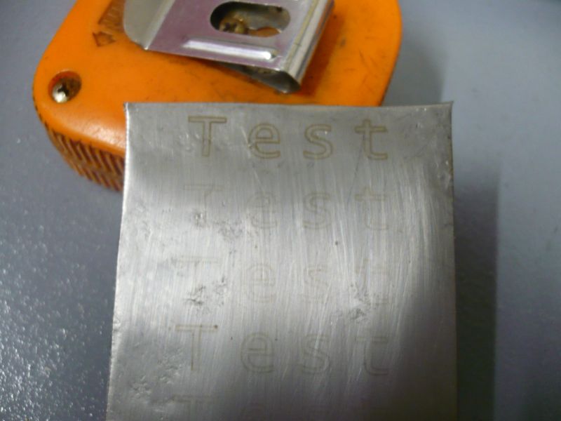

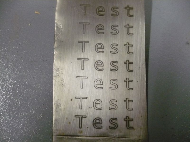

Last night we did get to experiment on marking metal. They say they won't engrave on stainless but as some people have said they will but not very clear.
This is a 40W laser direct onto stainless set to cut not engrave.
The word TEST was done 7 times at different settings but a scotchbrite pad has virtually removed the lower 6 of them.
Re ran the same test on the bottom of the same material but this time coated the stainless with some patented home brewed gunk [ all will be revealed a bit later ].
Can't afford Thermark it costs £100 plus VAT per aerosol here [ no typo ] which is an insane price but they have the US patent on the stuff.
These 7 test pieces have also been scotchbrighted at the same time as the upper ones.
Very pleased with this and reckon I could probably do better with just a few pounds worth of ingredients.

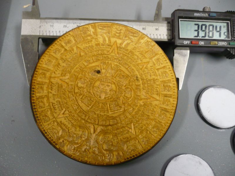

Back to playing and this is the Aztec calender that we cut out.
This is cut out of 7mm plywood, engraved then cut. It's probably on it's limit for wood as it has charred the edges. Could probably get it a bit better than this if I went onto to nitrogen as assist gas but it's not been bought for that. Awesome detail though. Ignore the black mark above center, that's a nail hole as I was using a piece of crap plywood off a packing case.

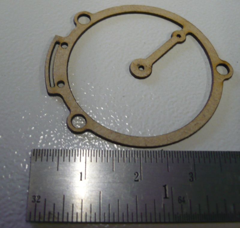

OK done my first paying job, well not really paying as these gaskets are worth 3K
Gasket for the bottom of a vacuum valve, you can't buy these, you have to buy a complete valve assembly and all that goes wrong with them is crap gets on the seating and doesn't seal, Unscrew clean the seat and refit but the gasket always tears.
OD is 35mm or 1 3/8" and the small hole in the outer bit of the leg is 0.5mm or 20 thou.
Crap video of it cutting, bit blurred as it shot at an angle thru a tinted lid.
12 seconds actual cutting time. Did 10 off to keep them going and then started playing. Still using ply wood at the moment whilst learning.
Not as easy as it looks, had to do this about 4-5 times before it was acceptable. There is a lot of detail on Merlin just under his hat and on his wand and it burns the wood away. Going to do this on gold and black laminate or silver and black for a guy who takes a Merlin to the shows and runs it under power.

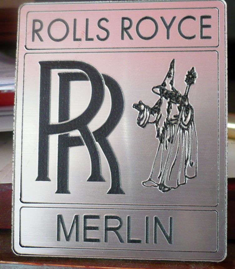

« Reply #15 on: August 05, 2012, 04:03:12 PM »
Still doing a bit of playing. machine is dead easy to use but getting parameters right for different materials is a different learning curve.
Been doing an Imperial screw cutting chart for my metric C3 lathe and can get consistent results like this now.
This in metallic laminate, scaled the merlin badge down and did it on the same material, came out reasonable but the merlin artwork is quite fussy and doesn't like scaling too much.
It's only 2" x 2 1/2" but was just an offcut of the laminate, not cut the sheet of gold coloured laminate up yet.

« Reply #16 on: August 05, 2012, 04:21:40 PM »
Hi John, how much please for one of the RR plates? i live three doors away from the two seat Spitfire. i'm sure if i took one of those around to him i could get another pillion ride...
  Lyn.
Re: Got meself a new toy
« Reply #17 on: August 05, 2012, 04:39:01 PM »
Suppose it will do  :coffee:
« Reply #18 on: August 05, 2012, 05:40:16 PM »
Yer, definite room for improvement, I'll keep trying.  :(
