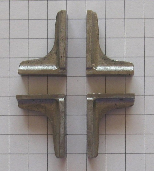

Here is a couple of  master patterns. The truss pads are right and left handed so I made a single master that the angle can be adjusted for either way. The left and right core are also shown. The little truss post guide was tricky to machine, I am really glad that I only have to make one of those. The grid is 1/4" square.
Here are the parts for a test fit. The frame is 19.25" long.

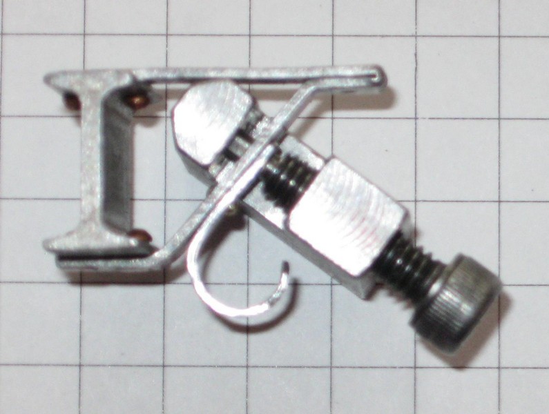

The Lima drawings that survived include some of the tools so I had to make some of the jacks that would have been included in the tool box for this Shay.
Here is the drawing of the smallest of the Lima jacks I have even seen a photo of one of these in use.
I used a 10-32 hex head socket screw to make a set of 4 jacks in 7/8" scale. The big one is one of the projects I made in shop class in college.

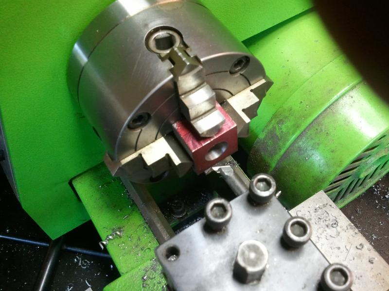

I had a handy chunk of brass hex so the first step was to use the lathe for a center hole then over to the mill and the 5C indexer is used to rough out the shape.
Back to the lathe for the round sections and parting off.

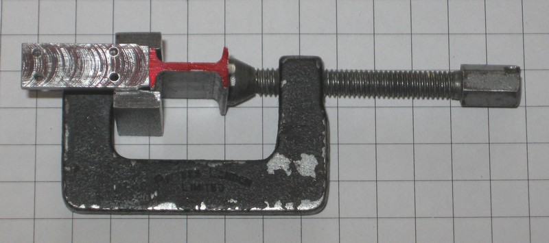

« Reply #9 on: July 27, 2012, 08:47:42 PM »
Tom, thanks for the interest.
I read up on rivets and the closest model solution I could come up with was to find a ball end mill twice the body size. This should really be 1.75 times the body but I did not want to make my own cutters.
The first die I used a center cutting end mill the size of of the rivet body. The depth of the cut was the body diameter. I then used a small counter bore or a spot drill to machine the cone on the end of the die.
The bucker and the final die are made with the ball mill to match the factory head as close as possible.
I used tool steel and did not bother to harden it and looking at the photo of the one I did today, I think I should recut the dies and harden them.
Dan

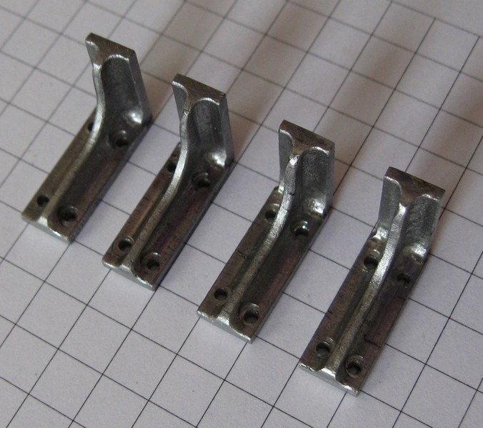

Back to the frame here are the drill blocks for the frame. The reason there are 2 in the photo is the top one is like the drawing. I used thicker channel then the drawing so I had to make a new block to match my stock.
I made the I beam the true overall cross section size with a thicker web. On second thought I should have matched the flange dimensions and made a wider beam. That would have given the correct flange depth to rivet to not a slightly narrower flange. I need all the room I can get to rivet to the flange.
This is the drill guide to drill the frame angles attached to the ends of the I beams.
Here is the full set of running board brackets for Shay Plan 1553. The short ones are on the left or the fireman's side and the long ones are on the engine side with the engineer.
This is the bending and drilling tool. The top screw acts as a stop and a clamp for drilling.
The setup to bend the odd short bracket.
Both styles of left side brackets with a slice of I beam stock.

I made another jig for the grab irons. 14 gauge fence wire is nearly exactly the size required but simply smashing it would not make tabs large enough so a fabrication seamed the simple way.
Here is the silver solder operation and a finished bracket.

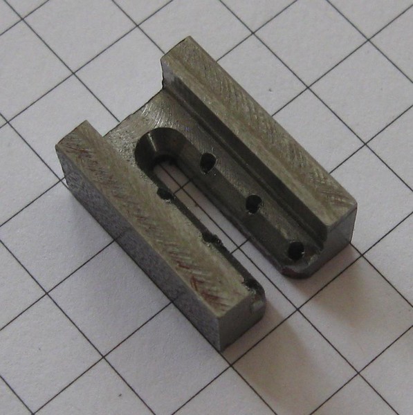

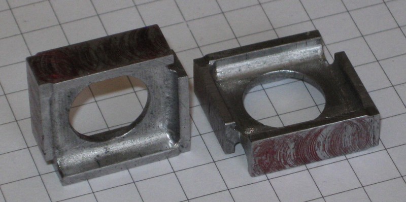

I am making forward progress on this project. The end timber braces will be attached to the bottom end of the frame rails and the end timbers. The last photo in the previous post shows the location of the braces.
The end timber braces are different on the Dulong and the Mapleton. The old forged braces were replaced with a steel casting by the time the Mapleton was built. I made a pattern for a casting but I was not happy with it and rubber molds are not the best for holding close tolerances. I decided to have a go at machining the brace.

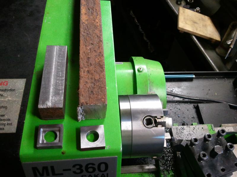

I chose some true wrought iron as it is easy to machine and I just like working old iron. The piece i used had spent over 50 years as part of a boat house on lake Michigan and I suspect that was not the first use.
Here is the stock in the chuck to bore a 1/2" hole.

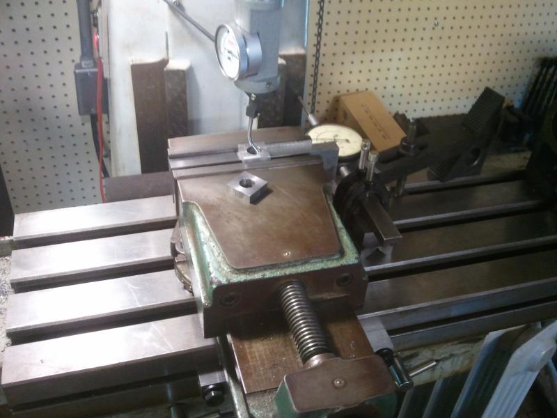

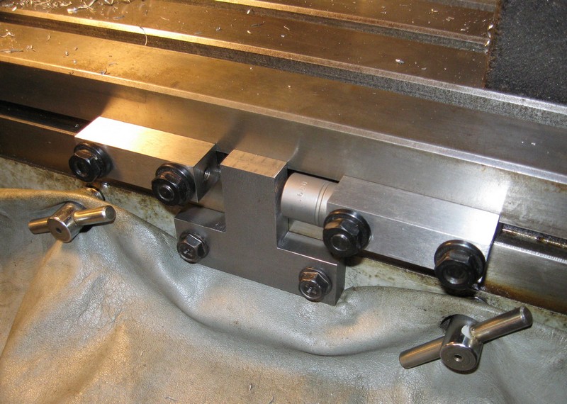

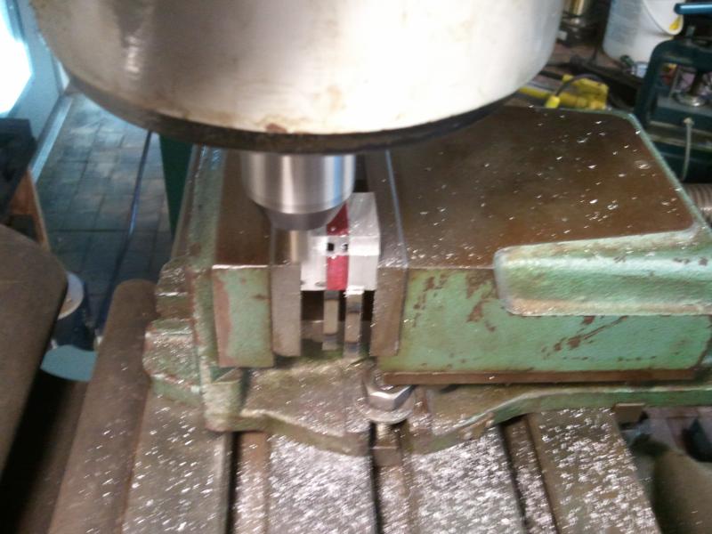

I do not have a DRO on my mill so I added mill stops to the X axis to make milling a pocket simpler. I have a set of round gauge blocks tapped 1/4-28 so I tapped the ends of the stops for the same thread.
This is the setup to mill the pocket with a 1/8" ball mill. The coaxial indicator located the 1/2" hole and the other indicator is to calculate the backlash on the y axis.
This photo shows the original stock with very heavy rust. Notice the fracture section which really shows the grain structure of wrought iron.
I used sacrificial backers to mill the braces to length. The web section is 0.055" and most likely would have taken the light cuts but I hate taking chances.
The milling is complete and the parts are ready to be cut in two sections.

Hi Dan
great work so far.  Even nicer is to see you using a superb lathe.  I have been using a 210 and 360 for over 30 years and would not swap them for anything else.
keep the pictures coming.
have fun & stay cool
Bernard
Offline Dan Rowe
  • Posts: 26
  • Dripping Springs TX
Re: Shay Locomotive
« Reply #22 on: August 13, 2012, 03:49:01 PM »
Thanks for the interest Benni.
Yes Bernard the 360 is a nice lathe and the chucks are just the size I need for a lot of the parts I make. I have a South Bend heavy 10 but I usually only use it with 5C collets and do the chuck work with the 360. I have a 5C mount for the 360 chucks which makes going from the lathe to the mill spin indexer a simple operation.
No worries I will post photos when I have new parts.

Benni, I used the trick I saw you use on the compound and used a center drill for a slot drill...thanks for the tip it came in handy.
I finished the frame timber braces. They needed a spot face for the bolts. The scale hole size worked out to 0.059" which works really good for a 0-80 bolt.
I made a drill guide to drill the rivet holes for the timber brace and the frame at the same time. The guide needed clearance for the radius so I used a small center drill to mill the slot and the clearance at the same time.
I worked myself into a bit of a corner as I have already added the running board brackets to the first frame. Well I forgot the hose brackets on the left side. Most Shays were equipped with a siphon that is a steam educator to pump water from a near by water source. The siphon was used on the Mapleton Tramway and several photos show the hose and one shows water being pumped from a line side tank.
It took me a while to come up with a solution and it was a tiny rivet press. The body of the press is 1/4" steel, and the screw is a 8-32. The gap in the press was cut after the hole was blind tapped for the bottom die. The upper section of the bottom die has a 5/64" hex so it can be installed with a nut driver. I tapped a small section of aluminum round to hold the screw and bottom die for machining. I used another screw to lock the bottom die in the holder. The pointed screw in the holder was used to mark the high and low point of operation of the press to check for tool clearance. The hose bracket was attached flat and rolled for the hose after it was attached.
Dan

I am making headway on reassembly of the frames after painting them.
The Mapleton end timbers are nearly complete. I have to cast up the push pole pockets and add them. The Mapleton end timbers are not typical Shay construction. The L angle stiffners were not normally used. The Dulong end timbers when complete will show the typical Shay construction.
My new plan for the carriage bolts is to use 1.2mm nickle silver optical screws. They come with a cheese head with no slot. I just rivet the heads and trim to length. I was using 3/64" steel rivets that I was threading 00-90... that was a lot of work for not really satisfying results.
The nickle silver 1.2mm nuts are 2.2mm AF which is a bit large for a 1.2mm bolt. I made a test mandrel to see if it was simple to cut them down to 5/64" using my 24 pin 5C indexer. This worked so I made a mandrel with matching 3/16" hex ends. The flat on the top matches the key on my 3/16" hex collet which has points up when the indexer is at zero. I drilled a hole so I could install a replaceable 1.2mm screw to mount the nut. The other bit in the photo is a hex file button to reduce the nuts with a file. That works fine but it is slow and after I dropped the third one never to be seen again   :doh: I needed a new method.
Here is a photo of my small bolt choices.
Top-- 12 BA the bolt head is 2.5mm and larger than the BA standard.
Second--00-90 brass bolt with 5/64" hex.
Third--1.2mm optical screw with 2.2mm nut.
Fourth--1.2mm optical screw with riveted head and 5/64" nut.
Fifth--1.2mm brass with 5/64" nut
Sixth--3/64" steel rivet with 00-90 thread
Bottom--1.2mm shop made bolt with 5/64" hex head and 5/64" square nut.
I am using a small press to rivet the heads of the optical screws. The scrws are 9/16" long so I drilled a 1.2mm hole in a 1/2" block of steel. To eject the finished screw I just press the die on a flat hard surface an screw pops out.
Here are some fancy jewelry items that have 1.2mm threaded holes. There is all sorts of studs available including skulls and spiders.
Dan

I have made a bit of progress on this project. I have nearly all of the frame castings done so that section is nearly complete.
I made the push pole pocket and the frame brace pad from metal so a rubber mold is a one step process to get castings. Here are the Mapleton push pole castings and the frame brace pads.
With more complex parts I usually start with wax and cast a metal pattern. Here are the patterns for the steam jamb and old style push pole pockets for the Dulong, brake rods and the boiler pad clamp.
Here are the machine steps for the boiler pad clamps. The casting has a cored hole that is drilled to tap 0-80. Then it can be bolted the fixture shown in the center. The sprue is trimmed and the top is faced in the mill.
The final step is to drill the rest of the holes.
Here are the steps to machine the frame brace pads. They are for the smokebox brace. The sprue end was chucked up and a light cut to true up the spud was made. The part was reversed and the sprue/chucking piece was cut true and the back side of the flange faced. Light cuts with a sharp tool are the order of the day. And remember which way to turn the hand wheels I stuffed one with a senior moment.
The final lathe operation is to face the spud and tap it 1-72. Cut off the sprue and file the back was the final operation not shown.
The chucking piece I left on the smaller push pole pocket did not really center well with a scroll chuck so I chopped it off and used the 4 jaw chuck. I used the back edge of a tool holder to center the flat sides of the casting.
I set the hand wheels to zero after centering the first casting and it was simple to quickly set the other castings square for the machine work. I used a small end mill in the tailstock to cut the counter bore but as it starts on an angled surface slow feed is needed until it makes a full cut.
The old style push pole pocket has a square hole for a square head bolt. I used a section of the same steel square square stock that was used for a core and drilled a hole in the center. This was used as a drill guide to for the hole. I used a thin section of plywood and drilled for the sprue and the four pins on the back. The sprue extends past the plywood and is clamped in the vise.
Here is a shot of the new parts for both the Dulong and the Mapleton. I am missing one of the boiler pad clamps but I only intend to add the clamp that has a common rivet with one of the running board brackets. The other boiler pad clamps will be located when the boiler is installed.
