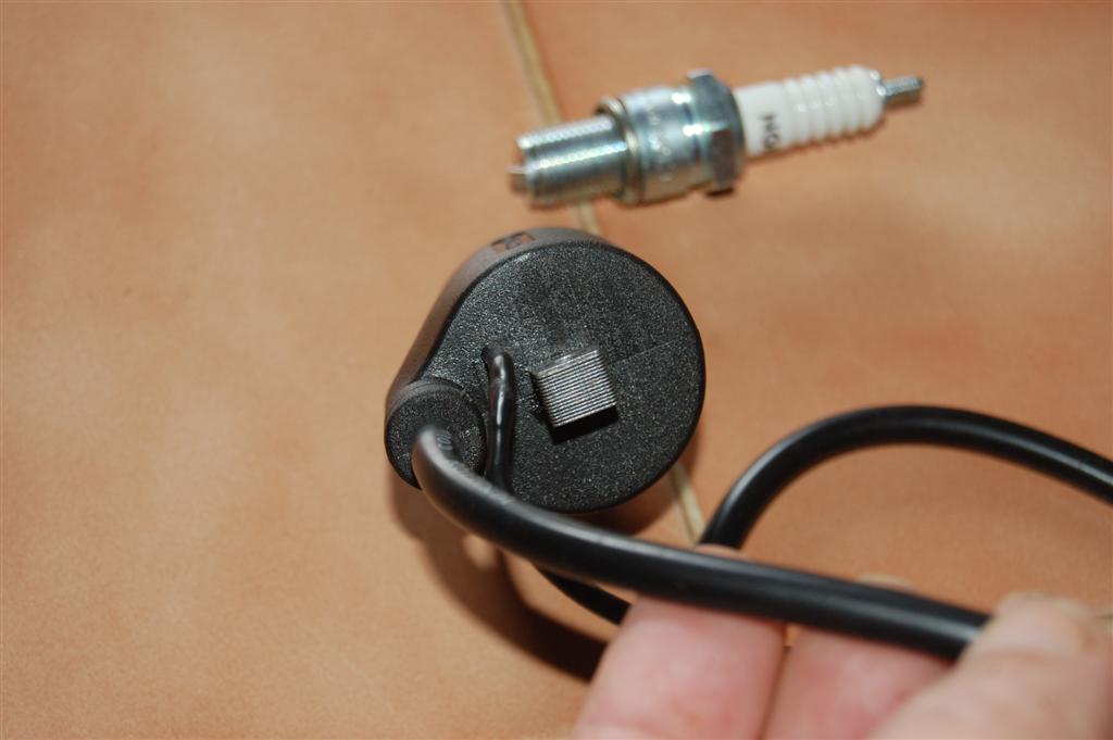

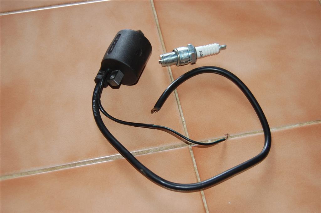

For my hit 'n miss engine I need an ignition coil.  I had hoped to use the old familiar points + condenser + coil method, and there are plenty of circuits shown on the web about them but tracking down a suitable coil is not so easy over here in Thailand.
However, motorcycle coils are plentiful, at least the newfangled ones are.  They seem to contain some electronics but with no indication of even the polarity, let alone the workings.  (I know this because I just took one apart by melting-out the pitch that filled the case.)  The only markings/label on the one I just bought are "MAX R" and a Google search for that just didn't help at all!
Can any of you explain
a/ How they work;
b/ How I might use a newfangled coil?  I'll go away from points if I have to.
Cheers,
Geoff

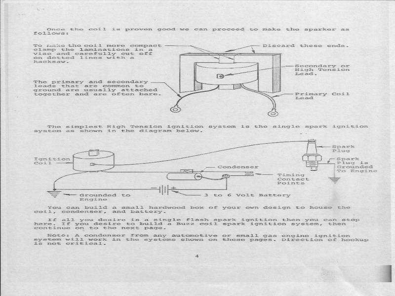

hi i will find a pic that i have and sum info on the  one im thinking of its the type that you will find on lawn mower engins they get trigerd by a magnet on the fly wheel i will post you the info tonight but whot i think you id describing is the ampleyfier IE ther is no ponts ther is just a magnetic triger on the fly wheel ther is a magnet this pases over the triger this sendes a small eletrikel pulse to the ampleyfier wich then trigers the coil to spark sos for the spelling
Re: Newfangled ignition coils
« Reply #2 on: July 12, 2012, 07:11:52 PM »
hi will this help

Thanks for that, KRV.  Unfortunately, it doesn't help - the lower part of that pic is just about what I have been trying but with a new coil in its place.  The primary current is something over 10 Amps (the books all say 1.5 to 2 Amps), and the coil becomes untouchably hot in a few seconds.
The type of magneto-coil depicted had no electronics in it, it was a simple transformer in effect.
The coil I have never went even close to the engine - it's mounted on the chassis, somewhere under the saddle - so it never gets a magnetic pulse, either as power or as a trigger.
The guts of the coil I broke-up clearly contains a circuit board with some resistors, a large capacitor and a power-transistor, all of which suggest the thing should be polarity-sensitive.  But which polarity?  My Honda motorbike's manual gives no indication.
I'm guessing that both power AND control-pulse must come in to the thinner wire - the fat one is HT to the plug - and there was a second, orange lead riveted to the core, which I assumed to be ground/chassis return to the battery.
Geoff

Saw this a bit late, have a read of this article, although its about making a buzz coil it does also describe how to use it for a single spark. I also tells how to test the coil and yes the bar in the middle is the negative to both primary & secondary coils.
http://gasengine.farmcollector.com/Gas-Engines/A-Sparker-For-Your-Engine-June-1988.aspx
Click the image gallery tab to look through the various diagrames.

And to KRV: I worked out what you are saying and realise it exactly fits the motorcycle coils I have.
Where I had been trying to use these coils in 'the old-fashioned way' of interrupting a (DC) current through the primary, KRV's description makes total sense - a flywheel-magneto 'dumps' a short-duration, heavy current into the primary, which is of very low impedance.
It also makes sense of why my Thai motorcycle-repairman friend, who speaks almost no English, couldn't understand my problem - we were coming from diametrically opposed views, though we didn't realise it.
Again, thanks to all for your input.
