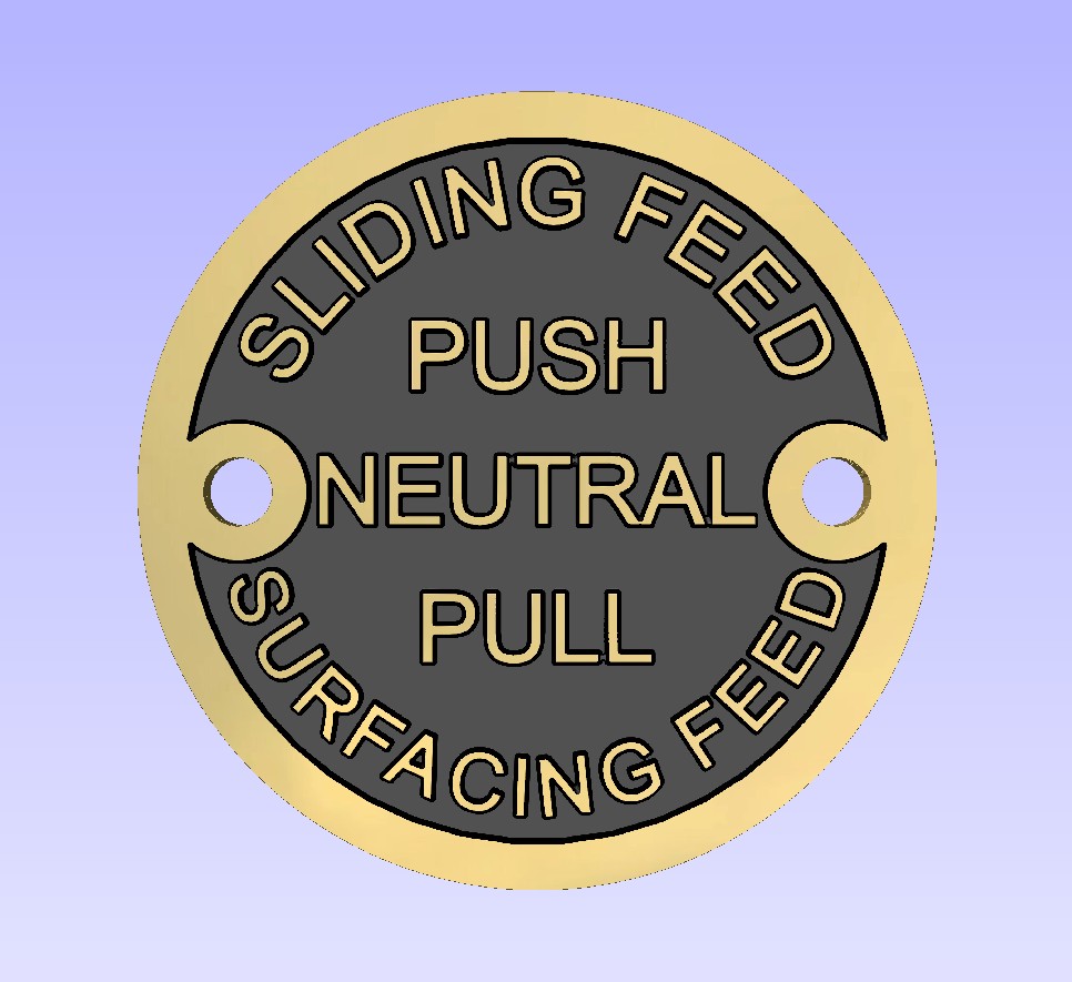

Doodling tonight, bit bored, crap night down the pub.

 John that looks the DOGS BOLLOCKS   :thumbup: :clap: :drool: :drool:, looks like you have the style sussed out there.

John that is a nicely done bit of artwork and the same as the one on my L6 Harrison,which is also the worse for wear.
Would it be possible to get a copy of that from you as a scaleable file for an etching template,please?
......OZ.

Manx,
Sorry no name.
These don't scale very well outside the program, one side of the fonts gets bigger and so does the other making the letters thicker than they should in proportion.
Let me know the OD of the circle, I guessed 35mm for this one and I'll scale it, which will scale it right, save it as a DXF and let you have a copy by PM .
