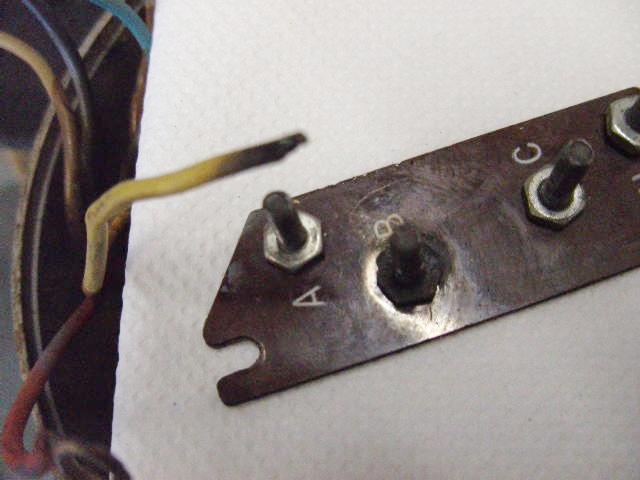

Woe, woe and thrice woe ...
One of the motor connections has failed anyway ...  :Doh:
Now sorting that out, whether it has taken out the Transwave or not .... ????

Re: Transwave Static Converter gone phttttt
« Reply #14 on: June 14, 2012, 07:54:18 AM »
Hi Bluechip ,
with luck , once the motor wiring has been repaired, the relay may well hold in as normal
Indeed it does, John .... we have a runner.  :ddb:  :ddb:
Wrong rotation at the mo', but I expected that. Don't think I've ever had a motor run the correct way first time ... :scratch:
Rebuilt the connections ... what a crappy arrangment. Now has some 2BA CH screws and nuts Loctited in ... now possible to tighten connections ...
Many thanks for the contributions gents ...

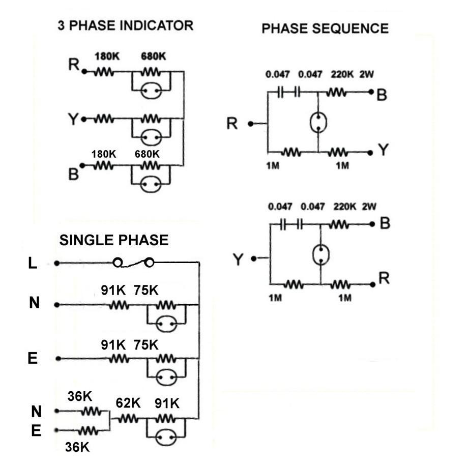

I'm sure some where I've have a simple circuit to display the phase sequence for a 440V 50Hz supply
found it! --  single phase  indicator and 3 phase sequence indicator using NE2 bulbs

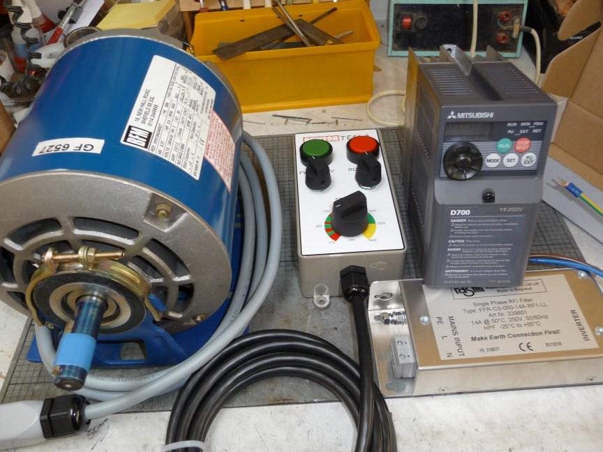

I fitted a newton tesler didn't get it all boxed just motor and controller (cheaper) for my ML10 took 5 min to wire up they are very helpfull I got a new motor at same time it,s a bit bigger than 1/2 HP not much and he said they fitted these on ML7s as well he programed it all up took the brake right down so the chuck doesent unscrew and is helpfull if you have queries great people to buy off , oh and 5 min from my house  :headbang:
Peter

Did have a look at the N-Tesla solution, but I'm not very keen on the motors. Transwave do some 3/4 HP jobbies which appear to be TEFC motors. [ TEK ?? ].
