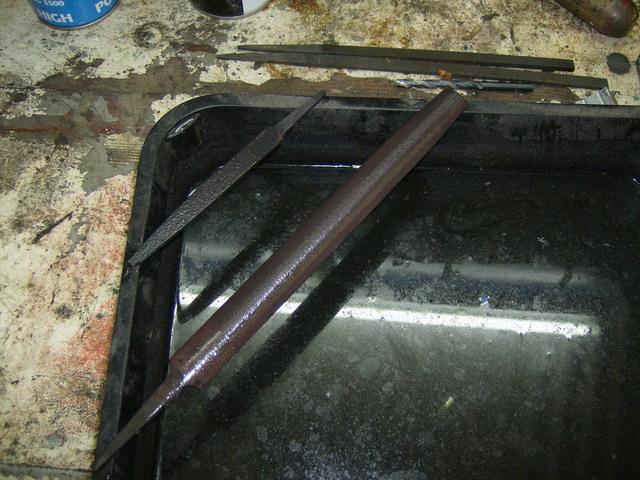

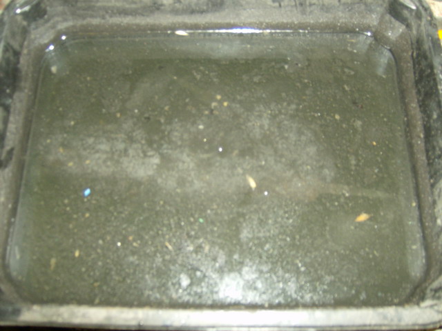

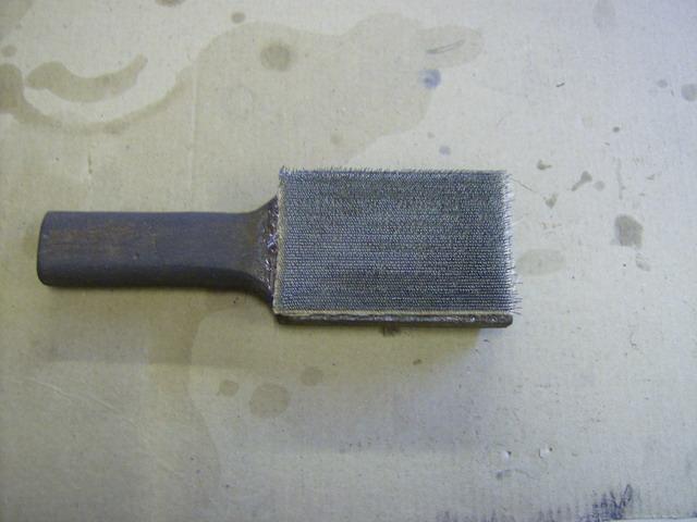

hi all i came a Cross this in a old engineering book of haw to resharpen old files so i decided to give it a go and see wot hapens SOS no pics of before but will post pics of the after right i went throw me old file collection and got a good selection of files I first gave them a gowning over with a file card its a proper wire brush for cleaning files then i put them in a large plastic tray and then put in me battery acid after 8 awers of soaking  i drained off the acid and gave them a good scribing with ruining water and a nale brush well they cam out like new dried them off and gave them a bathe in paraffin their was two relay grotty files so i have let them soak over night and i will see wot has hapend to them when i get back home

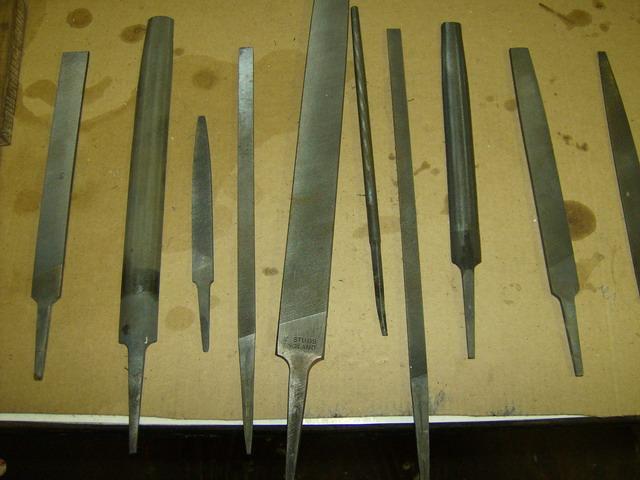

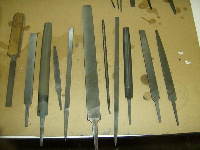

Hi all as promist sum pics you can just make out the file siting in the tub all the crap on the top came off the other files right her are the pics

Well they all look very nice and clean, but how do they cut. :scratch:

hi all cut well i tested them all on brass then tested sum on steel they cut like new
