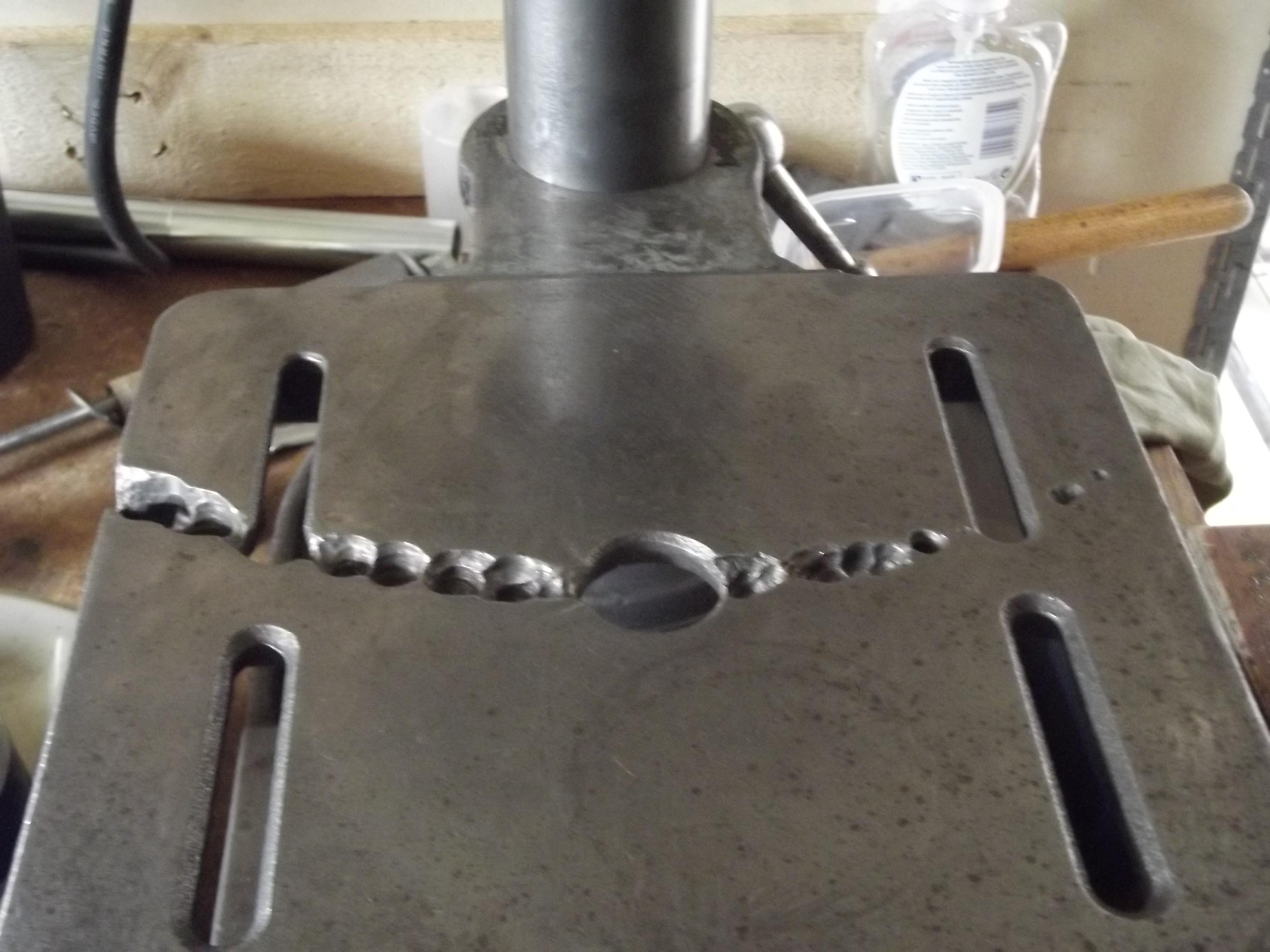

This is my first post and I am in need of some assistance to repair a  Fobco bench drill cast iron table.
Here's the problem :scratch:
I was thinking of arc welding but have read elsewhere that this is really difficult and also leaves hard spots that are unmachineable. The other options i can see is drilling and tapping for threaded mild steel rod, riveting mild steel plugs  or adding a plate over the top.
Jon

OUCH that's bad  :Doh:  ,,,,,,,,,,, i would stay away from trying to weld it up to repair the table ,, as without pre and post heat treat it will probably just snap in half ,,,,,,me personally i would get hold of some 3/8 plate and cut it to the shape of the table working surface , cut out the slots ,hole in the centre ect  and screw it to the table , if you wanted to go all out ,fill any gap left between the two with body filler and a coat of paint  :dremel:

If the master welder say don't .................
I think a plate over the top is the way to go.

I've seen worse. I once saw one advertised locally at a good price. When I went to see it I was horrified to see that the table had been severed completely and a piece of 3mm aluminium sheet had been screwed on the top to hold the two parts together. Needless to say I didn't buy it. I later picked up a good one for £80 which has since been upgraded to a Fobco 7-8.
I would second Rob's fix of a plate fastened on top. :thumbup: If you haven't got the facility to cut the slots or don't know a friendly supplier with a waterjet or laser cutter I would think you could use 3 bits of plate - a piece with a hole in the centre to match the width between the insides of the two slots and two narrower pieces of plate for the outsides.
When I was in the training school we did a repair on a bigger pillar drill where we bolted several T shaped bars to the wrecked table to make it T-slotted.
Good luck.

I only paid £80 for the drill and I really like the idea of fabricating a T-slotted table. Will have to have a rummage through the stock room aka junk pile and see what I come up with. I only paid £80 for the drill which needs other work doing, but I think it will be worth it considering what some dealers are asking for machines in not much better condition. It really is a solid bit of kit compared to the Chinese drill I've been using.

JB Weld.  It won't be pretty, but it will fill the holes and last for decades. You'll probably have to do it in steps because of shrinkage, but you can sand down the whole thing afterwards.

 I would clean up the holes for some press fit metal plugs and maybe a little machinable weld and grind for some strength as the table is almost cut in half. I asume the table is cast, if so they make two kinds of weld rod, soft and hard for this kind of project. You could add a little JB Weld to make it look better after the plugs and weld. Pre-heat cast before welding and it will work good.

My opinion? And it's worth far less than you paid. That table in it's current condition is scrap metal. I wouldn't hestate to bin the whole thing. Even brand new and unmarked D/P tables have excessive flex due to an overall very poor engineering design. Some round stock and good plate steel along with some strategicly placed stiffening ribs between the sleeve that rides on the D/P coloum and up under the table would give you a far more rigid table than a brand new one would. Proper welding is a definate need though. Machine for accuracy after welding. I've yet to see any drill press table on anything the average person could afford that wasn't just barely more rigid than jello.

Oh ... get the man who did that and shoot him right away ! :hammer: :hammer: :hammer:
When it's so much I think there is a posibiblity that it will crack if you weld it, but I'm not THAT experienced in welding cast iron.
