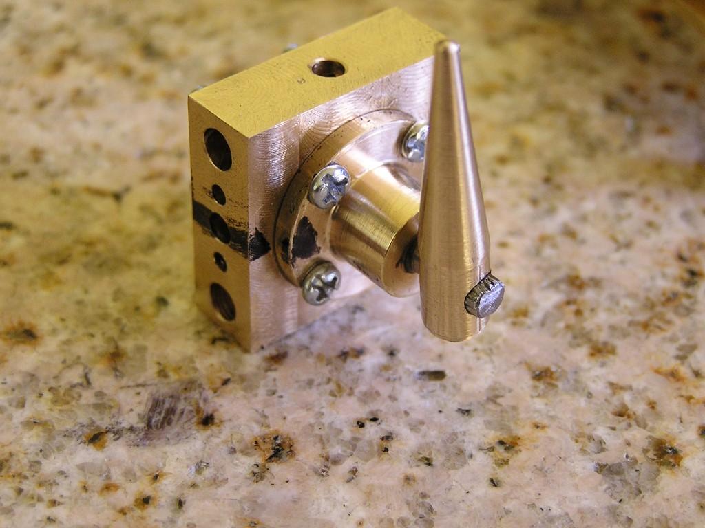

Mk1 Control valve was to wayward so I have made another.
It's darn near perfic (unless you see it close up that is)
Made the leaver out of a failed con rod, then knocked the ball off I put on the end. Oh Well.

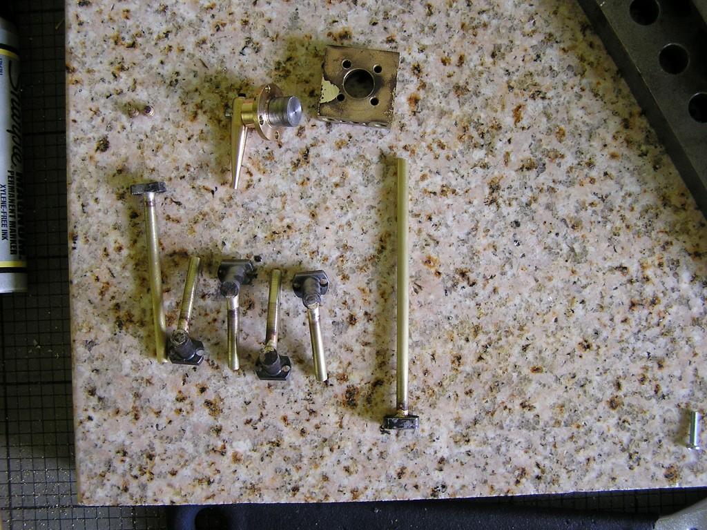

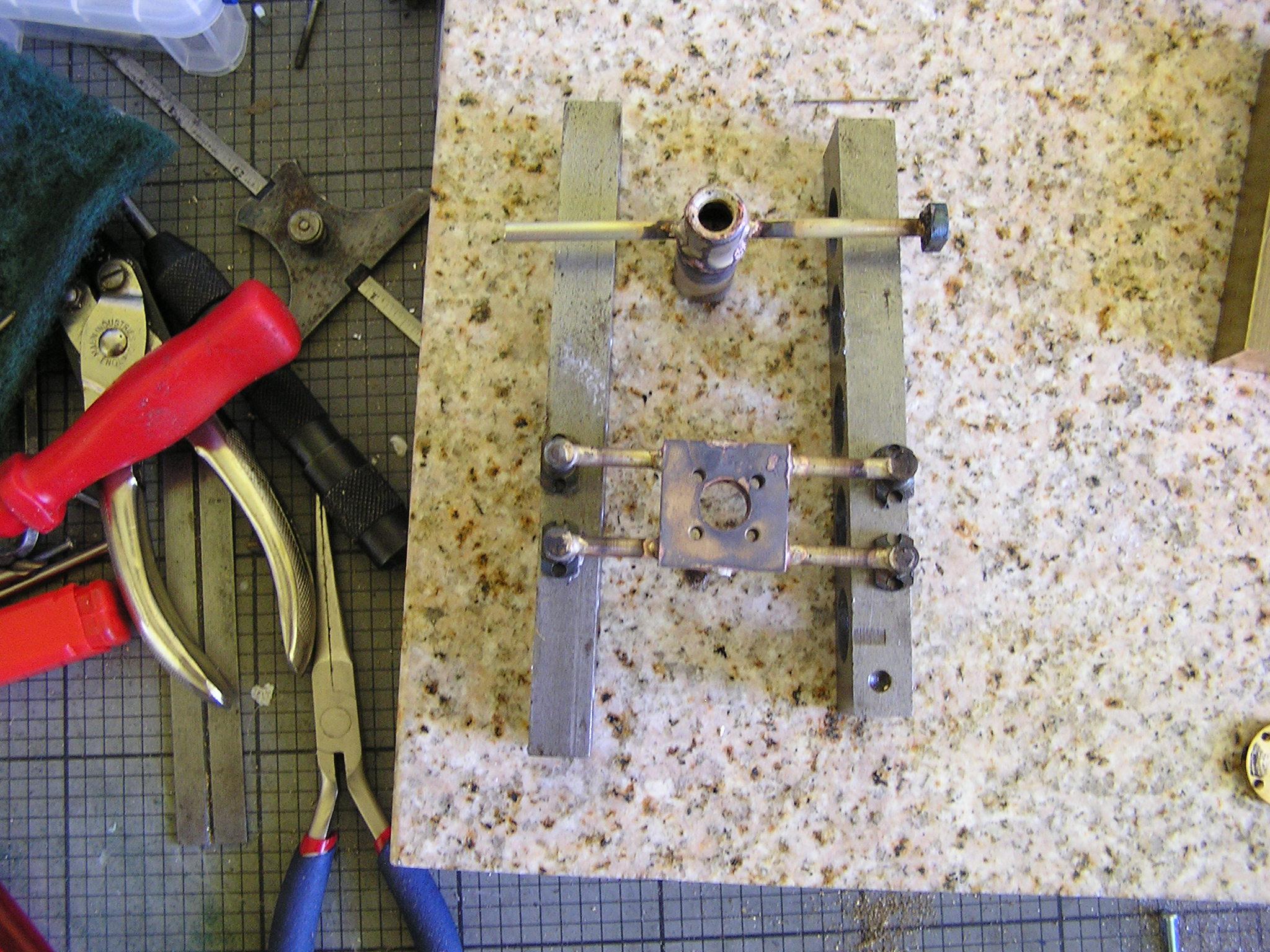

« Reply #59 on: June 29, 2012, 12:10:05 PM »
Mixed Bag today.
I made the stand off's and cut the tubes.
They all went reasonably well.
I decided not to thin them down as per the drawings.
I can understand that the pipes need to be as thin as possible but I want to get this one complete.
Soldering the pipes to the flanges was easy enough.
My Blow lamp is however not man enough to do the valve block :(
I'll nip over to a friend who has a BIG torch and do that tomorrow.
The same friend also has a compressor !
I'll take a video camera with me.
Offline ParCan
  • Posts: 154
Re: puddleduck engine build
« Reply #60 on: June 30, 2012, 09:34:13 AM »
Spent thismorning making the Oiler. Last bit done.
M8 with the blow lamp has no Gas (
I went to buy Gas and bought a Large blow lamp as well.
All soldering is complete, just need some Pickle which will make things easier to clean.
Tomorrow i'll see if it actually works !

« Reply #62 on: July 01, 2012, 12:33:37 PM »
Well, all i can say to myself is RTFM.
The reason that the stand offs are thinned down is not to keep the tube thin.
It's so the screw heads fit !
No cookies today, I will probably need to remake the entire valve assembly.
Alex.

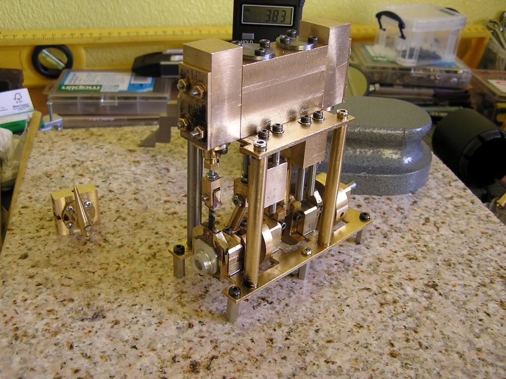

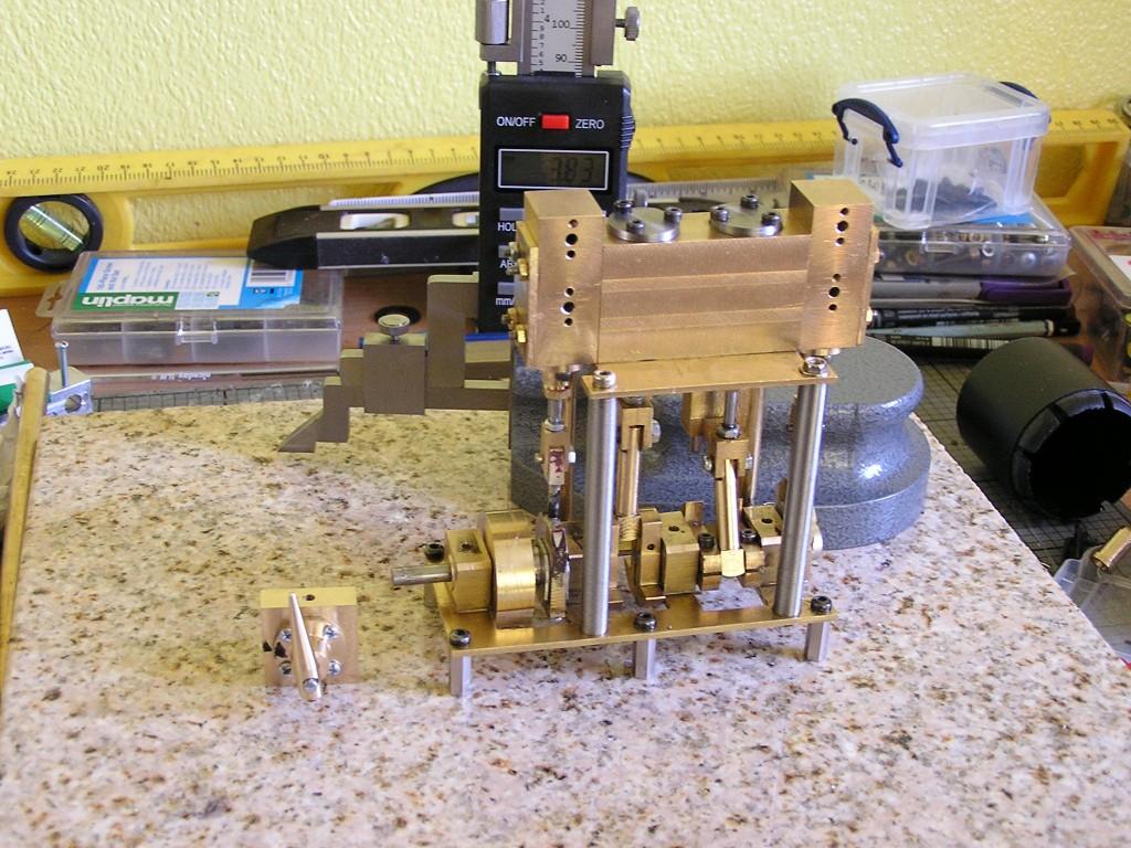

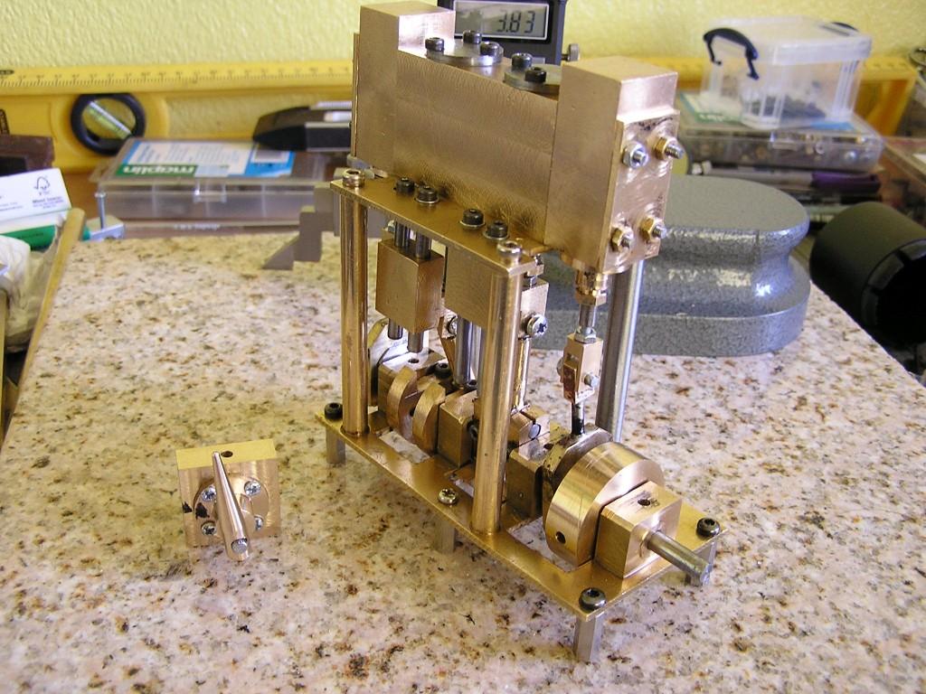

« Reply #64 on: January 22, 2014, 01:35:33 PM »
Hi Guys. I'm Back  :ddb:
And I am rebuilding the Puddleduck I started and completed 2 years ago. (it never ran and never was going to run)
No Pictures yet, but progress has been good.
Base is remade out of a lump of 16mm thick ally. (just don't look to close)
Crankshaft Main's remade and this the holes all line up this time.
New cylinder block made. Just need to drill and tap the cylinder caps.
New pistons, rods and glands that are all concentric made.
I'll do some photo's shortly.
Alex.
