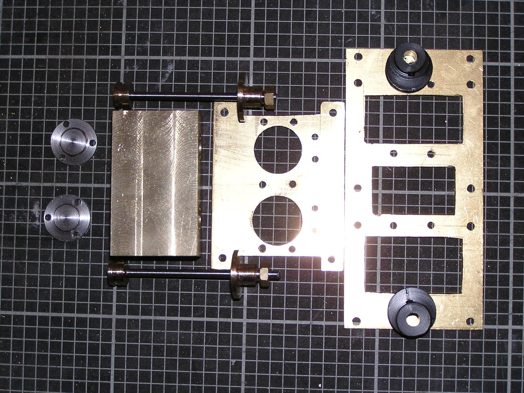

After a few days off sick, i got back in my workshop yesterday.
I now have a Block, Pistons and packing Glands to add to the other bits.
The pistons still bind slightly and need a tiny bit more lapping.

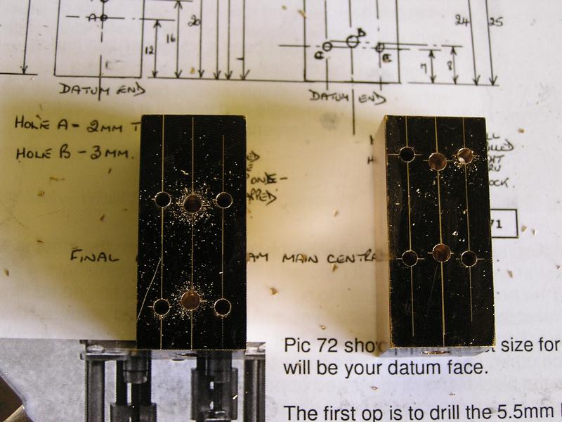

Got off work early and wondered down to the local engineering supplies for some of the blue marking out gunk.
They sold me a tin of "Stuarts micrometer engineers marking"
Have I got the right stuff ?
This seems rather reluctant to dry.
The stuff I used years ago I remember drying in a few mins......
And yes - I now have Blue Fingers !

« Reply #11 on: May 04, 2012, 03:22:40 PM »
I think that you have got some of the engineers blue, ink that never sets. What I use for marking out is just the biggest permanent black marker that I could lay my grubby hands on, works the best ever. I had 3 or 4 of them in my workshop laying around the place.
They may not be great for marking up large surfaces, but anything 6" square or less will "black" up just as quick and much easier. A lot easier to store too.
Tim

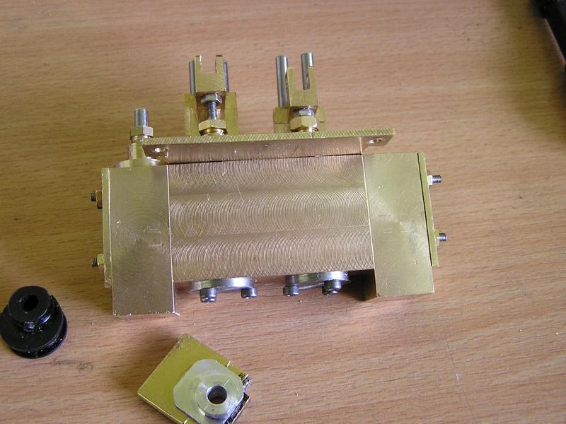

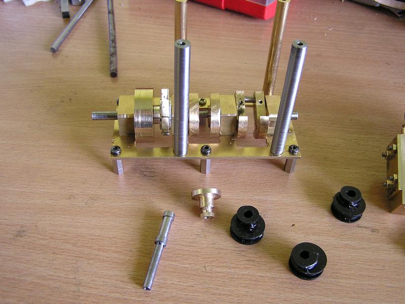

2 Crossheads made today.
Oh boy was that a long and slow task, and 1 could end up in the scrap bin :(
I drilled the Piston rod hole 90 degrees out ( in the wrong side )
The part would be fine but the drill got pulled off line by the hole for the pin.
Repair attempted - we shall see.
Photo - ya gota be jokin - had enough for today and I still need to clear up.

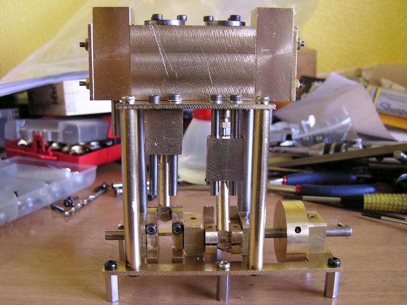

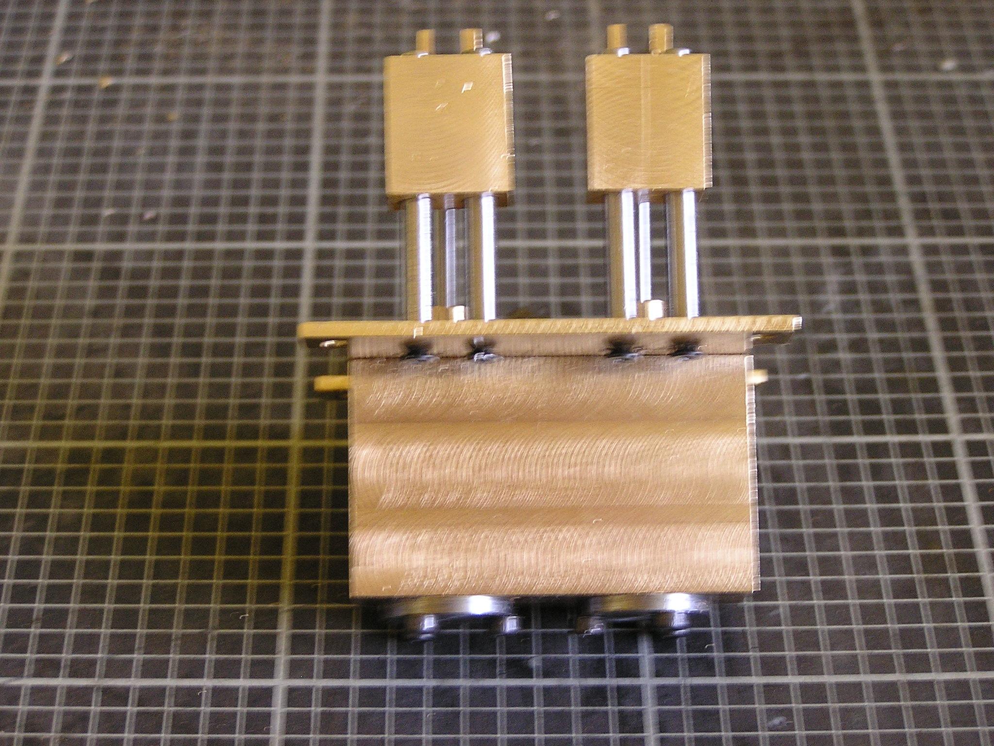

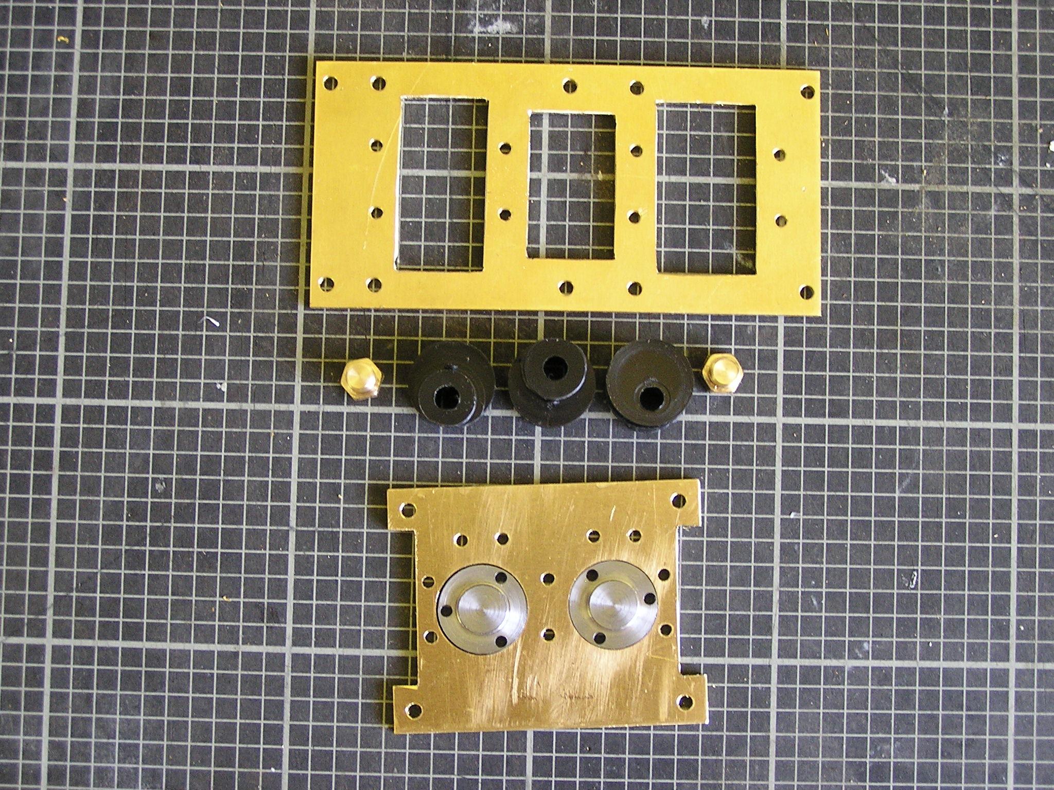

Offline ParCan
  • Posts: 154
Re: puddleduck engine build
« Reply #13 on: May 06, 2012, 11:10:56 AM »

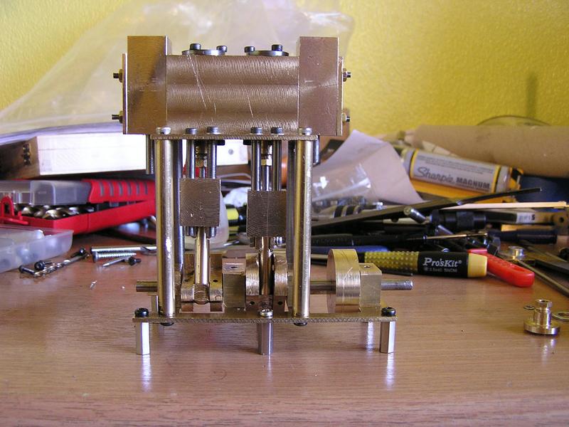

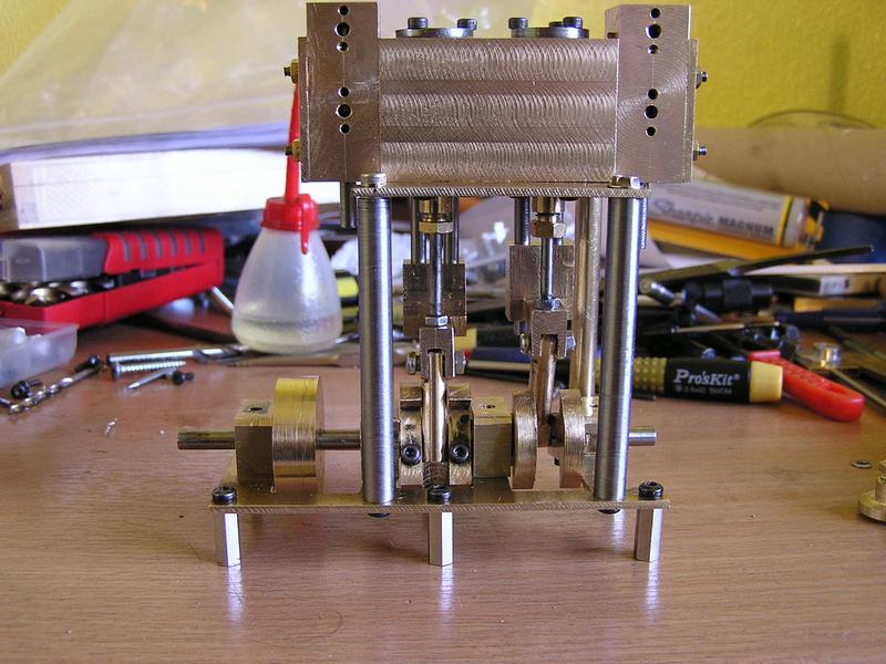

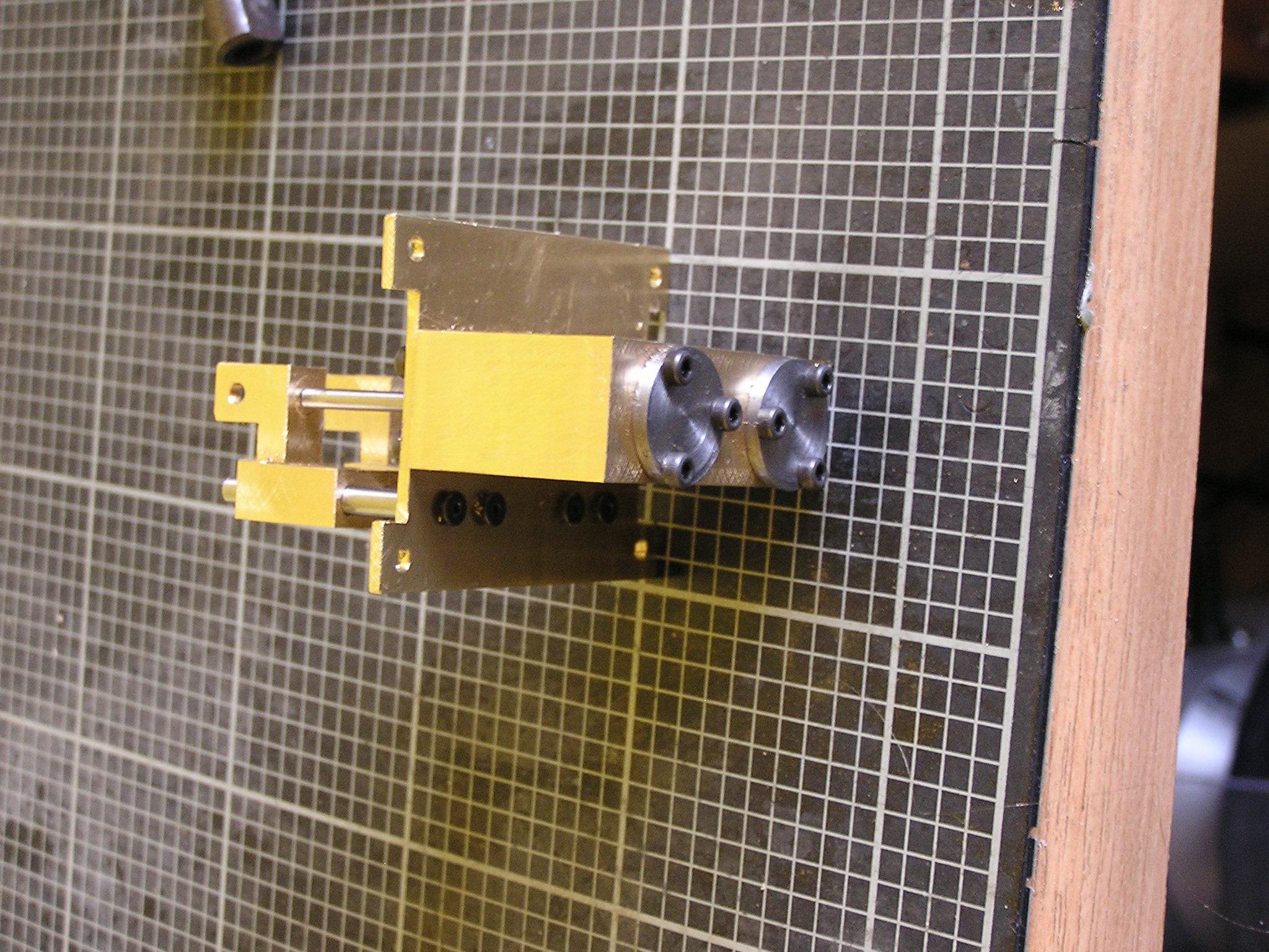

Got some more done today. (With Pictures)
Remade 1 packing gland.
Put the Cylinder caps on. They look good.
Made the Flywheel.
Assembled most of the top of the engine.
Put the Base plate on the Cylinder Block.
The slides still need lapping in a bit.
Pistons all move as they should without Binding on the glands.
I made the fly wheel over size then drilled and reamed the center hole.
To keep it concentric I have turned it to size on a bit of Rod turned to fit the hole.
It's still slightly wide. I will trim it to thickness another day.
Also I need to work out how I drill it.
Tomorrow I will tackle the Bearing Blocks.
Plan is to Drill and ream them all on 1 bar.
Drill the Mounting holes using the Milling Slide still on the Bar.
Part them off and turn them to thickness.
Hi Tim
Got a Big Balck sharpie today.
Works 100% Perfic.
Thanks for the tip.

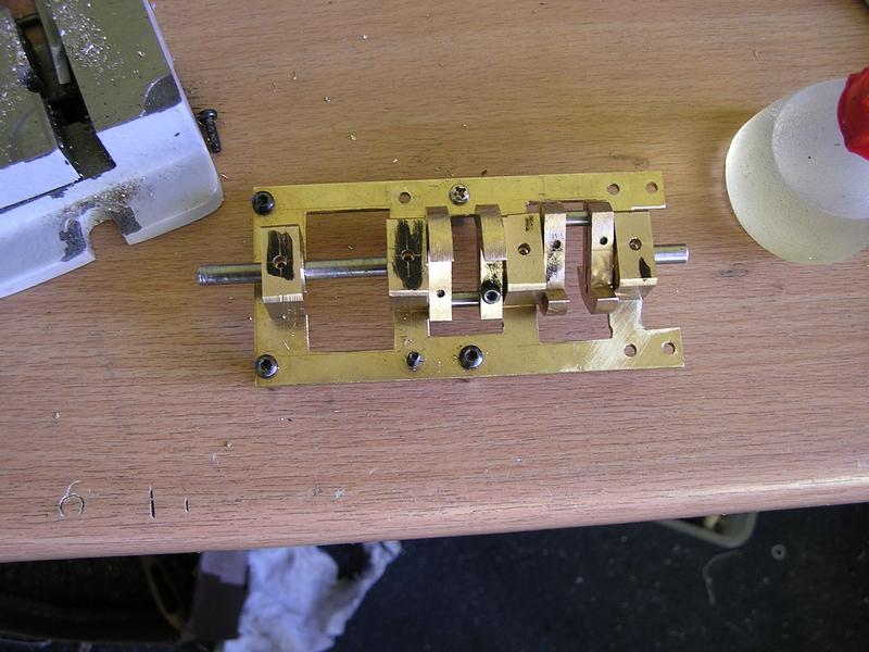

Offline ParCan
  • Posts: 154

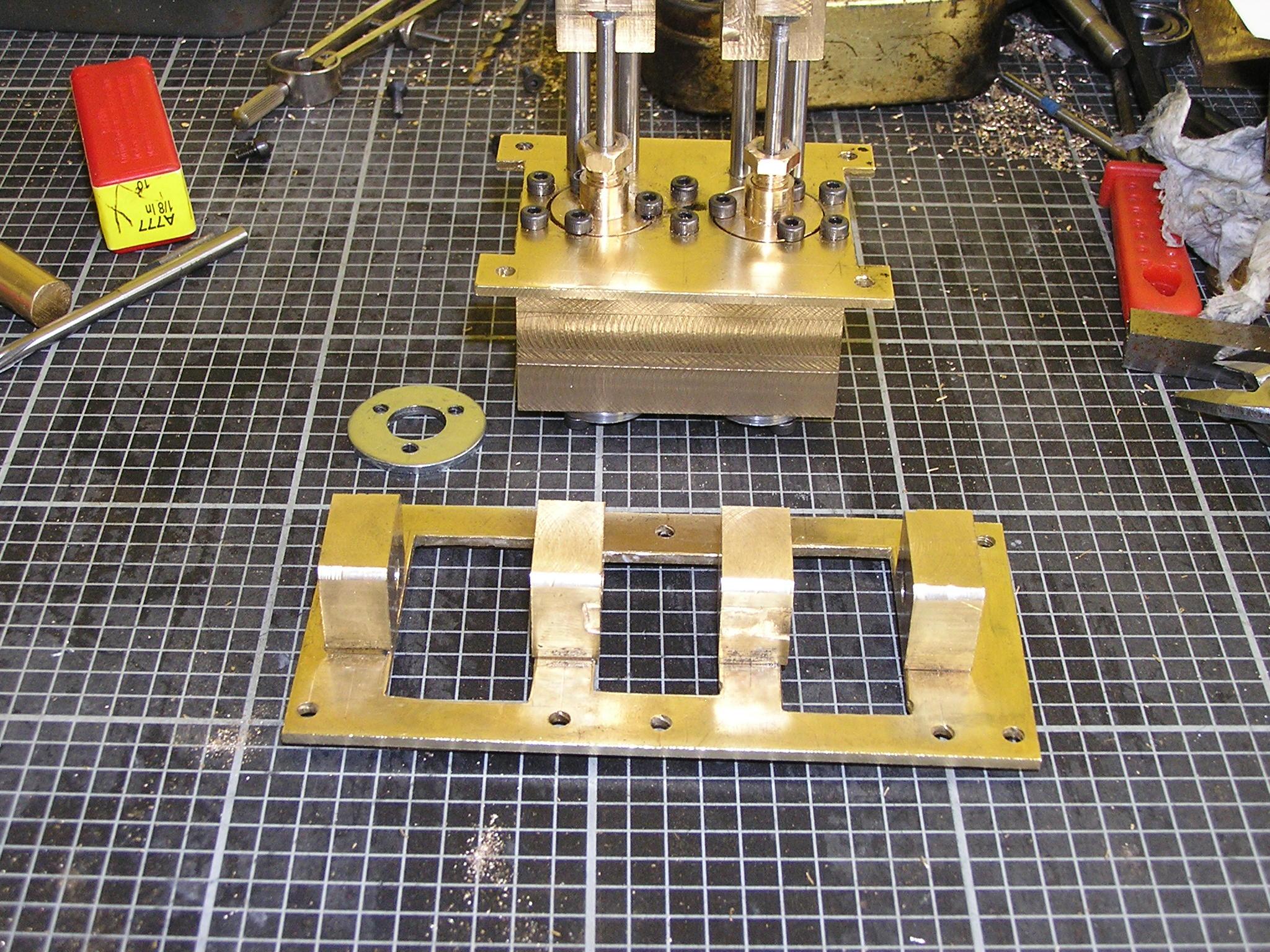

« Reply #17 on: May 07, 2012, 12:43:56 PM »

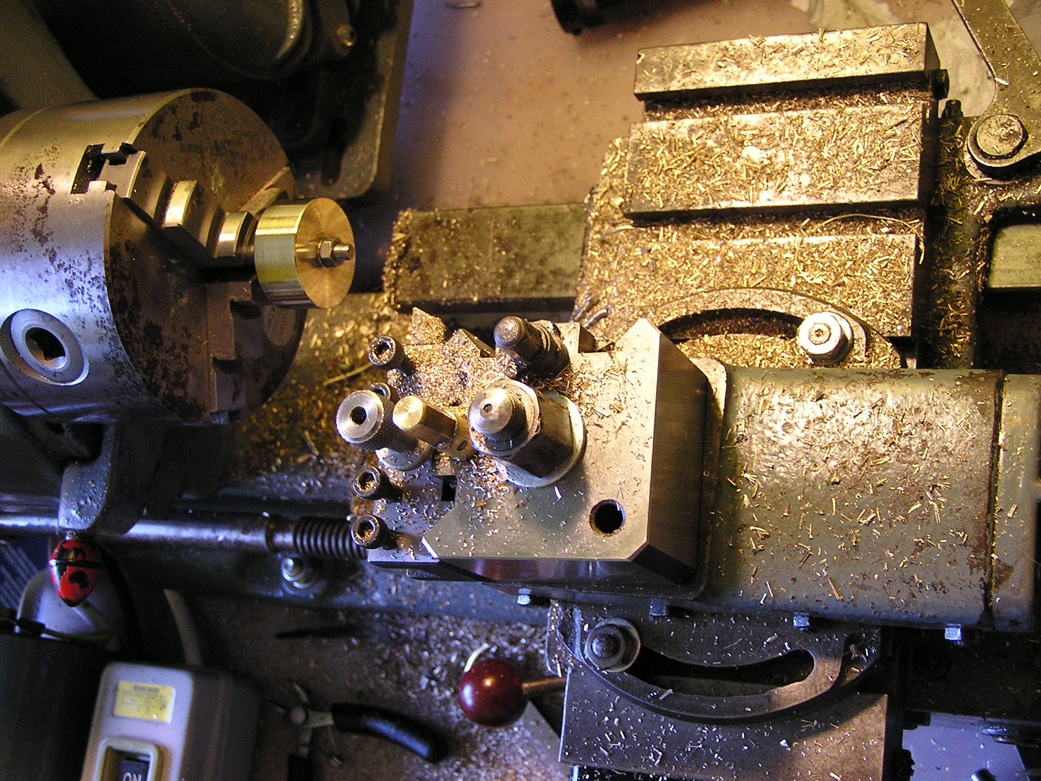

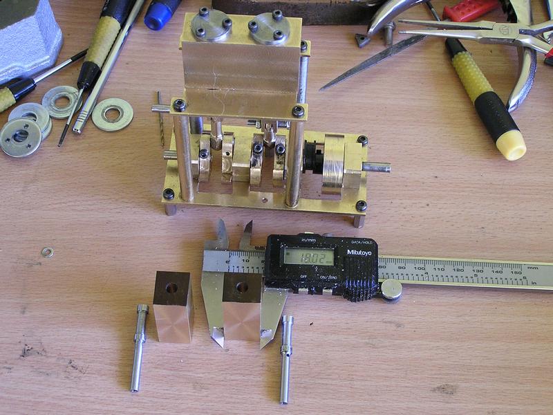

Cylinders assembled.
Still a bit sticky in places but nothing a bit of use will remove.
Pistons seal well
The washer is my tool for drilling the Cylinder caps and Packing glands.
1 10mm washer. Put in 3 jaw chuck.
With a Spirit level get 1 chuck jaw horisontal.
Scribe a mark on the washer with the lathe tool. Repeat 2 more times.
Mark a circle with dividers.
Drill 2.5 mm in 3 places
Crude but it worked for me.
Made the bearing blocks today.
Had to make em out of 3/4 square bar which is only 19mm. Close enough (I hope).
They were not hard to make.
Take bar. Mill to 15mm thick.
Put in a 4 jaw and center for the 5mm hole.
Drill 4.5 mm and ream to 5mm
Part off 2 at 10.5mm thick. Make a note of which way around they go.
Re drill / ream for the 2nd pair.
Part off the next 2 and repeat (I made 6)
Mill both sides to get to 10mm thick.
Drill the holes for the base plate and screw down as they came off the material.
Lapping was a breeze - took maybe 5 mins and the shaft spins freely.
Alex.

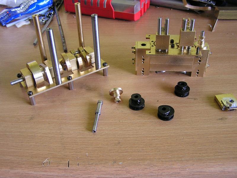

« Reply #18 on: May 08, 2012, 03:40:39 PM »
Oh Bother !
I made the beraing Blocks upside down !
I can see there is no chance with getting away with that and whilst my bits are not the best - this is a learning thing for me, I'm not even going to attemt to turn em over.
I think what I'll do is once this one is complete and I have a Mill I'll make another one - and make it nice.
I am slowly but surely working out Cutting speeds. Things have been far to slow esp. on th eMilling side.
Alex.

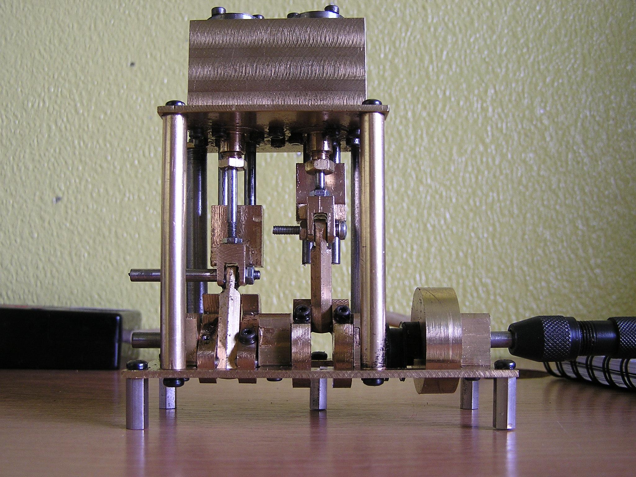

Yestarday I made the crank webs.
They are not easy, far from it.
I started 6,
1 parting off failure.
Got 5 completed.
Of the 5, 3 are perfic. 2 the Screw hole was off center.
All in all I think I have 4 usable, time will tell.
Assembled the crank and it turns quite freely in my origonal bearing blocks.
Maybe they will actually work so I Turned the Boss on those.

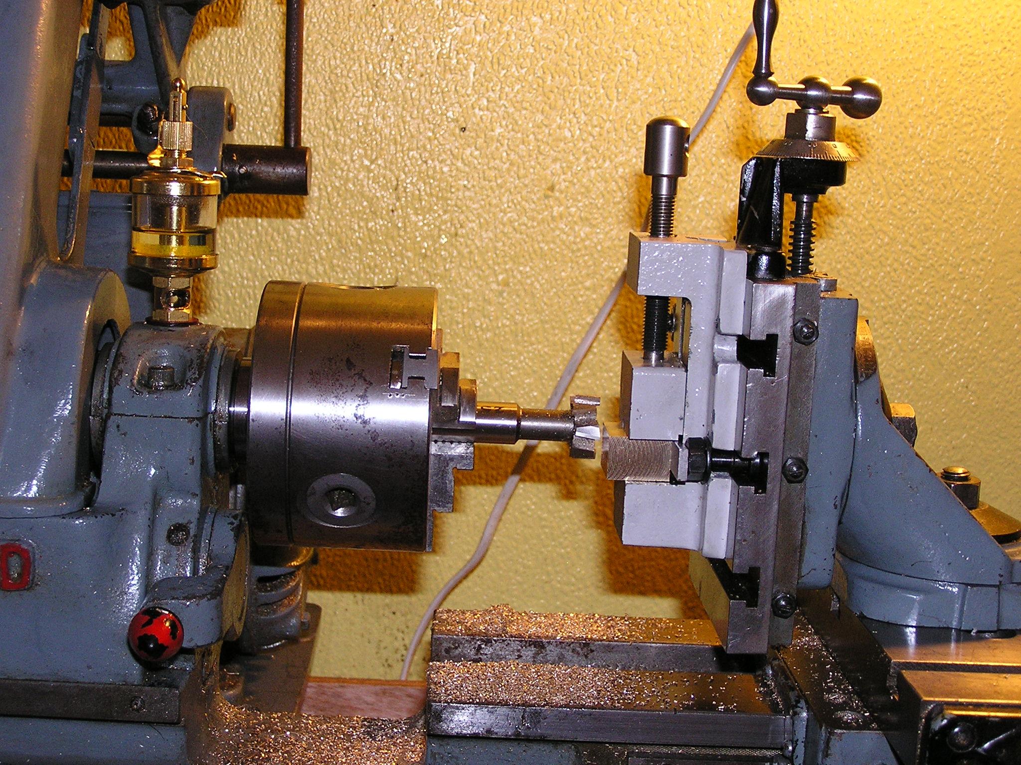

Today I made the pillars, the lengths are slightly wayward at the moment all to long.
I Bolted the crank and block together and the whole thing locked up solid.
A few washers and bits of shim and things are better on the crank but both Crossheads are very unhappy.
Lostened the Rods and made some improvements but they are still far from good enough.
Made the Con rods from 6.5mm (well a tad under) hex Brass, had real fun centering those to drill the holes.
I put a 6.5 mm drill in the Lathe chuck and raised the Milling vice until the jaws just touched.
Center drilled and then reamed to 4 mm.
Measuring 28.5 mm then became an issue.
I have a Metric Screw in the Cross feed.
14 1/4 turns /should/ give me 28.5 mm yes ?????

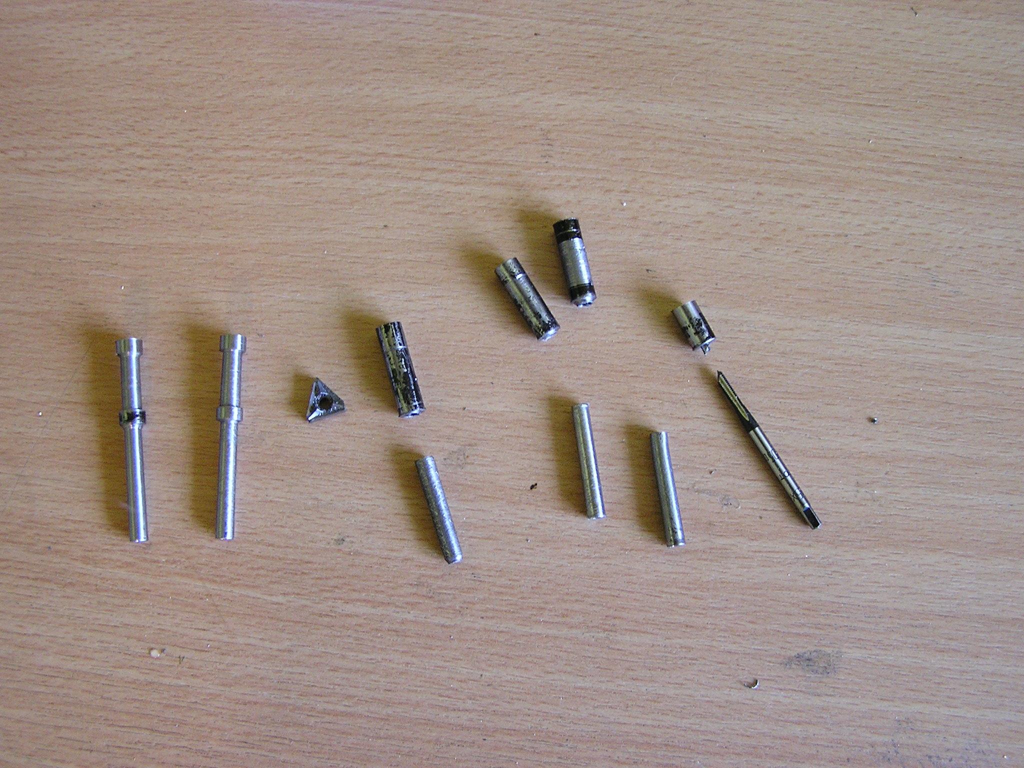

Hi.
At long last some pictures ......
The engine turns but there are issues with the Con Rods and Cross Heads.
I may need to remake the Top Plate. the Con Rods i can dress dowm a little.
Started this am on the Spool valves.
I think the pictures tell their own story :(
It's been costly. 2 Totally destroyed Tips. 1 partially desrtoyed.
1 Broken M2.5 tap.
I started with 300 mm of 6mm rod, 50 or so mm left.
It's taken me all day to get 2 Spool Valves.
Offline spuddevans

« Reply #24 on: May 17, 2012, 12:51:36 PM »
We all get days like that Alex, in my paddleduck build, in total I ended up making 4 spool valves (2 had far too much leakage in the bore of the valve)
I too had problems getting it to turn over smoothly, the best advice I can give you is to just take your time and work methodically through where it is sticking. On mine it was only slightly binding up, but it was binding up in quite a few places and so all that "slight binding up" added up :Doh:
I ended up slimming the con-rods down using a bit of emery held on my surface plate, that along with fiddling with the crosshead bars after enlarging their mounting holes in the top plate, got me to the point where there was much less resistance. Then I left the fiddling until I had it ready to run on air and did any last fine-tuning while running it in.
Stick at it, it's coming together nicely. We're starting to see an engine appear  :thumbup: :thumbup:
Tim

Alex,
there's something going definitely wrong with them inserts, aint the one to tell You exactly what it is, but You're breaking more than I do.
some points to check:
- eventual play in the spindle, slides, carriage.
- inserts 'target' material: i.e. inserts purposely made to cut aluminium won't last long on a steel workpiece, those made for c.i. won't do a good job either.
- tool edge height: might be slightly below the wp. axis but never above.
- tool holder: some inserts are made to be used on flat toolholders, others require to be used on toolholders with negative rake.
- speed & feed: they're designed to increase production in shops, hence to be used at higher speeds than HSS.
- intermittent cuts should be avoided, unless comparatively light.
- depth of cut: no less than the point radius, otherwise they will intermittently 'refuse' to cut the wp. and then cut too deep, mangling the finish.
- tool holder quality & material: the lesser, the lesser overhang from the turret.
- coolant: constant; either flood, mist or none. An occasional squirt from the bottle does no good.
Marcello
Offline mzt
  • Posts: 88
  • Country: it
« Reply #26 on: May 18, 2012, 05:48:19 AM »
that material 'silver steel' maybe fairly hard.
Try cutting the reduced diameter of the shank in steps: i.e.
say, a 6mm rod to be reduced to 3 for a lenght of 20.
Chuck in a 10/12mm rod for the required lenght (unless You can use collets).
reduce to 3.01 for 5mm.
next 5
next 5
next 5
same as above for the 6mm portion.
file to size.
part off.
Marcello

I'm definately getting better at this machining lark.
I decided to do the Valve Blocks in a 4 jaw.
It's paid dividends BIG time.
I centered the bar in the 4 jaw. Faced off an end and drilled it 1/8 for 35 mm the 5.5 for 36 mm
I have some slow spiral negative rake drills and they really do cut brass like butter.
Both holes were slightly out so I machined the 1st side to suite the Hole.
Turned it over and machined it to size - 18mm
The hole is now centeral. Did the 2nd using the same method.
Then hogged them both down equally to 16.5 mm. Measured the hole and pulled the hole central again.
Both blocks are within .05 mm, square, and the hole is within .02mm
I'll start drilling tomorrow......
Alex.
Offline ParCan
  • Posts: 154
« Reply #32 on: May 23, 2012, 01:41:25 PM »
Oh Bother said Pooh ( or something to that effect )
And I was doing so well.....
Offline mzt
  • Posts: 88
  • Country: it
« Reply #33 on: May 24, 2012, 02:24:32 AM »
What's wrong with them?
Marcello
Offline ParCan
  • Posts: 154
« Reply #34 on: May 24, 2012, 06:24:23 AM »
The 1 on the Right is drilled at the wrong end :(
Offline mzt
  • Posts: 88
  • Country: it
« Reply #35 on: May 24, 2012, 07:12:07 AM »
Now You tell me what and where, I can see it. Thank You.
Now what?
"Parts for future projects"  box and start over with a new piece, or some press fitting plugs into them holes & redrill ?  (admitting it would be possible)
Marcello

Offline ParCan
  • Posts: 154
« Reply #38 on: June 04, 2012, 02:12:49 PM »
A good few hoiurs in the workshop later...
Steam Valves are complete and work. Just need to attach the Packing glands.
Remade another spool (that's the 7th started so I'm quite good at those now)
Made the M2.5 Studs from a welding rod.
Made the steam valve end plates.
The Piston block is now assembled and complete.
Made the eccentric straps (rather badly I have to say)  I'll have another go at those.
Remade the eccentrics in Ally - Nylon was just not going to work.......
Stripped the crank and put the oil holes in the bearing blocks.
Also did the cutout for the eccentric on the Base Plate.
I noticed some play in the chuck whilst cutting up my sash weight so ended up stripping down the Lathe Headstock.
The bearings are in very good condition all things considered. (It's an ML7 made in 1954)
A Bit of blue greasy gunk showed the top shell was lose but the bottom was sitting really nicely.
I re shimmed the blocks until there was a tiny bit of friction then added a fag paper.
There is no play and the spindle runs freely.
I'd also note that Oil Consuption has dropped dramatically :).
I may get some more time to play tomorrow.
Alex.

Offline ParCan
  • Posts: 154
« Reply #40 on: June 05, 2012, 01:12:06 PM »
Got the Con rods remade today.
Put a small (0.25mm) boss on the Big end to help keep it all free and not rub on the crank webs.
The whole thing has been stripped, cleaned and lubed before Building it right up.
It all turns, but i'll leave that there. There are tight bits all over the place.
Pistons drop under their own weight. They are spot on.
Crossheads slide on their own, until you start linking them together with the Pistons and / or crank.
Crank on it's own is not bad, 1 Bearing Block is a tiny bit to far out but I really should remake those anyway as they are upside down.
I think I have a hole or 2 off square in the Crank Webs.
Crosshead rods are (were) ~ 1mm out. Holes filed to make them work. I really should remake the Top Plate.
All In all I'm not unhappy with what I have made and have had hours of fun already.
The reality is coming to me that this engine may or may not actually work !
There are simply to many errors duing my learning process.
My plan is to complete this engine and see if I can make it go, then use the experience I have gained to build a second.
I also intend to invest in a Mill.
The Milling slide on the Myford works but everything takes forever to setup and machine.
I's also suseptable to moving if you try and take anything more than a 1mm deep cut.
Tighten it up more and it distorts the Cross slide.

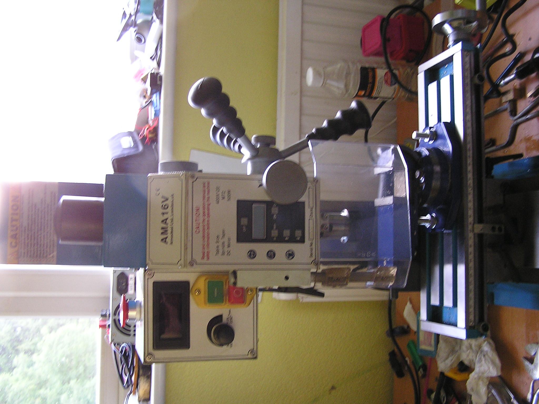

I jumped on the Bike and Nipped in to East London today to look at the mil; offerings from http://www.amadeal.co.uk.
The guy I spoke to was helpfull but is not an engineer in any way shape or form.
They as a company are in it to buy, sell, trade and do business. They trade in SEIG machines direct from China.
All in all they have a reasonable premisis with a reasonable amount of stock kicking around.
Looking at their XJ12-300, it's little more than a drill.
The AMA16 is small, compact and looks much sturdier.
The AMA25 is a lot more money but I think for anyone serious, not a bad (at the small end of the market) machine.
The AMA25 is to large for my workshop, so I bought an AMA16LV with a Vice and Collett set.
After a bit of haggling a deal was struck and it should turn up here on Tuesday.
We shall see how good the machine actually is.
Alex.

And then more goodies arrived:
Fire cement, a Crucible and some Tongs for my Furnace to re melt my Srap Bass and turnings. (Dont tell my fair lady I plan to use here waste paper basket and a Flower Pot from the Garden)
Then a Really heavy wooden crate turned up. The Driver says "Got a Trolly or forklift ?"
We dragged it out of the van and dropped it on my front lawn before I pondered how I get it inside and up 2 flights of stairs.
Deciding to remove excess weight (the wooden crate) first a jemmy was fetched.
I now have some sheets of Ply wood AND some nails :0
The inside of the crate revealed it's wonders after about 5 mins, a small balck plastic box, 1 small wooden box and a cardboard box, oh and a lil AMA16LV Mill.
Attempting to move the de crated mill was again never going to happen on my own so i set about separating the Head from the Column and base.
A Bolt and a Nut later I carried the head in and placed it on my workbench.
Thinking the rest would now be easy was a mistake. I then had to separate the Column from the base.
the Tool box contained chocolate:
Alan keys.....
They were dropped swiftly in the "Small bits of steel" Box and decent alen keys made easy work of the 4 bolts.
The base was still bloody heavy I have to say.
As usual a complete strip and clean was required as it had a film of brown gunk on it.
A Litre of white spirit and some paper roll later I reassembled everything.
Also pulled all 3 screws apart to put propper lube on them and the thrust bearings.
Movement needs to bed in a bit, It's well lubed with some propper slideway oil.
There is a lil bit of Lash for me to try and iron out, nothing major.
The MT2 Collett set looks very reasonable.
The Tilt Swivel machine vice is, well, really nasty.
It's gona be a nightmare to square up and is far from "precision"
I'll see how it works when I get some metal in to it.

Looks like Your mill requires a three handed operator to change tools (as mine does): two hands on the wrenches, and a third one to prevent the tool from falling. (They do. Either they damage the workpiece or loose they cutting teeth. One sad end does not exclude the other. 1mm mills snap.)
My 'solution' came with the habit of lowering the head to about 1" from whatever surface and interposing a small foam cushion (a loose did for a long while) before opening the collet. When the tool falls, I get it with one hand and raise the head with the other.  The spindle lock pin is probably the only feature I miss from the mini, since I upgraded it.
A short piece of string going from the plastic spindle cover to the motor cover will prevent shop gremlins from stealing that cap, if not the wrenches.
Marcello

TY mzetati for your tips.
I did wonder about the Cap - I'm sure it'll have the ability to hide in every possible nook it can find.
Tool changing on most small vertical mills is going to be hazerdous at best (either for the tool or work).
Some foamy tape stuff will be placed on the back of the Vice I think.
My first job will be making heaters for my 3D printer nozzles. That should give it something reasonable to munch on.
Good news is that my 24mm face cutter fits in the Colletts.
Cost me a £ at a car boot.
Alex
