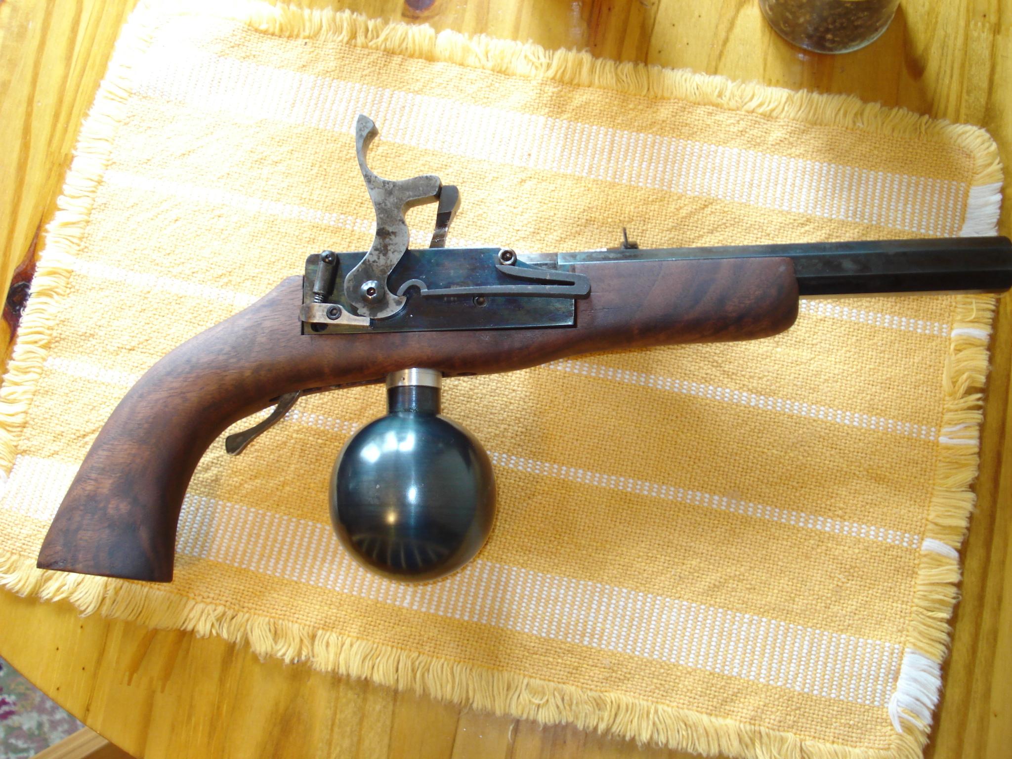

A bit  :offtopic: but  whats those gun looking thinks top of shot  :scratch: they look interesting  :D
Cheers Rob
Offline 45auto
  • Posts: 8
Re: Making your own carbide tool holders
« Reply #9 on: February 12, 2012, 07:32:46 AM »
Thanks,
  Those are  outside lock ball reservoir pistols I made.. They use Co2, and are large bore, 30 cal and a 45
Not quite finished, they need sights and finish on the wood.........
Mike

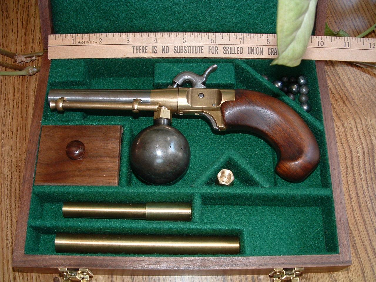

So Mike,
Are you going to show us  :drool: :drool: :drool:  - we like pics   :poke:
DaveH
Offline 45auto
  • Posts: 8
« Reply #11 on: February 12, 2012, 08:33:46 AM »

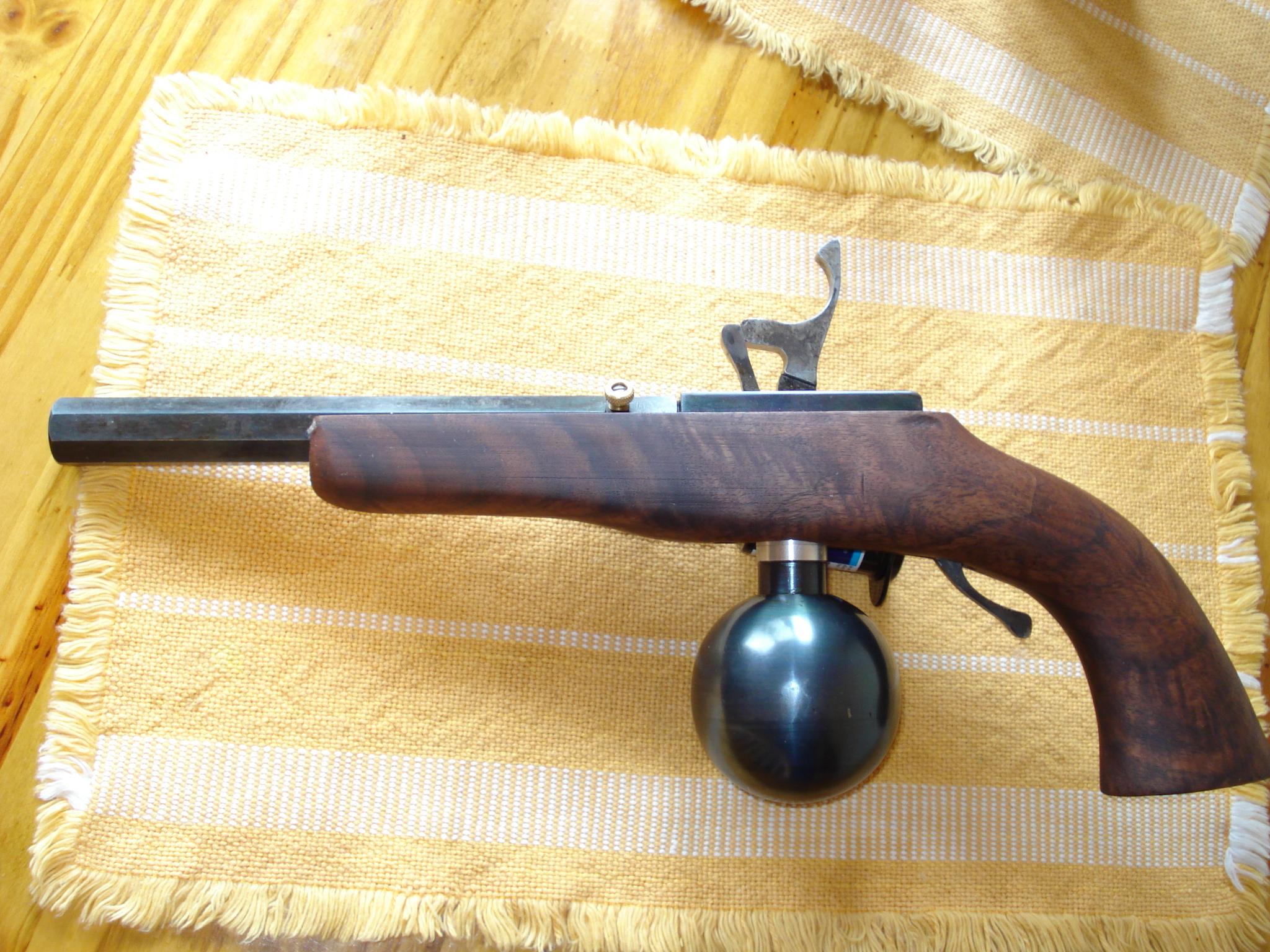

Not sure if this is the right place to post this, but here is a couple of them..
  It's a 30 cal tap loader, ball reservoir CO2 pistol.  Made 2, other is a 45 in a different stock, a more traditional muzzle loader type. I  make a few a year, trying  for a different style each time..I make them to please myself, occasionally selling them..
 Sorry for the large photos, not sure how to cut them down..
Mike

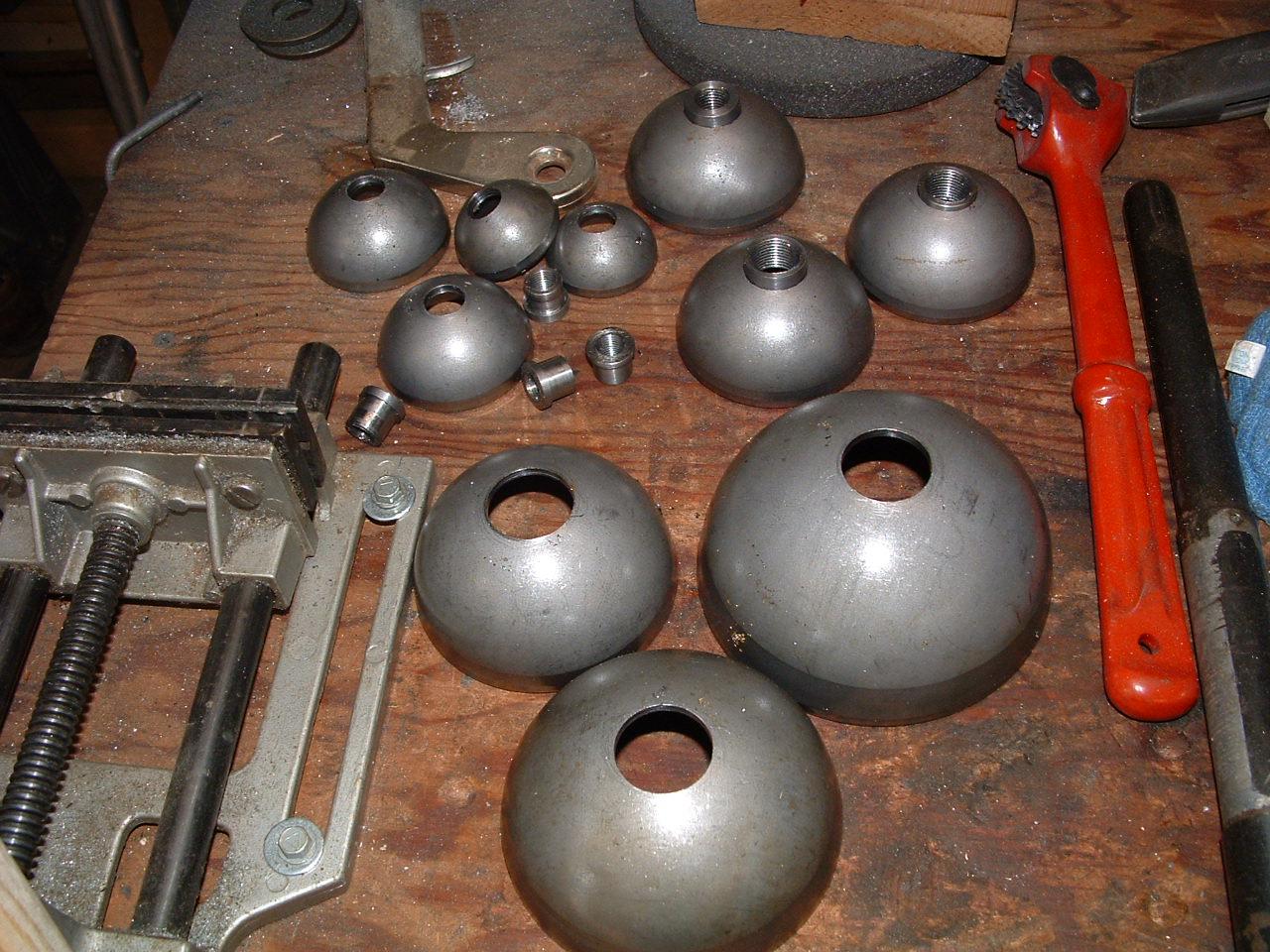

If you made those spherical CO2 reservoirs yourself, how on earth did you manage it?
Offline 45auto
  • Posts: 8
« Reply #17 on: February 12, 2012, 07:27:55 PM »
I was able to find hemispheres with a .135 wall, I  made a threaded insert, heliarced them together  and tested them to 4500psi.. kinda time consuming, but worth the effort
