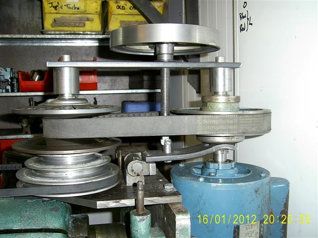

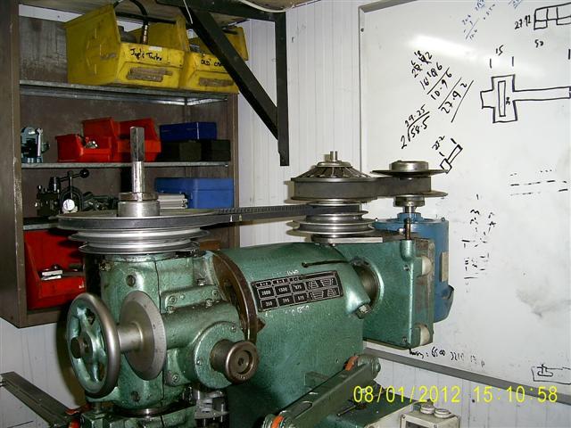

Been working on this all day yesterday. I had the pulleys and belt with this in mind but never got round to it. After my motor blew I decided to get it under way. Hopefully, I'll have it working today.
Photo is with the belt covers removed, I have to modify those to allow for the extra pulleys.  What I've done is removed the step-pulleys and mounted them onto the bottom of the variable-speed pulley which itself is on a bearing shaft I have mounted on an extension plate bolted to the motor mount. The variable pulley distance is fixed but the whole assembly movs in and out on the original belt tensioning system to allow for the step-pulley belt to be adjusted.
All that's left to do is fit up a control system for the cone pulleys.

My pulleys would only really fit well if the drive pulley (originally the one with the centrifugal weights) was fitted to the motor, and the originally sprung pulley on the intermediate shaft.
I couldn't see a way to control the spacings of the motor pulley  - I looked at various lever mechanisms.  So instead, I swapped the spring onto the motor pulley and used a pull rod, down inside the centre of the intermediate shaft, to control the  spacing of the driven sheaves.
BTW Since the website pictures were taken, I have increased the tension of the spring and fixed the motor adjusting plate rigidly, to reduce vibration (you may find those rubber motor mount will also cause vibration/ resonance).  The six screws that hold the extended motor shaft allow me to dial it in,  to run as true as possible on my worn motor shaft. The nut on the extended shaft is a LHT to stop it undoing under load.

Got it working now. I used an old cast iron flywheel I had kicking around for a speed adjuster. I can now get infinately variable speeds from 220-2550rpm.
Got to cut the guard about to accomodate the new variable drive then get it fitted up so I don't get caught up in the doings:

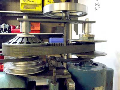

Thanks Bill. On the top step pulley I get 220-1300rpm at the spindle, on the bottom (fastest) pulley I get 400-2550 spindle RPM. Middle is somewhere in between. It'd probably go a bit faster when it's warmed up fully.  Swapping the belt is a very quick job on this mill because it has a nifty tensioner that jacks the motor back. I deliberately suspended all of the variable speed drive off the motor mount plate so I could still use that. Takes just a minute to adjust the belt.
Nice job pete but me being a thicky  :loco:, I don`t know how that speed adjuster works!! Can you explain?
Chris it works by using cone shaped pulleys and a wide belt. The pulley on the right is adjusted by turning the handwheel on top, which pulls the lever at the bottom upwards closing the pulley and making the belt move to the outside. The pulley on the left is sprung-loaded and adjusts itself according to how you set the right one. You can see the diaphragm spring in both positions in the pics. The adjuster screw is actually a chopped up G-clamp from Wickes :)

Rob the cone pulleys are simplabelt pulleys, these ones came off a Denford viceroy lather, Either a 280VS or 280 Synchro. They are also fitted to some wadkin stuff. Easier to find would be the pulleys Bill uses on his mill which is the cariable speed drive off a scooter. There are millions of those on the road right now.
