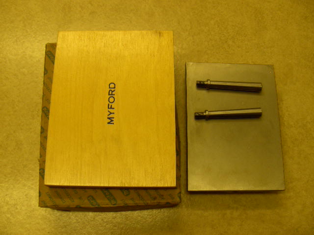

Re: Surface plate alternatives
« Reply #9 on: January 03, 2012, 04:32:30 PM »
OK Ross ... here is a pic.
Needs a lick over with Scotchbrite, got a bit of gunge on it.
Greasy stuff.
BC

« Reply #15 on: January 08, 2012, 10:23:30 AM »
Greasy stuff.
BC
The plate looks perfect  :thumbup:
Thanks to David for posting the scriber block too!
