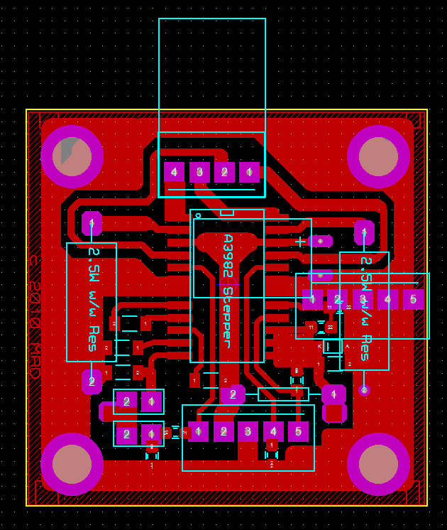

Hi Craynerd
I've built stepper drivers using an Allegro A3982 (about £4 from RS). Its 35V 2A max bipolar driver with thermal shutdown and current limits. I have a single sided board layout if your interested (pm me for a hi res copy). I would think total cost <£10 (which is likely cheaper than anything else). Snag is you have to make the pcb and load it with various components. My experience with this chip is that its reliability under conditions of extreme abuse (unintended) is remarkable.
Best Regards
