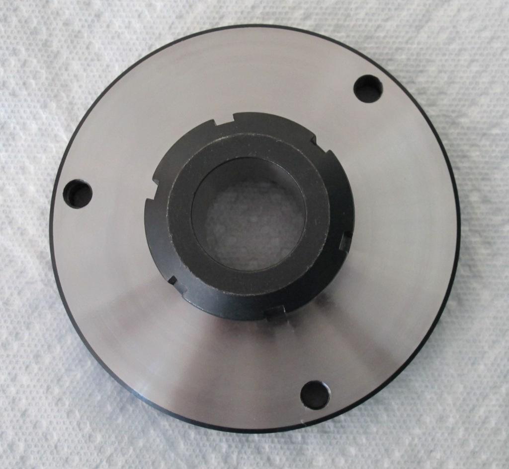

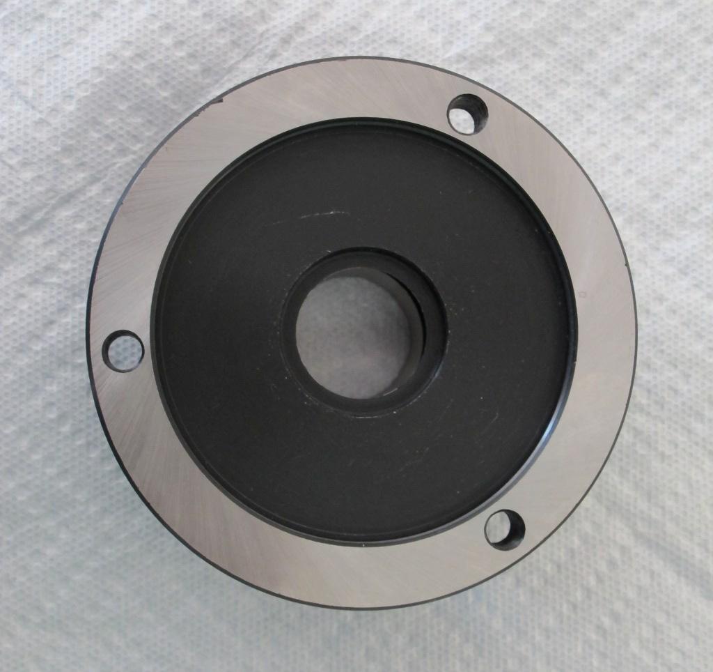

Using a DCMT11T3 carbide tip on a right hand turning tool. I get like a fine groove or more like extremly fine thread.
I have tried different materials cast iron rod and aluminium rod - and the result is the same.
These two items are photographed with a macro, and the larger one is about 15mm in diameter and maybe around 20mm in height.
The thread is extremly small you can feel it and see it but not enough that a nail would catch onto the groove.
I guess this must be something wrong with my setup, speed / feed / angle of tool?!
Tried to find some answers by googling this and searching but cannot find out what would make this result.

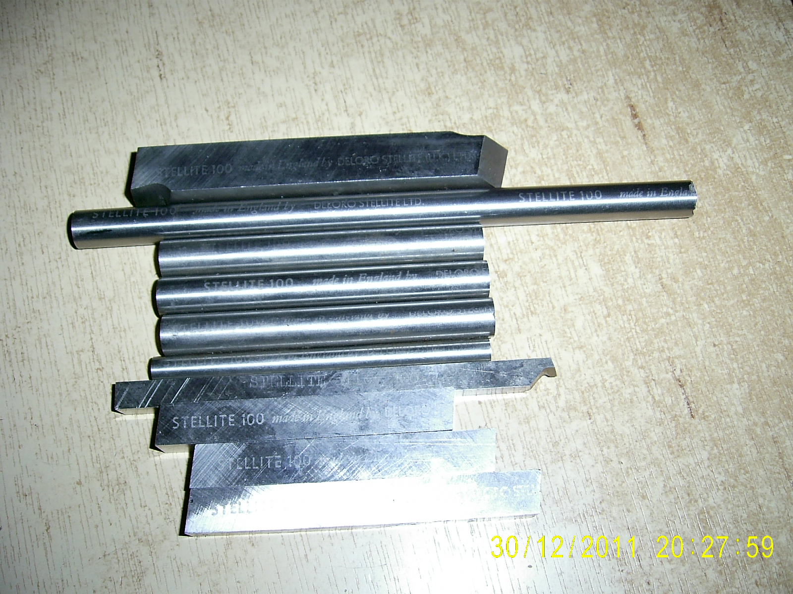

I cut steel and ally at lower speeds using carbide tooling sometimes, but I prefer to use HSS mostly. Grind a couple of bits up and pay close attention to the cutting edge. When I first started grinding HSS I would get the shape right but often found that I neglected the very tip that was doing the cutting, and ended-up with negative rake or a rounded tip or something. Now I finish them off with a stone or EZ-lap diamond hone and the difference is astounding.
I was right pleased to find 10 pieces of Stellite 100 last week and only £4 a pop. If you can get hold of this stuff - grab it with both hands.
Stellite is certainly remarkable stuff and will cut at red hot temperatures.
