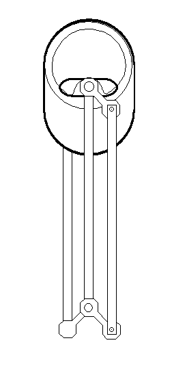

I've not bin Idle these last couple of weeks I've bin doing a bit of research on an engine that caught my eye. Its a bit of a strange beast it has a rotary action that I can best describe as a captive eccentric. The original was first displayed at the great exhibition and was shown powering some textile machinery, as far as I can find out only two were made, though there is very little documentary evidence for the second.
I've got enough of the drawing done to show you an assembly, but I still need to do more detailing of the parts, but its enough to give you an idea of how it will look.
I'll slowly work on the drawing and start to get material together ready to make a start and cut metal in the new year.

Ok Guys big red face time I dropped a bollock with the drawing
 :doh:  :Doh::doh: :Doh: :doh:  :Doh::doh: :Doh: :doh:
I've made the cylinder too long, it should be the 30 + 15 plus 1.5 = 46.5
I drew it as 30 + 30 it was only after I had drilled it that I started to think that looks too wide better check it out,  :doh: :Doh:
Just measured things up and all is not lost I can still fit the correct width of cylinder in, but I need to chase the change through the drawings as it will impact on the con rods, cylinder covers and the valve chest.
So it's back to the drawing board.

Things have bin a bit slow on this over the last week, what with having to redraw some of the parts, and other things getting in the way:- plus I went down with the dreaded puckes.
All fit now and bits redrawn.
First job was to put the bollock right.
