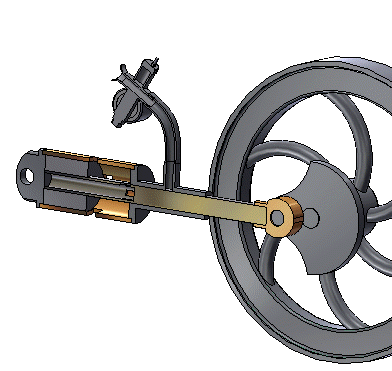

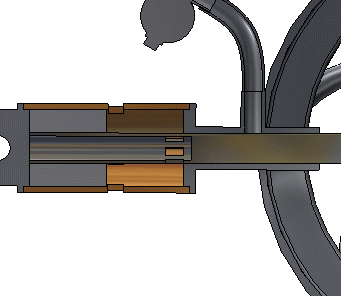

This is what I had in mind:
« Last Edit: December 12, 2011, 10:46:06 AM by BillTodd »

Yep, thats the general idea Bill......
