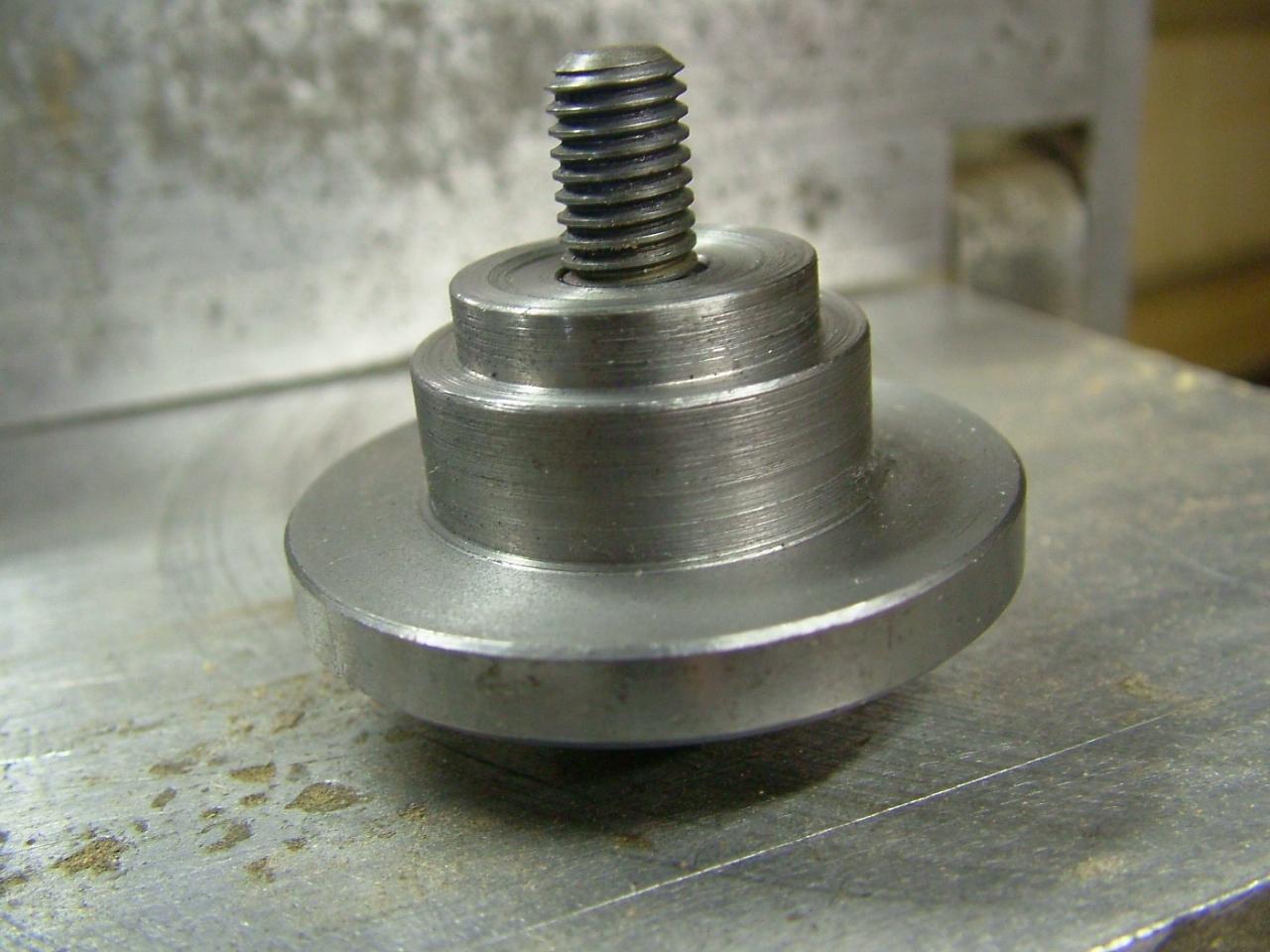

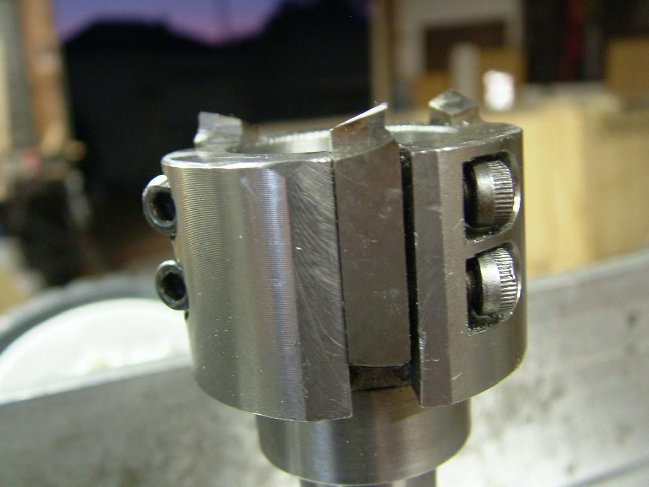

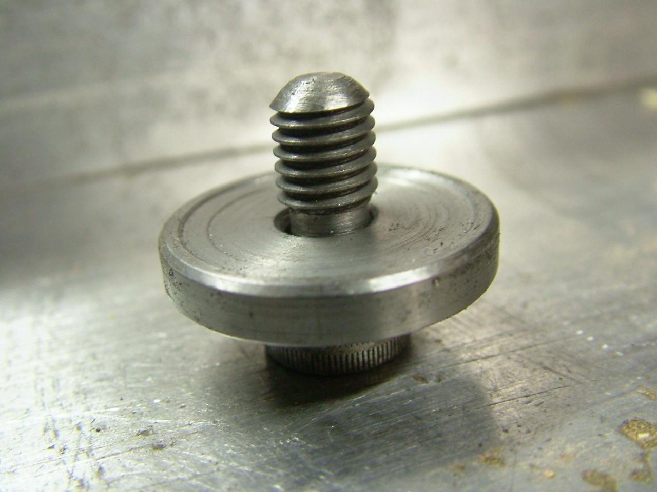

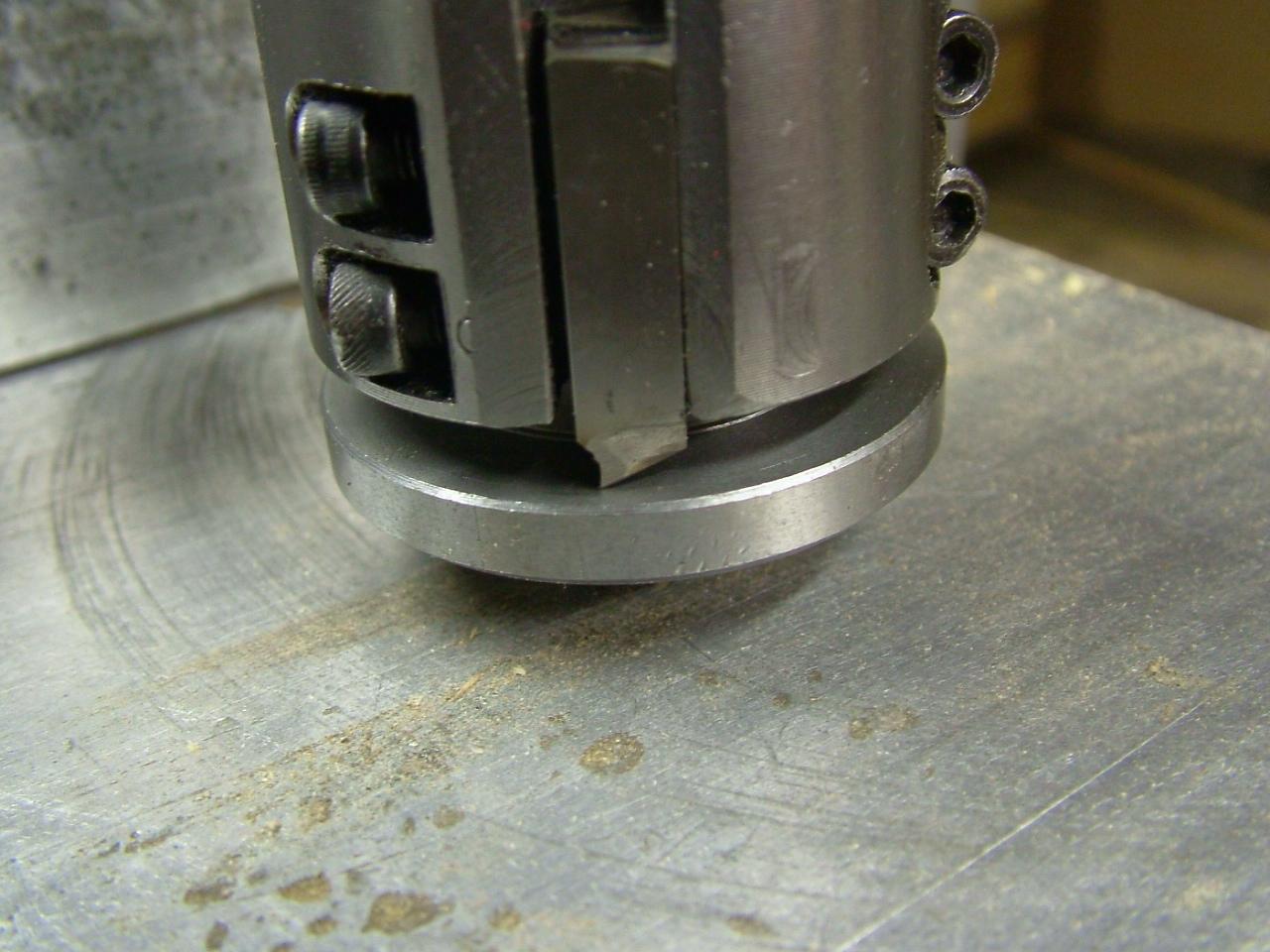

Hi this is my solution to setting up a facing cutter for an X2 mill
Turn a stepped disk to bolt on to the cutter head. (You will need to measure your cutter head to suit fit)
Remove locking bolt and bolt stepped disk to cutter head
Set cutting tips to touch stepped disk remove disk and replace locking bolt
See Pictures

Great idea Eric!  :clap:
The only drawback I see, with clamping against a fixed stop..... Carbide cutting edges spelch very easily, when pushed against an "immovable object".  :bang:
Re: Face mill tip alignment
« Reply #13 on: January 25, 2012, 04:13:09 AM »
Nice idea Eric, Thanks for sharing :clap:
