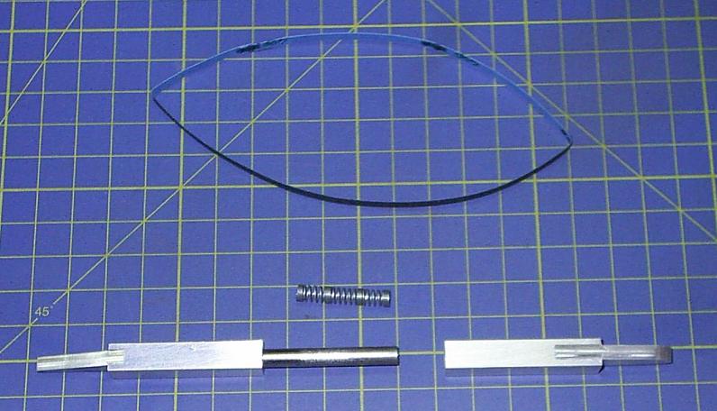

« Reply #9 on: November 29, 2011, 01:34:52 PM »
Two pics of my pen sander. Just a piece of aluminum (square 8x8 mm), a bit of stainless steel (round, 5 mm dia) and a spring from the scrap bin.
Belts was made from sandpaper sheets, 4 mm width, glued with epoxy.
IMHO, this is one of the best tools for deburring and polishing small parts.
Roberto

« Reply #10 on: November 29, 2011, 01:42:46 PM »

Hi Roberto   ,,,,,,,,, thanks for showing your pen sander  :clap: :clap: :clap: :clap:
Another tool to add to my must make list  :proj:
