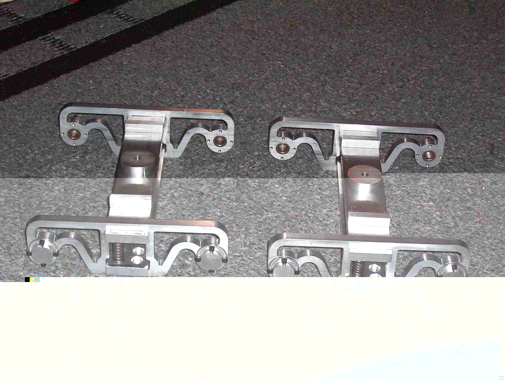

Hi All,
Here's my recent shop handy work. A set of Wheel Trucks for use on a 7.5" gauge riding car. Not sure if the car will be a gondola or a flat car but I guess I will decide once I get the wheels and axles turned up on the lathe. The trucks themselves are machined from 1/2" 6061-T6 bar stock. The springs are pocketed into place and were cut from stock and ground flat( not all installed as they are a pain in my fingers to keep putting in and taking out as I work on adding pieces), there are 4 each side and will allow reasonable springiness under a variety of loads from 200~400lbs
 Eventually I plan to build a steam locomotive to pull it but I thought an easy project was in order to get started.............I like easy!
Questions welcome.
Gerald

Nice work on those trucks Gerald.
Let me guess, you CNCed those frames?
I'm into 1 1/2" live steam also. I've got castings to build a 1 1/2" scale Shay.
Here's a link you may find interesting: http://www.nelsonslocomotive.com/
Regards,
bernd

CNC OH NO Bernd................I milled those by hand ;-)  yeah right I wish I had that kinda patience and that kinda talent.

Nice looking trucks, at 7 1/2" there should be plenty of space to work round, I'll be interested to see how you fix the bracking system. Just spent the day at my club track helping to service and maintain the clubs 5" gauge rolling stock, they're a bit fiddly to work round, nuts and bolts in alsorts of hard to get to places.  :borg:

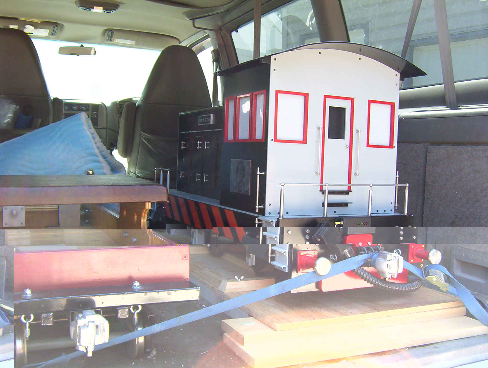

Well I finally got a small locomotive so maybe I'll get back on this project and build a car over my econo trucks. I haven't been here in ages and I really don't know where the time goes! Actually found my posts on a GOOGLE search for something else Geez!
Anyway now that I have a loco I can start running at the local club track!

Any chance of you posting some more pics of the loco, it looks a neat machine.

Thanks for the interest Stew,
I hope to get the engine at the track soon and will take some pics and possibly video when I run it. Been really rainy weather for some time and nice weather never seems to correspond with free time for the track
In the meantime heres a shot of it under construction before the cab work was complete.
cheers
