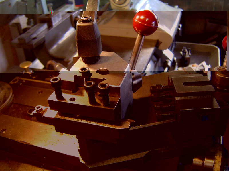

I made this Hardinge style one for my HLV_H. Inspired by this design on the HMEM site:
http://www.homemodelenginemachinist.com/index.php?topic=5153.0
