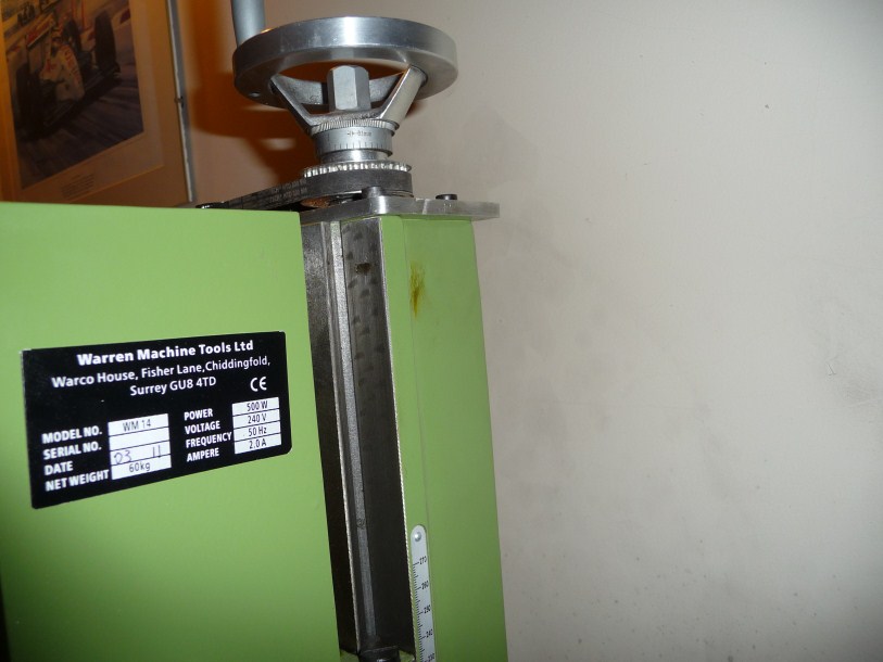

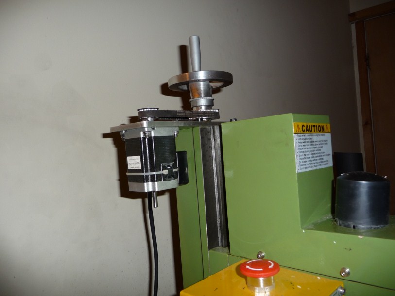

I have problems getting my arm up high enough to turn the handle on the z way on my new mill , so I decided to fit a stepper motor,It  has been done so that it can still be  opperated manualy  it is just a 6 mm plate with a ballrace and the one of the original thrust bearing plus a smaller one to replace one of the original the gear has the back machined out for the thrust plus a keyway cut, it all goes together , Simmples  :lol:  I am using my RT controller for now to test it but have the stepper and a unit to controle in ready to box up (hands have been a bit stiff) so when I fit the buttons on the head ill post again.

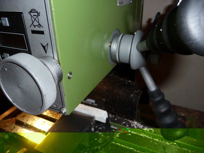

I do a lot of straightforward drilling, and one of the reasons I bought another Conquest was the Z axis, side handle.

this has a handle for drilling  as well, plus a fine feed on the quill.    I should be able to program it to drill to a set depth if needed, but the main reason is because I cannot reach the handle to move the head up and down, I am also putting a stepper on the bed as a power feed, but will still be able to use it manualy.

I understand your type of machine has only around 2" quill travel.
My drilling handle and fine feed move the head. Handy having full vertical travel, for hopping over r/t chuck jaws. between holes.
I don't have your problems. But, didn't fancy having to regularly stretch to the top of the machine for Z adjustment.....

It was simple to do I removed the top plate and made a new one in aly with a bearing(ballrace flanged) in the centre I did a 2 to 1 belt drive with T5 belts the motor came from http://www.arceurotrade.co.uk/Catalogue/Stepper-Motors/Stepper-Motors     the 180 n
the driver came off ebay http://www.ebay.co.uk/itm/Stepping-Motor-Speed-Regulator-Reversible-Direction-CW-CCW-Stepper-Pulse-/320879363082?pt=LH_DefaultDomain_0&hash=item4ab5e6840a they also do the drive board http://www.ebay.co.uk/itm/CNC-DC12-34V-3A-Single-Axis-Stepper-Motor-Drive-based-on-TB6560-for-4-6-8-lead-/320918218100?pt=LH_DefaultDomain_0&hash=item4ab8376574
then just use a old lap top power supply they are simple to connect up and even come with pre made wires back to the handle if you use a standard T5 belt drive from http://www.hpcgears.com/products/pulleys_belts.htm the gear is driled out to fit the z axis and a grove filed in for the key I then fitted a few grub screws to make shore it was tight .if you need any more specific help just ask I may have some pictures somewhere
