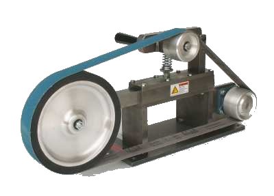

The reason I am asking is I am thinking of making one, along the lines of the KMG one.
So anyone have one, make or build their own?

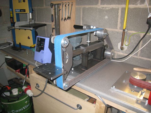

 I built one, 72x2 w/ 3hp 3ph motor and a VFD, made mine tall and not so deep as most, with the motor under the desk. Consequently the desk space occupied is only about 60mm x 500mm.
At full speed it's unreal.
At slow speed it's really useful too.
Never used a bench grinder since, it's a zillion times better - faster, more flexible, better finish, easier, faster, etc etc  :bugeye:

I built one from plans off the internet. I used a 1.5 kw motor and run it off a vfd Very happy with it

Dave I am computer challanged so I managed to lose all the stuff  I downloaded but its based on the kmg These plans are freely available on the internet .I machined the wheels out of aluminium for the grinder but bought the motor pulleys which are cast iron.I made a set up where it uses a plattern and I used a caster wheel I bought at mica for R50.00 It is made of nylon and I just put some bearings in and trued it up.I just crowned the one aluminium wheel (80mm) and am suprized how well it tracks. I would like to try and cast some polyurethane around the 8 inch wheel and I need to find a different material for the platten as it does show signs of wear. Mind you It has taken some time to wear though.I am not into knife making this is for general shop use . With a new belt I reckon it chews through steel as fast as I can mill it. But then I am not very good at milling

Here are the plans for a KMG clone. I made one some time ago. I have a 3HP 3phase motor with a VFD. It is a great machine.
http://www.dfoggknives.com/PDF/GrinderPlans.pdf
