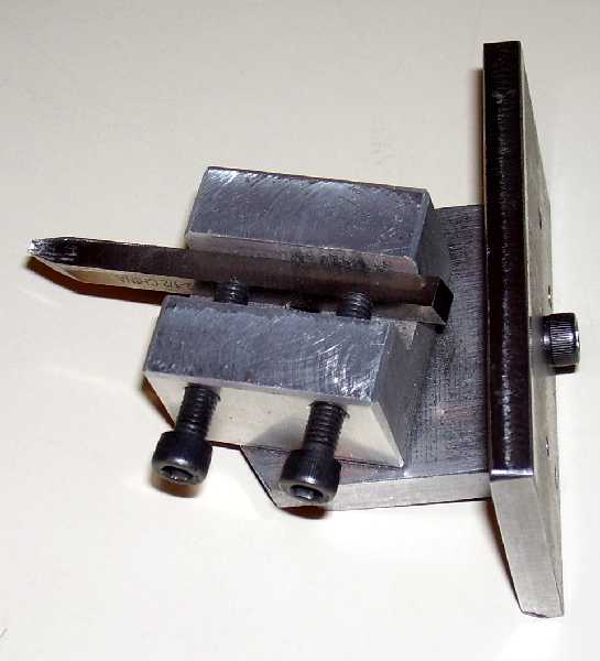

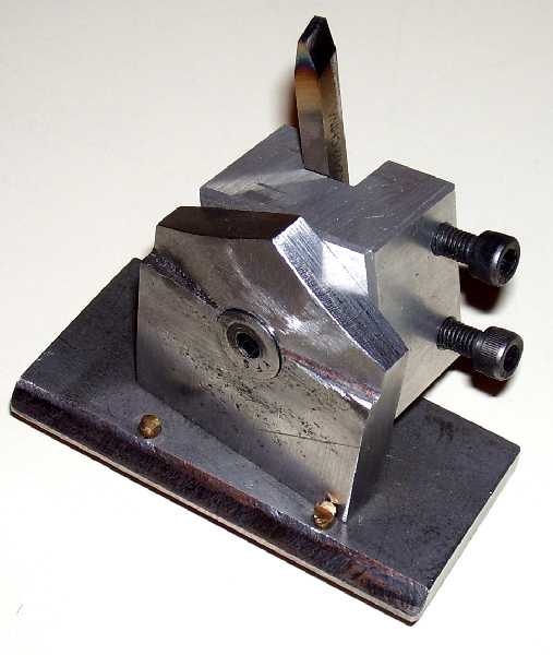

Thanks everyone for the suggestions. Once it became apparent that I would have to single point this project I dug up a grinding fixture that I made a couple of years ago for grinding tools for 60 degree threads. Once I added 14.5 degree lines it worked a treat. As seen in the picture it also has provision for grinding the relief needed.
