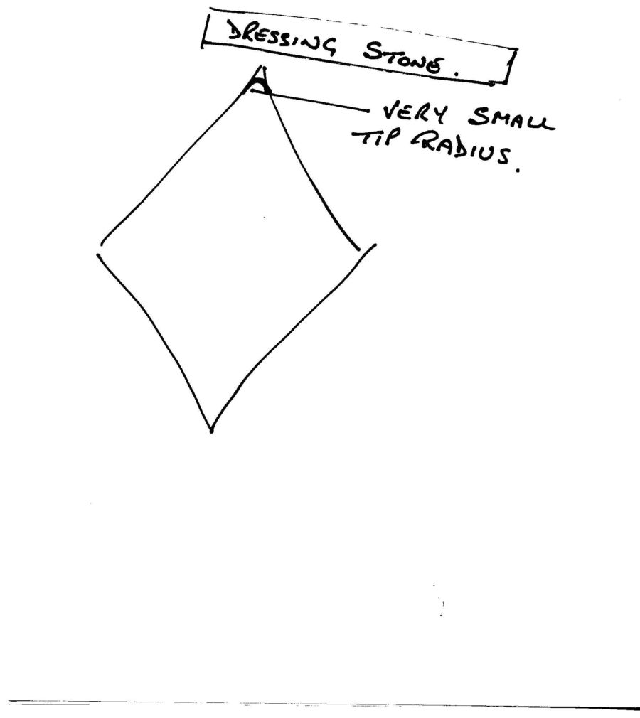

bogstandard
Re: A Tangential Toolholder for the Sherline
« Reply #22 on: January 16, 2009, 01:26:28 AM »
Bernd,
As with most HSS tooling, if you can get away with a very small tip radius, then a quick swipe across the nose with a stone works wonders. I use an Arkansas stone.
C-o-C attached

I sharpened the tool again and gave it a couple of swipes to put a small radius on the tip. Then I put a sharp pointy tool in the chuck and set the hieght. I also turned the tool holder clockwise a few degrees to give more side clearence. It's supposed to be set square with the cross slide. I then took a small cut on the piece of brass in the picture. I then took a heavier cut also and different speeds. Finish is much better. I think both the radius and the larger clearence did the trick.
The picture below shows the piece of brass I used for the test. It shows the holder turned counter clockwise from square to the corss slide for facing. As you can see the tool is set a couple of thou low. It left a small nib in the center.
So adding more clearence and a radius seemed to work. As you can see I have some clearence issues with the tool clamp. It'll get in the way when facing larger diameters.
