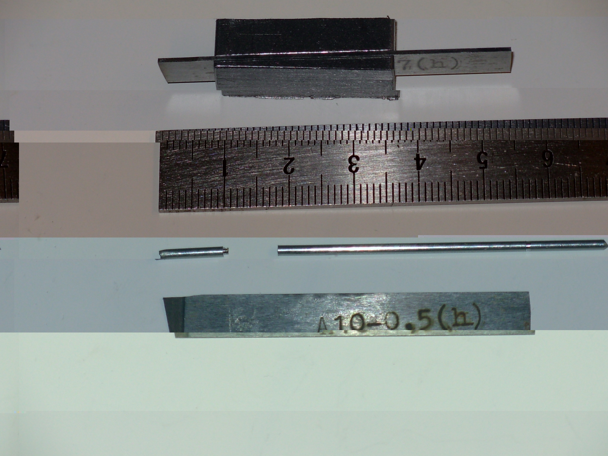

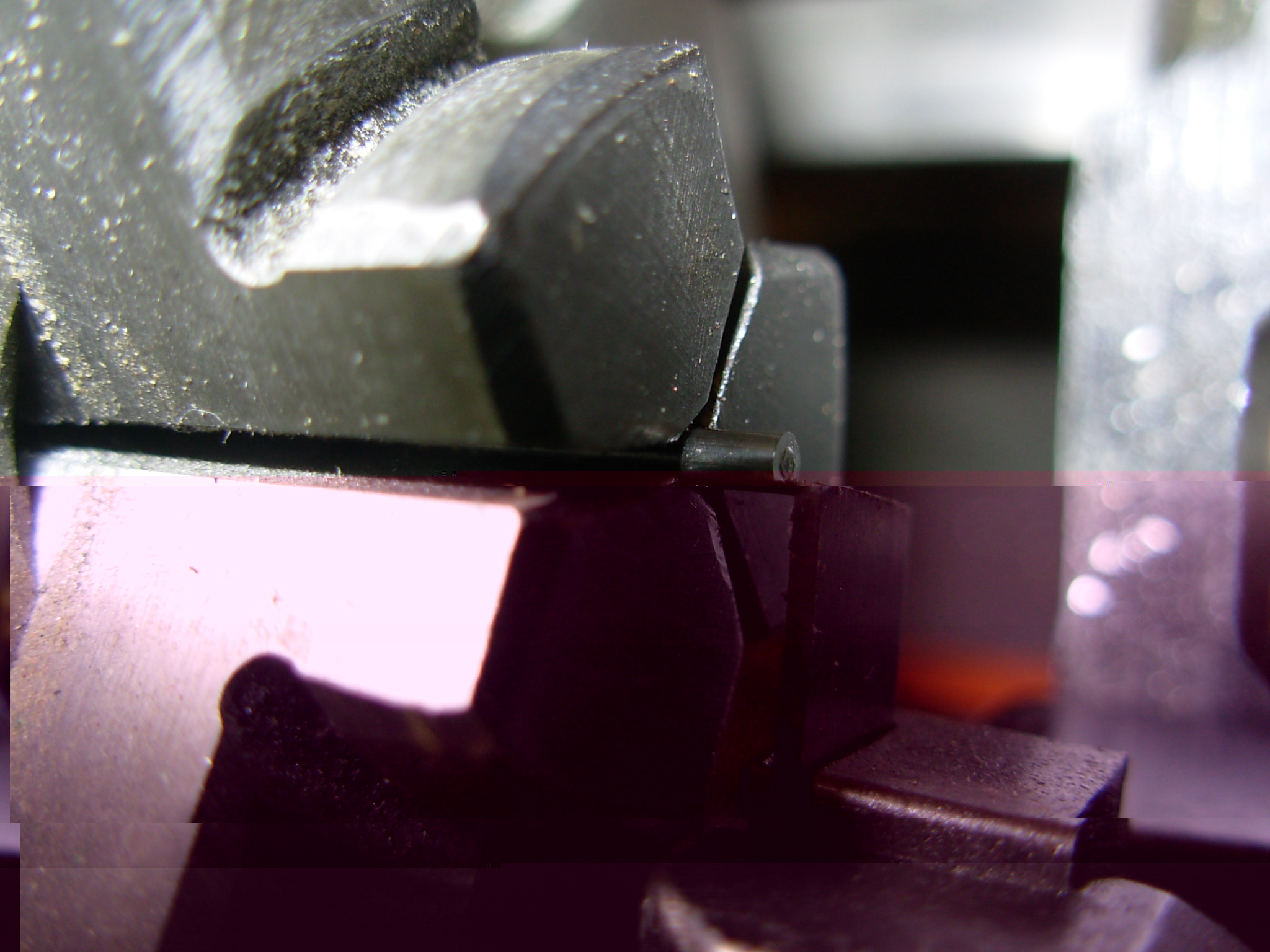

You are asking a lot and I haven't got that far. I wonder what clock makers would do?
However, I have cut under 2 mm rather routinely on different materials and that's easy. But it all works with part dimenssion. Harder to chuck, closer you need the adjust tool height (many times I'll notice that my centre pip is larger than work you are trying to part off) and you need to get really close to the chuck/collet or you need a steady. Here consideration starts to be: do you push the blade to the work or do you hold blade stationary and push rod to the work with a support. V-grove or something like this (without the blade):
http://www.chronos.ltd.uk/acatalog/Small-Diameter-Turning-Tool.html
 I intended to try out 0,75 mm but I don't have anything of silver steel kind of material. After thinking over I'm not that confident that lathe is way to go.
I had some 1.56 mm dia tig welding rod, I believe it's stainless because that what is used at the work! It's surpricingly britle, but materials feel different on smaller dimenssions. It flatens a little if I use piano wire cutters to it. I admitt that is whole different ballgame to do half that diameter. I had to resort loupe to adjust parting off blade to correct height. And that is critical here. I cut clean on the first try - unfortunaterly the pin sheared at the chuck!
After getting centre height closer, It cut without drama. No pip on chuck side, huge one on severed part.
I used a MT1 arbor to catch parted off pin.
I used 0,7 mm wide blade, not the sharpest one and this lathe is really light weight piece of paper weight. On last picture there is 0.5 mm wide blade. There is no way that lot wider than that blade will do nice work.
PM me if you want to have a go. I'll send you two blades to toy with, if you break them, you'll sharpen them and feel the pain. I don't have a foggies idea where to buy them.
Camfering this small parts was long time a go a quick visit on corrosive material and then long ride on ....what is this rotating canister with abrassive and filler inside? Found it: Tumbler!
I hope you'll find better method.
You need some clearance with the glue, deformed end on that side is probably just good. There are very many different types of stud locks (glues). Look something for a small clearance and low viscosity.

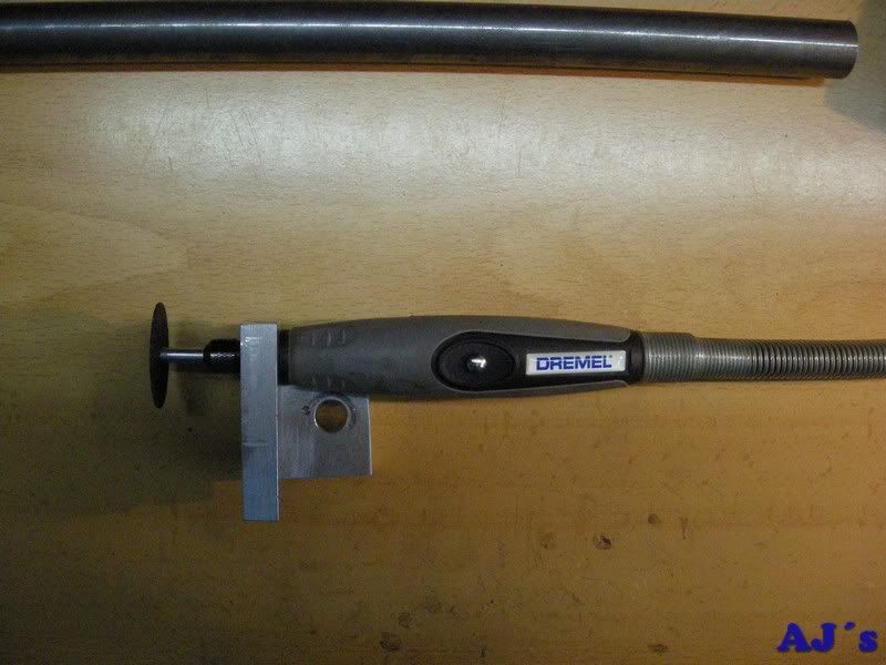

« Reply #17 on: June 08, 2011, 06:31:20 PM »
Just a sugestion. Make something simmilar to what I have done and it might be possible to cut them while held in the lathe (Toolpost chop saw). You could also add a stop to the support to control the lenth.  I would also sugest some tempory shielding to catch the pieces as they come off and DEFENETIFLY personal safety gear, ask how I know....
Might even be used with a small grindwheel to do the chamfers.
P.S. Have only used it on brass and piano wire for my modeltruck axles.
