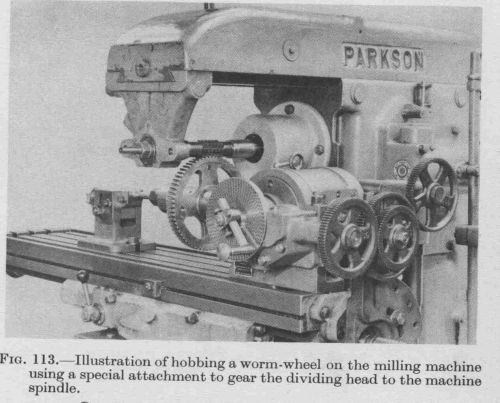

I am refering to gear hobs.
http://www.arceurotrade.co.uk/Catalogue/Cutting-Tools/Gear-Hobs
I have used normal gear cutters, in sets, and home made flycutting gear cutters, where each tooth is cut individually, but have never really delved into this area.
As much as I know is that one hob does the job of a whole set of normal cutters, but how are they used?
I know I could do a 'google' on the subject, but you usually get the full technical jargon, what I need to know is what the hands on experiences are, easy or hard, good or bad.
It looks like it could be a much cheaper (at least 50% saving) and faster way of being able to cut gears than the full sets syndrome, and if it looks a feasible proposition, I will invest in the full setup.
Bogs

Ok Bogs I'm going to let the cat out of the bag so to speak. I'll try to make this short. I worked for a company here in the US that made gear cutting machines, they have a subsidiary in the UK. Google Gleason Works. In 1980 they starting building hobbing machines for the front wheel drive craze that took over the auto market. Let me just say I started out as an apprentice operating machines in the machine shop, worked on the assembly floor were they were built and run for the first time. So I know a bit about hobbing gears.
Ok now on to see if I can answer your question. The machines that use these cutters are complicated because both the part and cutter have to run in relationship with each other. Think of the hob as one tooth on the mating gear that has been turned into a cutter. I know it's hard to wrap your mind around that concept. The first machines that we built were mechanical, meaning gearing was used to set the ratio between cutter and part. There were several pages of settings that were need to get all the angles right.
Now having said all that It can be done in a horizontal mill with the proper setup but would be quite time consuming for a home style cutting operation.
I now wish I had keep some of my manuals and notes on this. Reason being several people have mentioned they like to hob gears. Well there's a bit more to it than just mounting a cutter in a machine. You actually need a hobbing machine to do it. The last I knew these machines were selling for several 100,000 dollars. But do google Gleason Works if you have time.

The hob needs to be geared to the blank by some means.
They are not meant to replace the single Brown and Sharp type gear cutters.
The tooth space on a hob is a spiral with the pitch equal to the circular pitch.
If you try to use these as a cutter feeding into a stationary blank they will just cut a wide swathe thru the blank.
Image a jubilee clip whist the worth [ hob ] is revolving it drives the blank [ band ] stop the band and it strips it.
Can be done mechanically.
Setup on a Parkinson mill, the table is slewed equal to the hob helix angle and there is a right angle drive under the alloy cover on the spindle that takes the drive to the dividing head.
In this case is all the gearing was equal at 1:1 it would cut a 40 tooth wheel as that is the internal gearing in the dividing head.
reduce it 2:1 and it cuts 80 teeth.
it's just like screwcutting.
Can be done on a turret mill, you need to slew the head to the helix angle and cut on the side of the blank but you still need gearing.
You can cheat and use electronic gearing driving a stepper driven dividing head.
Read  http://homepage.ntlworld.com/stevenson.engineers/lsteve/files/Gearhobbing.txt
and follow the pics at
http://homepage.ntlworld.com/stevenson.engineers/lsteve/files/hob%20indexer1.jpg
Thru to
http://homepage.ntlworld.com/stevenson.engineers/lsteve/files/hob%20indexer26.jpg
Nice thing about hobbing is only one cutter needed, fast and you can do specials that the B&S type can't do.
These three gears are all cut on the same blank, only the 21 tooth is geometrically correct, the 20 has been corrected to get stronger teeth and the 22 is running with lighter teeth but all will run together because they have been generated from the same hob instead of being cut.
And this is Bling  :headbang:

« Reply #3 on: December 14, 2008, 07:32:09 PM »
Bernd and John,
Looks like you have saved me a lot of heartache, and cost me even more money.
Methinks I will stick to my old methods, and bite the bullet when it comes to paying for cutters.
Thanks gents, you have answered my question perfectly.
