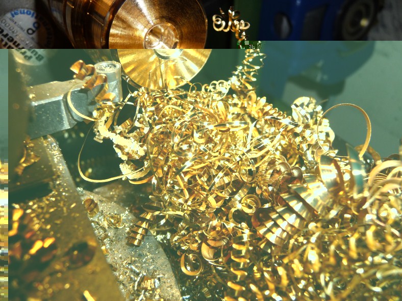

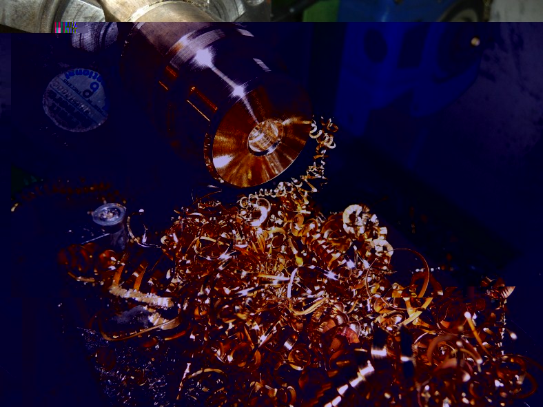

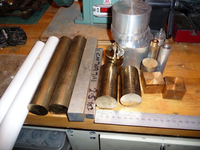

Ok I know it is very difficult to do this but when I bought my lathe I got some material with it, anyway decided to start my first job on the Lathe and some of the material that came with it look ideal as i needed brass about 30 + mm in dia  and this stuff was perfect, the brass has a tinge to it and is as hard as hell even with a new tip  it was very hard work hot or cold the chips come off and look like gold and a bit like bronze to turn the finnish is ok I think I will be able to get it better with time and playing with speeds.it came from a scrap bin  :lol: from somwhere that services helicopter engines and fighter get engines .

That will be some sort of bronze Peter, what type can only be guessed at, unless there is a stamp on the end of the bar, PB1, PB2 etc.

Hard to say but it is bronze the way it machines it looks like alloy bronze (bronze with aluminium)

Unfortunatly I think it is to heavey for Titanium, I got two pieces the same size one a known standard brass and this was by far heaveyer I think it must be as Bogs said bronze.

Aluminium bronze.
Turns OK but is a total bitch to drill and tap, wants to squeal and break taps.
Uses :- Valve guides,  fingers for steadies, giving to people you don't like with a drawing of a part with thirty seven 10BA holes.

As for ally bronze.  The grade I seem to get usualy turns of in a shower of small chips,  not the curly swarf you show.

p.s.  If you're feeling technical,  make a (very) precise 1 cm cube and weigh it;  also very precisely.  the mass will help to identify it.
Or do it non-destructively:
Use water in a measuring jug to measure its volume (assuming it's safe in water), then weigh it and calculate the density from that.

I took A piece of it to Mr Bogg's , he confimed it was Bronze ,
