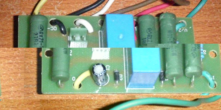

Stuart's Amadeal link took me to the correct motor....... And the board to match......
If Dave can fix the old board, I will have a spare. Which, of course will never be needed......  :thumbup:

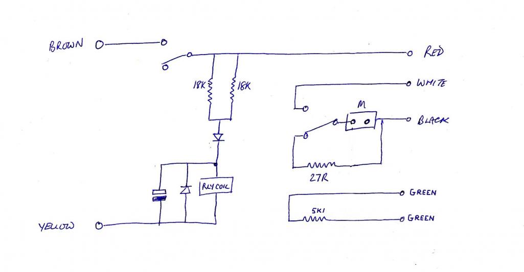

 Hi Dave D and Dave BC ,
just incase you didn't look at all of the cnczone link
I've added the circuit I traced  for of the small pcb with the blue relay
hope the tests go well tomorrow

The motor and board are on their way from Amadeal. I will take advice before installing em.
I can repair the blown copper trace with a soldered wire.
I'm meeting Dave BC at a local show, next weekend. He can have the board to play with then.......  :thumbup:
At the moment, I'm hopeful I can cope with a simple unplug/ replug....... Mebbe!  :palm:

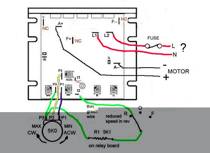

Hi Dave ,
add a lable/ marker  to one of the red  wires  that connect to the control pcb
then take a photo or make a note
changing the wires over one by one is a very good idea
but you need to have a plan B if some wires come off by accident ( been their  :lol: )
PS  just spotted the cable ties   your photo on page 3 gives all the detail you need
PPS    using your photo just added your wire colours to a diagram of the control
         not sure of order of mains wires but ties help to get them right
Hi Stuart ,
the relay board is in the control box with the speed control PCB
the relay circuit could be use full while fault finding
since it is an interlock for the power and switches the 27 ohm braking resistor
the damaged filter PCB is in a plastic box hidden by the motor cover  at the rear  of the machine

I've just soldered in, a length of wire.
Not a pretty site, but neither am I........  ::)
I've now got continuity down all 3 strips, (including the blob, top right). But nowt across.  :thumbup:

 Hi Dave  ,
I'd clean as much of the black deposit of between the live and earth tracks as possible
sooner or later the current will track across
I can't see a connection between the small capacitor and the live track

Point take over black deposit, John.
Small capacitor? There is continuity to my wire, from the top right solder blob, as the copper is sound between it and resistor blob.
I thought also routing through capacitor would be belt & braces.......

I mostly use brake/ clutch cleaner spray. But, it wouldn't touch the black deposit! Thinners did the job!  :thumbup:
I've taped the loose mica cover to the pcb, and assembled with new grommets into the plastic box housing, and machine cover.
Got continuity from each plug pin (l, n, e) to the appropriate component in the control box.... With no crossover.

If I may chip in, these boards need to be adjusted after instalation. If it is a KB one the manuals are avaleble and explain the procedures.

The KB boards need adjustment ONLY if you are dissatisfied with the factory settings. If adjustment is required the manual has clear instructions, including pictorials, to follow. The main consideration is installing the proper HP resistor for the motor being controlled.

The parcel arrived a bit late. Managed only to wire and locate motor, and swap boards, before family matters got in the way......
I now have 2 boards, both with orange stickers saying. Plug in horsepower resistor (R21) must be installed for this product to operate.
If that's an instruction to me, I've got a problem..... I can only see R20 and R22, and nothing unplugs.....  :scratch:
Is this an instruction to the person who sets up the board, before it comes to me?  :scratch:
