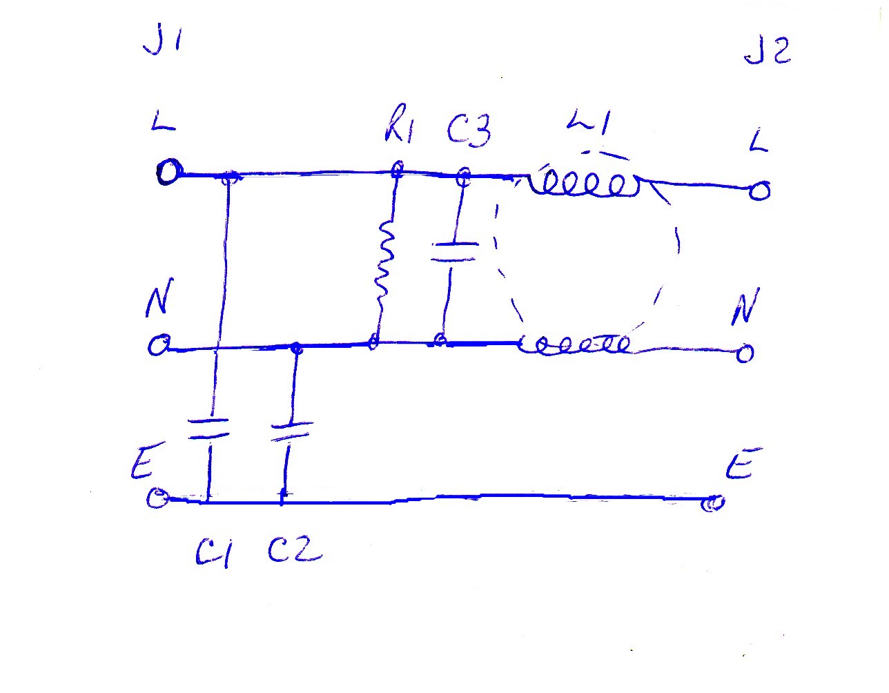

Hi Chaps!
My Chester 7 x 12 has very occasionally flashed, from the motor area..... But, kept on running.  :scratch:
Fitted new brushes..... No difference!
Yesterday, waiting for instructions. Speed control off. Direction switch, forward. It took off at top revs, in reverse! :bugeye:
Stopped it, using the direction switch. Tried it again. It produced a beautiful flash from the motor area, and died......  :zap:
Today, I've stripped and cleaned out the motor. Replaced the blown plug fuse. No joy.......  :scratch:
Working in from the plug, is this plastic box. It is inside the motor enclosure......
http://i110.photobucket.com/albums/n95/Dayjo/P5170005.jpgMini Lathe Electrikery.......
Guess this is the culprit......
http://i110.photobucket.com/albums/n95/Dayjo/P5170006-1.jpgMini Lathe Electrikery.......
It is mounted on this face, protected only by a sheet of mica (or similar).
Power reaches the l/h connetor block. But not the r/h one. (There's power in the middle, I inadvertently touched the pcb)!  :palm:
Guess it's a transformer?
http://i110.photobucket.com/albums/n95/Dayjo/P5170008.jpgMini Lathe Electrikery.......
Anyone any ideas or guidance? Where do I get another?
Thanks in advance.......  :thumbup:

It's the supression board.
Some capacitors, resistors and a choke ( the copper wirey bit )
Parts a commonly available, repaired several.
Give the values off the parts ...
Dave BC
Another shufti ...
Don't look like any of the components are shot, probably just visited blast fire and destruction on the PCB traces.
You can, at a push, run without it.  :thumbup:
Wait !! Don't !! It looks like the line trace is burnt. Maybe you have a short on the controller board   :(
Can you see anywhere where it has shorted through the insulator sheet ???

Mains input J1. Out, to machine J2.....
I'll see if I can find any blast damage......
Re: Mini Lathe Electrikery.......
« Reply #4 on: May 17, 2011, 09:49:39 AM »
Looks like the line trace has carried a lot of current out to the rest of the machine circuitry ... which is why it's got that incinerated look.
I would suspect that's just a symptom, the real cause lies further on, ie, maybe a MOSFET blown or summat ??
You say the motor revved up then snuffed it ??
Well, the motor does what the controller wants. If a MOSFET goes short, it will dump current into the motor unrestricted. The motor will zoom away ..
Until a fuse goes pop or some other protection device trips ..
That line trace appears to have acted as a fuse, and failed.    :(
Don't think that's the real problem though.
Dave BC

Yes, you can.
But don't solder wire across the 4 ( 2 either side ) that connect to the 'doughnut with copper wires'
Those should not be there .. as you can see, only where the copper trace is showing having burnt off the conformal coating green stuff..

That's a very strange looking bit of damage... normally with burning like that to the bottom of the board, you'd expect to see a blown component and - at the very least - heat damage to the top of the board.  On the other hand, the neutral wire on the input side looks like the insulation has melted back, which implies great heat; yet the output wires all look fine; i.e. the heat problem was contained within the circuit you've pictured.
One way to test this theory would be to bypass the board, and put a very low value fuse in the plug (3 amp tops). It's possible that a 3A fuse wouldn't survive a normal startup, but it should be enough to check that any ancillary functions (DRO, lamp) are still working. If your speed controller allows you to do a slow motor speed start, then you could try firing it up; if it runs away before blowing the fuse then the problem is in the controller board, and the hot suppressor circuit is a symptom rather than the cause.
However, my money would still be on the suppressor circuit: A) it's the source of the white smoke (burnt board), and B) the output wires don't show the heat damage that the input wires do. Assuming, that is, that I've got the board the right way around (the choke being the furthest part from the plug). If it's the other way around, then the problem is definitely deeper into the machine...

I am 99.99 % sure its the suppressor circuit as AdeV said disconnect it and join the wires colour for colour with a small say 3 to 5 amp fuse in the plug top , you will disrupt the tellys  :)
the damage looks to me as to swarf ingress as you have had flash overs in the past , as other have said there is no component damage compared to the board side

the damaged PCB is a mains filter
and you should be able to test the speed control board without the filter
first test it without the motor connected and a 60W to 100W GLS bulb in series with the live supply
to limit any possible fault current
the bulb needs to be a have a tungstan filament  (eco bulbs don't work for this test)
