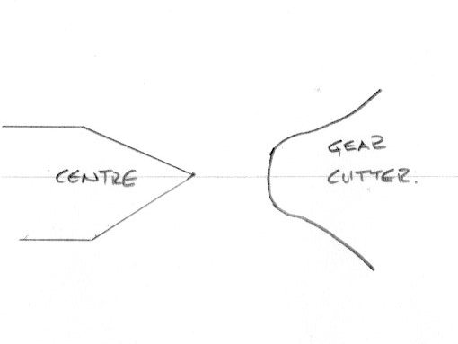

Hi Troops
Centreing a Gear Cutter ?? Can neither spell it nor do it ...  :scratch:
The cutter has a large radius, so it's not very accurate to do the 'trapped feeler guage' stunt.
The 'Workshop Practice' book on Gear Cutting is very glib about it, just says put a centre in the dividing head ( knew that bit anyway  ::) )
and set the cutter to the centre. Helpful b****rs.
There has to be a better way ... in any case, if I were to want a slot using a slitting saw, it wouldn't work anyway ... would it ??

You could try the same trick used for setting a lathe tool height. i.e. lightly nip a steel rule between the centre and the cutter edge and check that the rule is square to the cutter.
Alternatively, use a electric edge finder (or eye-ball it ) to locate the cutter edge and move the table half the width of the cutter.

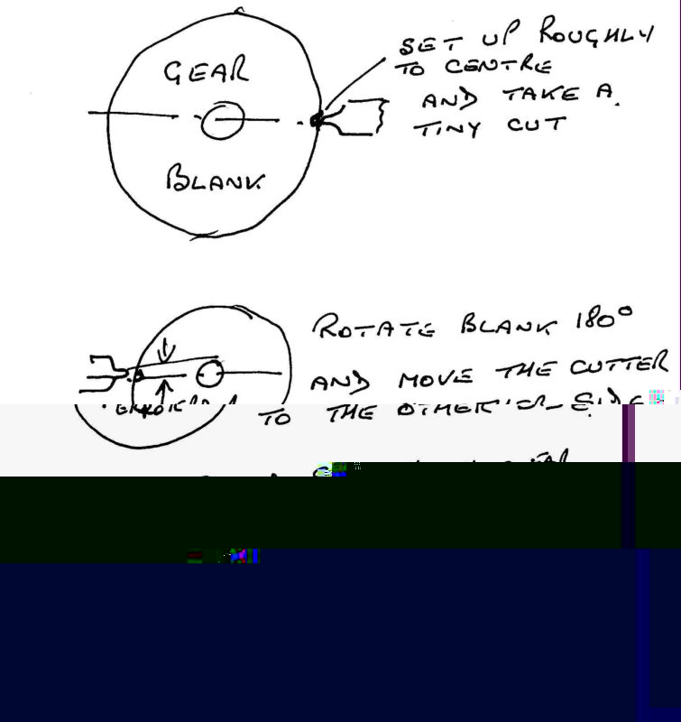

Re: Gear Cutter Centreing
« Reply #2 on: March 19, 2011, 08:44:03 AM »
Hi Dave,
Look at the C-o-C and I hope that explains it for you.
« Last Edit: March 19, 2011, 08:46:26 AM by bogstandard »

« Reply #3 on: March 19, 2011, 09:08:07 AM »
Hi Troops
Thanks John, will try that  :thumbup: knew there had to be a way ...
Bill, Tried that first way. Owing to the radius of the cutter, ( 10DP ), it's possible to move the quill fine feed up down by about +/- .020" before the trapped feeler guage looks anything other than vertical. I assume that's what you were describing.
Regret I have no idea what the other method is ...  :scratch: C - O - C ??
I only have a HND in Electrical Engineering, anything vaguely resembling two bits of metal banging together ... I'm utterly stuffed ...  :doh:

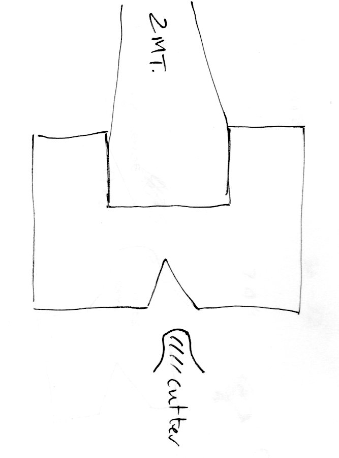

It had occured to me to use the Myford 2MT drilling pad I have. This has a Vee-groove across it. I presume it is truly across the centre ??
Genuine Myford. I suppose I could try it, then verify with John's method ... like this ... att.
Dave BC

Was requesting a C-O-C of the method ..
Dave ..
