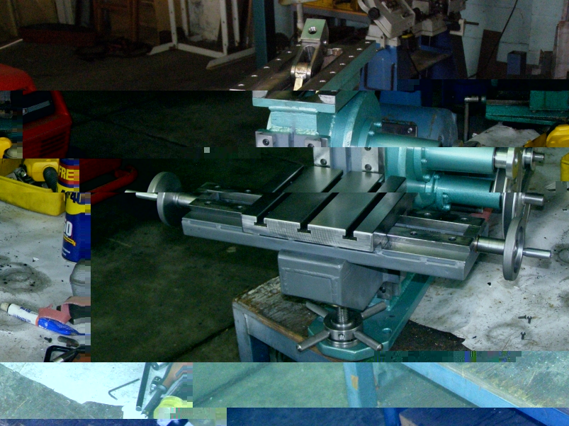

Hello to all, I thought you may like to see my shaper project.
Found the old 1930's drawings on the net and made new drawings in Metric and it's all
welded/bolted. It took days to cut the bullgear and things got a bit boring.
I notice people ask for pictures so will attach. Regards.

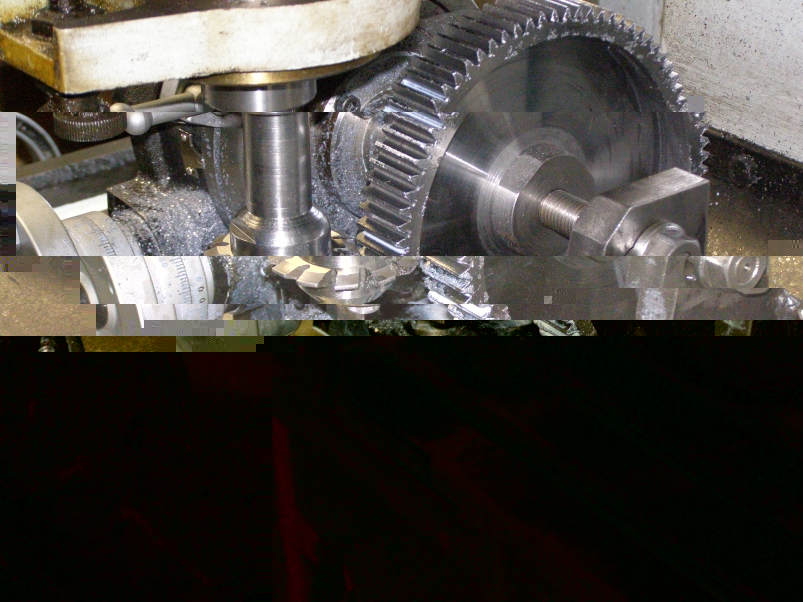

You have made a top job of building the shaper ,,,,,,,,,,,,,how did you cut the bull gear ?

To Rob,
I cut the gears on the mill drill with rotary table

« Reply #14 on: March 15, 2011, 04:24:22 AM »
Plans & Pics have been posted on Homemodelenginemachinist.  3-parts. in the Download section. Regards.

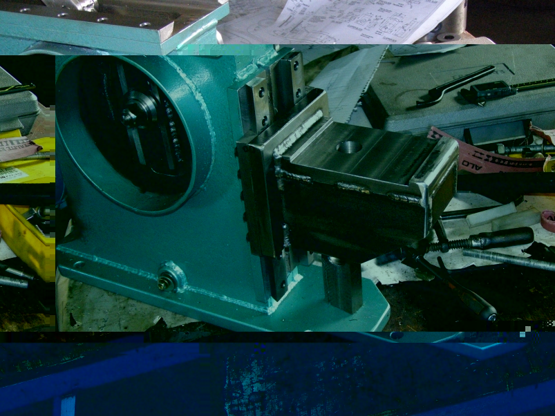

« Reply #23 on: April 22, 2011, 08:20:37 PM »
Did you have any trouble with twisting/warping metal after welding?

I have seen a lot of fab jobs before, but that takes them all by storm. You are truly a craftsman in the finest. My hat is off to you. The machine you built is a "Pootatuck  Shaper". If any one would like to have the original plans with dimensions , I would be glad to post them. Just let me know. The original was made of cast iron. I was going to check out at the foundry near me about what it would run to pour the parts. Maybe some day. Again a beautiful job.
