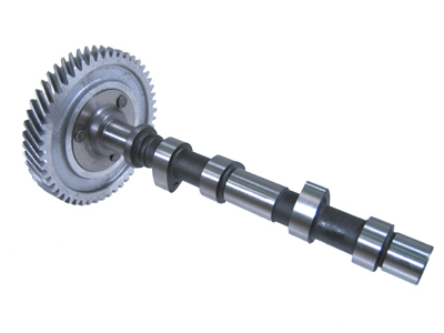

« Reply #12 on: March 08, 2011, 03:45:05 PM »
VW likes to be erm different.  Part of the reasoning for this is simplicity, because of the VW firing order they need a simpler to make camshaft: Since opposing cylinders are 180deg out of rotation with one another they can use the same lobe of the cam reducing the number of lobes that must be machined in half.
Here's a photo of the crankshaft:
And some engine tins with the cylinder numbers on it:
The 1/2 side should be easily readable at least.
While it would be cool to turn this into a 90deg V it would require more work since you couldn't just use a flat crank like the VW and you would have more lobes on the crank.  If you were to use a flat crank you would get a little bit of that harley surging from firing at odd fractions of a rotation instead of every 90deg.
Some more info on the workings of the silly little VW: http://www.vct2.nl/vwtech/Pages/How%20Engine%20Works/How%20Components%20work/How%20the%20Boxer%20Engine%20Works.htm
Using the VW diagram to fire on the opposing head each time you would need a firing order of 1-3-2-4
To the OP sorry to derail your thread, I hope some of this information is at least useful to you in some way.
