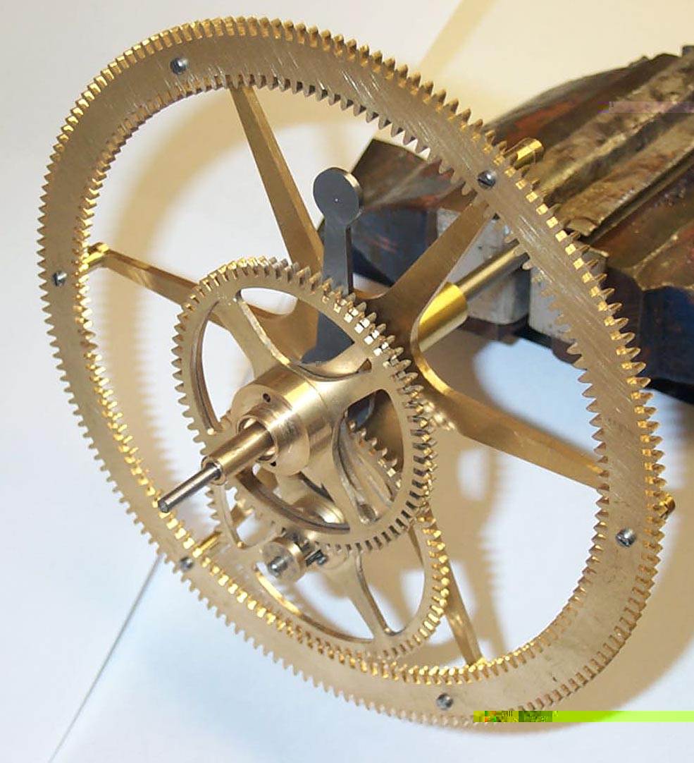

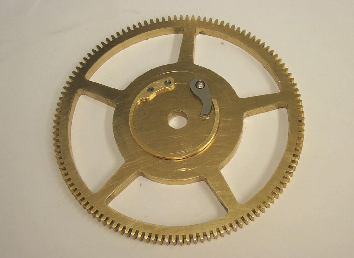

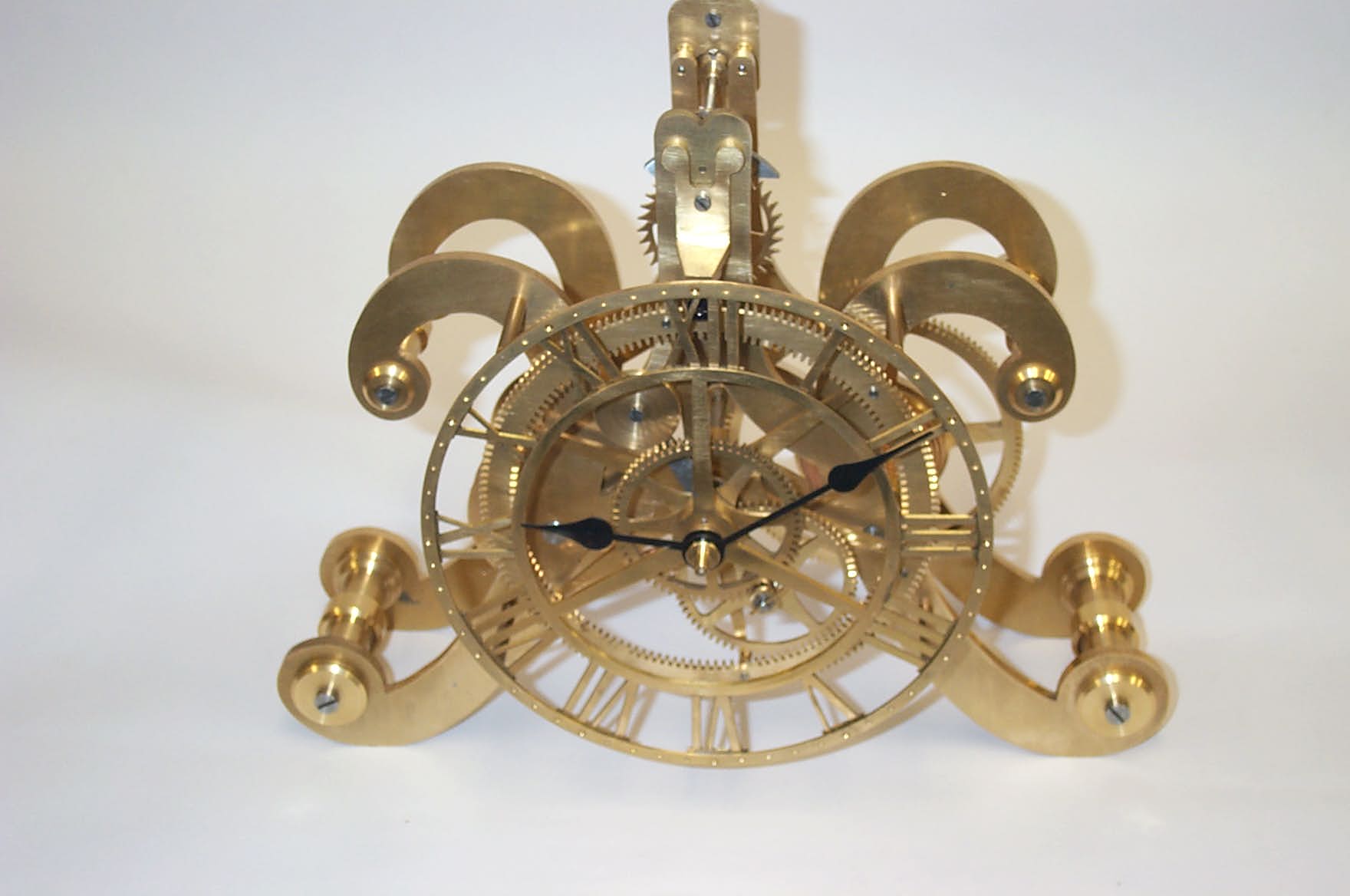

This clock has epicyclic gearing instead of more normal system.  But it has its drawbacks.  The main one is that the winding square is at the back, so the clock has to be disturbed to wind it each week.
I've attached some pictures, but I don't know if they will come out, but here goes ...

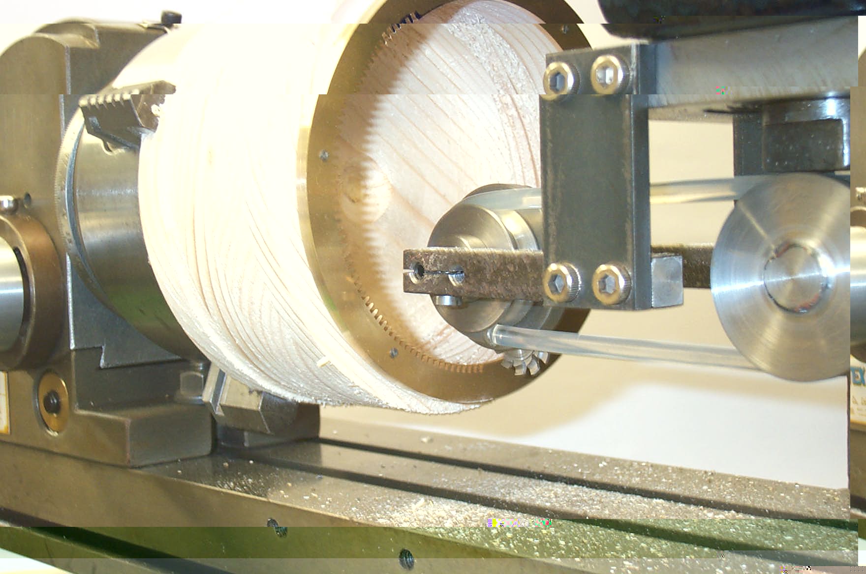

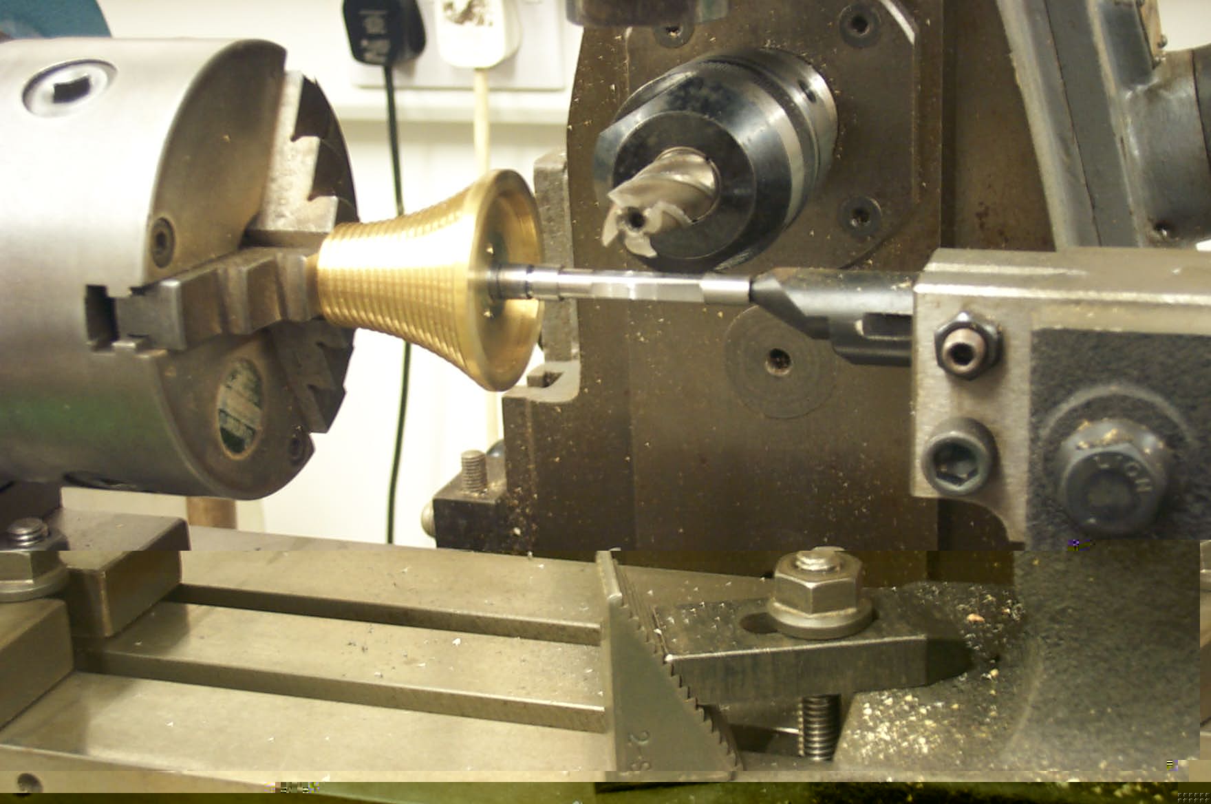

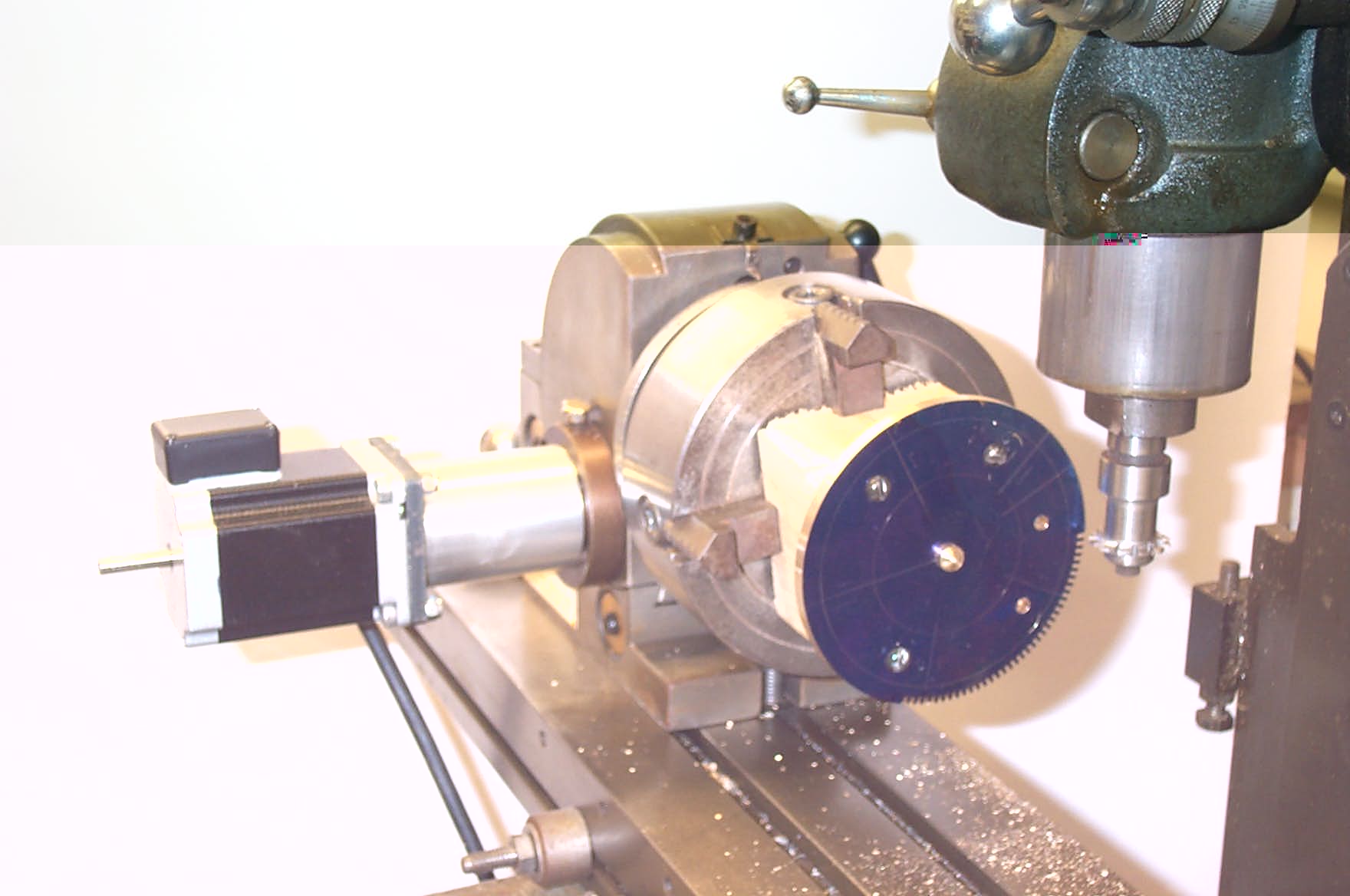

Some answers to some of the questions, but not necesarily in the right order.  I have an old Myford Super 7 on which I do all my turning.  I have adapted blank stub arbors (2MT) to carry wheel blanks and also Thornton's cutters.  After turning, the complete arbor is transfered to the dividing head on my miller (Centec 2B), which is also 2MT, so no loss of concentricity.
The dividing head has been fitted with a stepper motor, itself driven by a DivisionMaster black box, so any number of teeth can be cut.  And away we go.

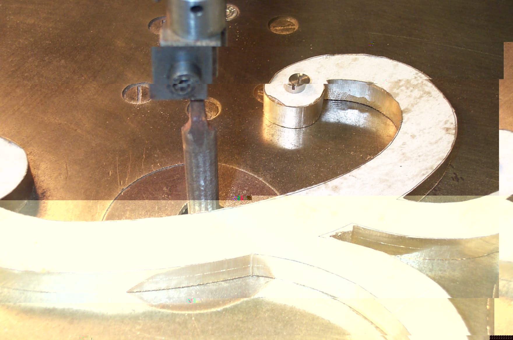

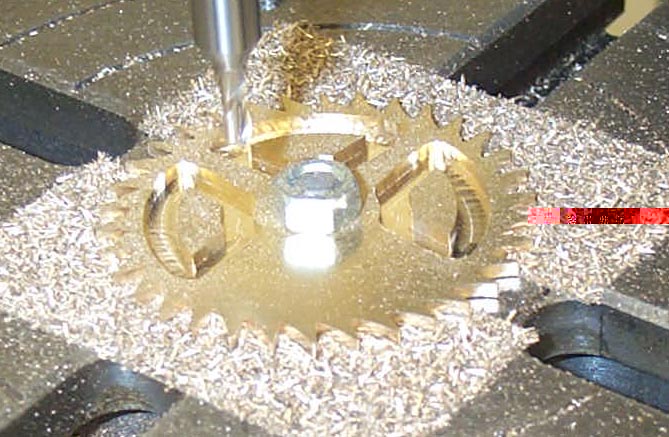

The other machine that I am still learning how to use fully, is a little Taig Bench miller.  This is CNC controlled, so I now machine all the crossings (spoking in US) and it save me all that 'filing to the line' which I now find harder and harder as my eyesight gets worse.

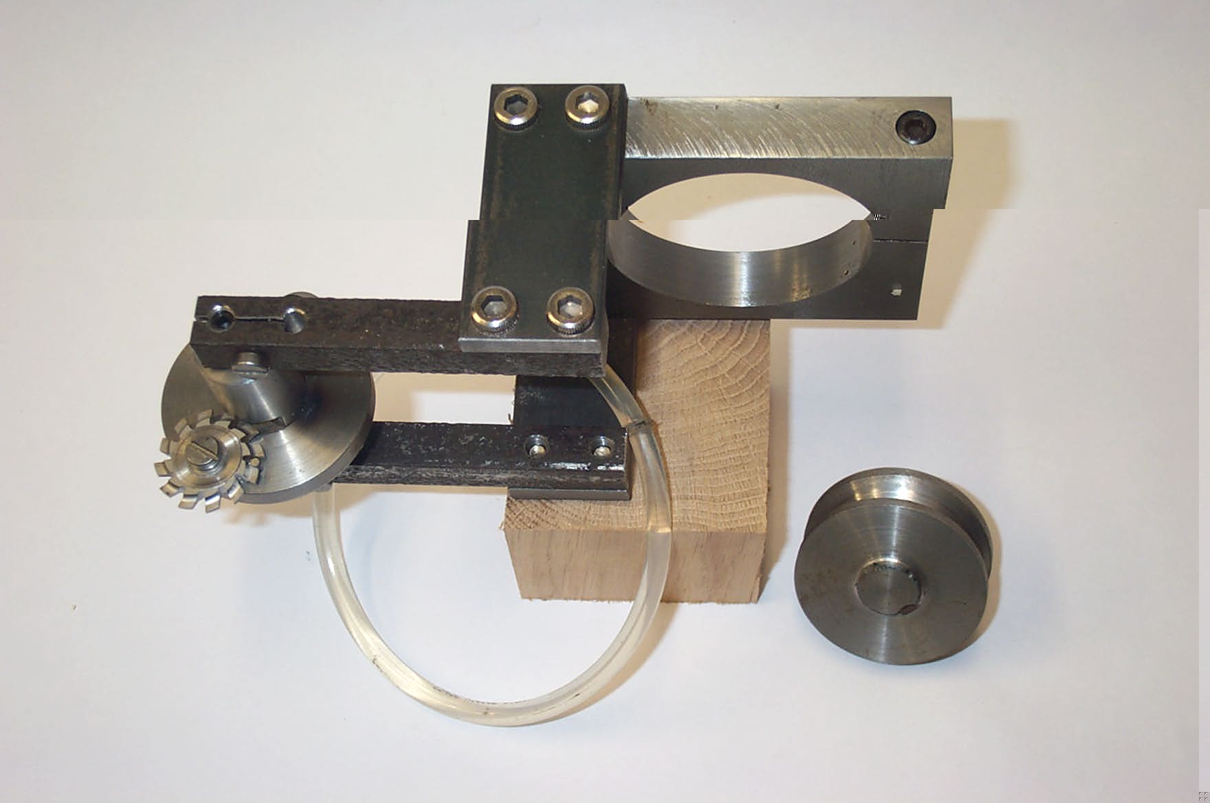

When I cut the internal teeth of the anulus gear, I needed to make a cutter frame (to pass into the bore) that would be stationary while the table of the miller traversed to cut the teeth.  I mounted it on the quill of the vertical head while driving the cutter spindle with a belt from a pulley in a chuck in the horizontal drive.  Again, the chuck carrying the turned blank was transfered to the dividing head as it has the same nose fitting as the lathe (very useful facility!).  I'll try to add some pictures of the cutter frame, cutting the internal teeth and crossing out a wheel.  The multi-tooth cutter is mounted eccentrically on the cutter frame spindle so as to precent a single tooth to act as a fly-cutter, suitably counter balanced.

Beautiful project, clockmaker, I love postings like this that show the ingenuity behind making things.  I do have a question.  Did you make the gear milling cutter used to cut the internal gear teeth?  How did you determine the profile?

No, I used a bought-in cutter, specially designed for cutting clock wheels.  If you scroll back a bit, and look at the picture labeled 'Picture 10', (I have found that if you give it a click it will enlsrge, but you probably knew that) you will see me cutting the teeth of the Great Wheel with a multi-tooth cutter on a 2MT arbor.  If you then take a look at the cutter frame picture, you will see the same cutter attached to the wheel on the cutter frame axle and pinned in order to prevent it from rotating.  I then used this as a fly-cutter to cut the teeth.  Is that OK?
Yep, whatever works.  I've just always had an interest in cutting internal gear teeth, but never knew how or where to get a cutter that would give me a proper profile.  Very clever!
