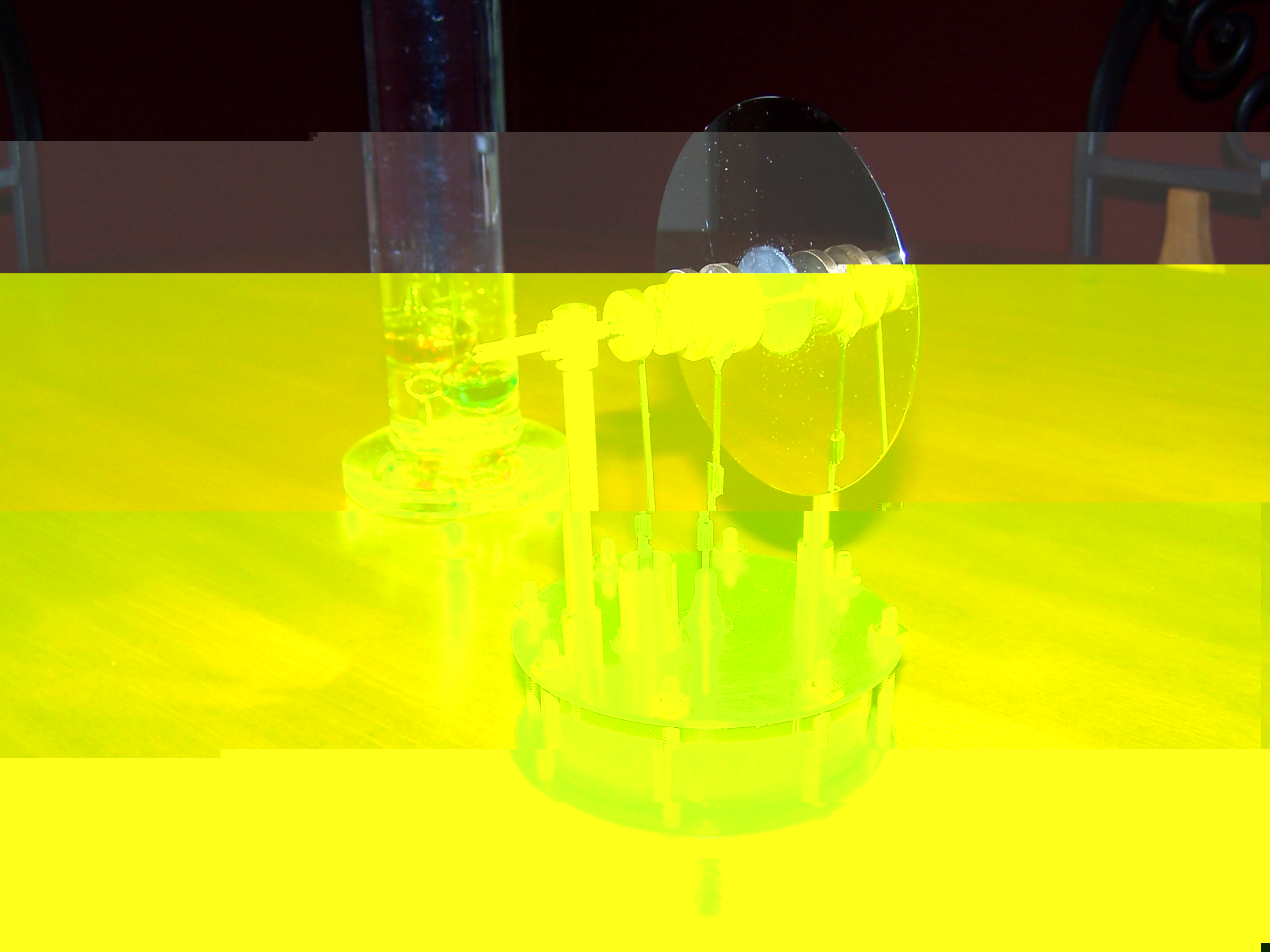

On to the FUN. I now realize I should have done a bit more research into plans and whatnot before jumping into my first build by doing a quick sketch-up with pencil and paper and having at it. Here are the results. (I shall now attempt to post a picture)
It looks like an LTD Stirling, it smells like an LTD Stirling, but it runs like a brick. I have begun trouble shooting it but I am thinking that the power piston (aluminium) power cylinder (brass) displacer and displacer cylinder are the faults (oh, and the bushings on the con-rods). Like they say, if all else fails read the instructions. Still had a good deal of fun and learned quite a bit. Also enjoyed figuring out how to fab some of the parts.
Just here mainly for the fun. Some day I hope to post pictures of a runner of some sort or the other. Will continue to tweak the LTD as time permits. Maybe someday it will go.

First thing to do is get rid of those metal bolts between the hot plate and the cold plate.  They conduct heat, making it easy for both plates to approach the same temperature.  Stirlings depend on a temperature differential between the hot end and cold end of the displacer chamber.  Your bolts are short circuiting that differential.
Use nylon bolts or plastic electronic standoffs tapped to take short screws.
Regards, Marv

Thanks mklotz. I was afraid they would have to go. They will most likely be replaced when I am able to locate a more cylindrical displacer cylinder. The current one is a tad too far out of round I fear. I think it will have to be shelved until I can find one.

I think Marv is right on I'd replace those screws with nylon I know the LTD stirlings I built were pretty touchy about getting things balanced also.
