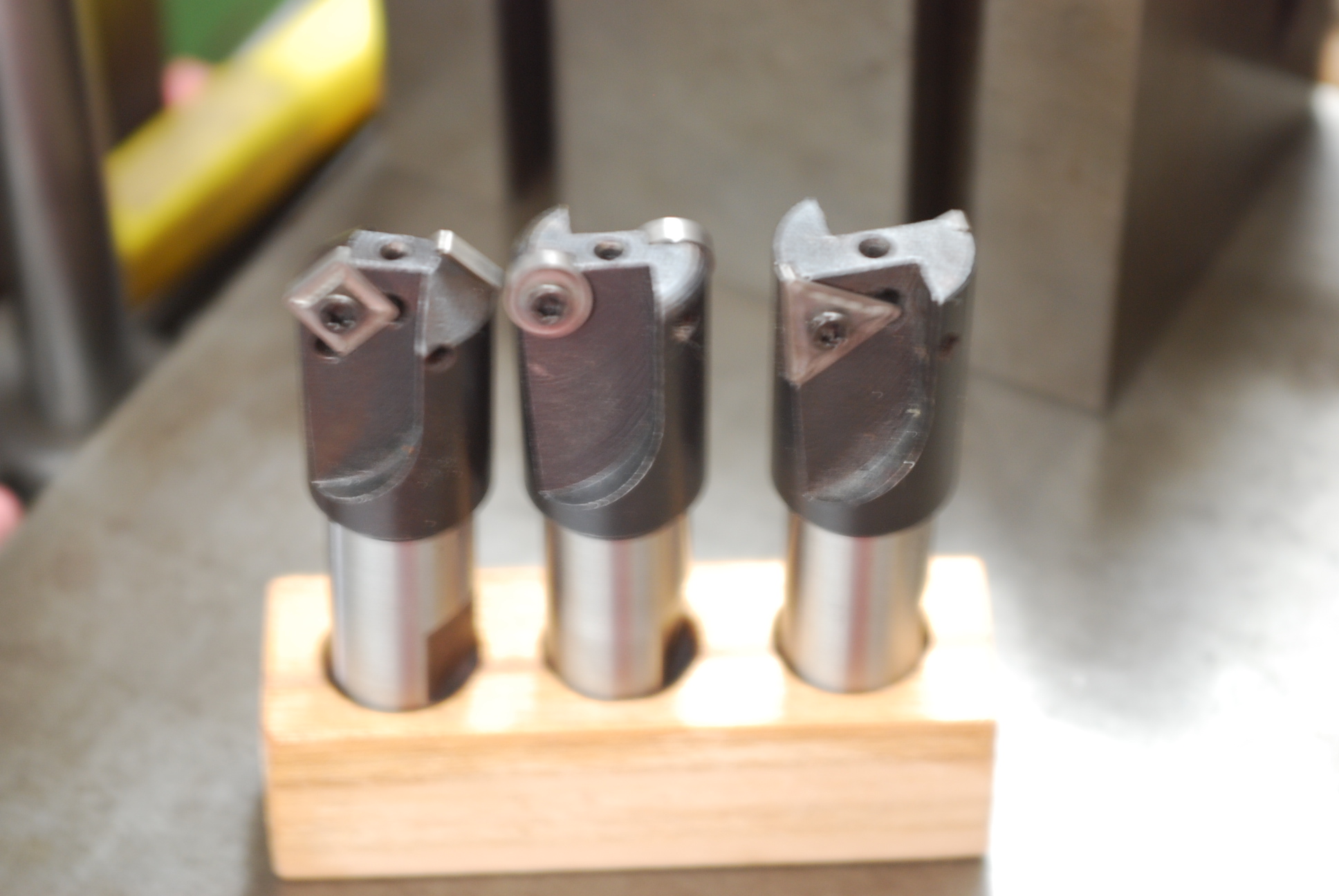

I had just received from the USA a set of three milling cutters,called the Little Hogger Mill Set.
Just the job only in my enthusiasm i forgot to take note of the size of the Shank which is 3/4".so did not order a holder to suit.
Now my mill holders only accept shanks up to 5/8",
So select a suitable piece of MS and start turning a Three Morse Taper and drill and tap for the Draw Bar.

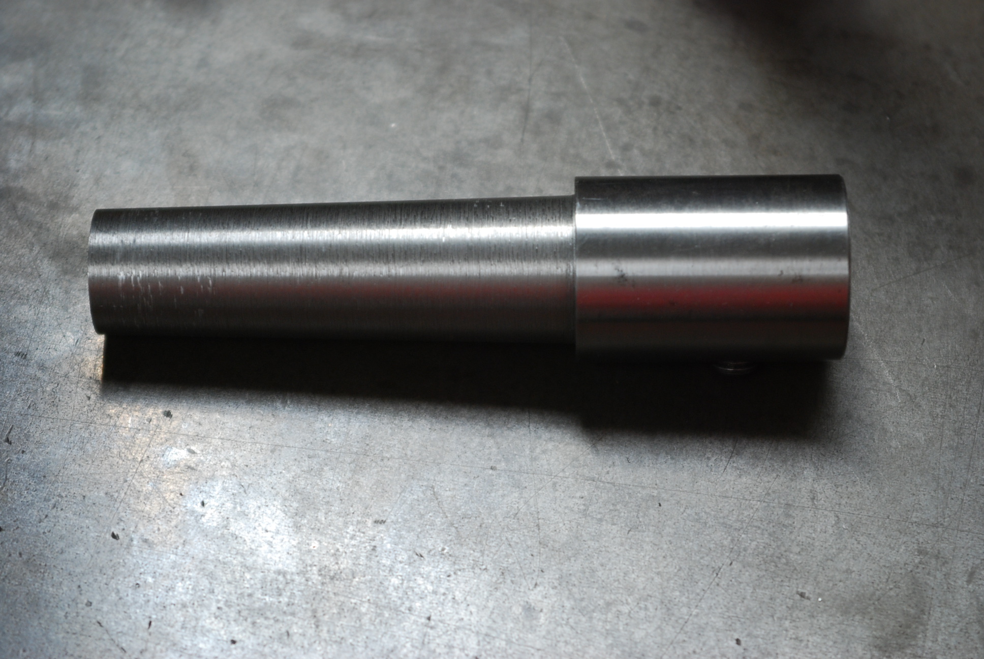

« Reply #82 on: October 28, 2011, 01:47:05 AM »
 :hammer:
G.Day Guy's,

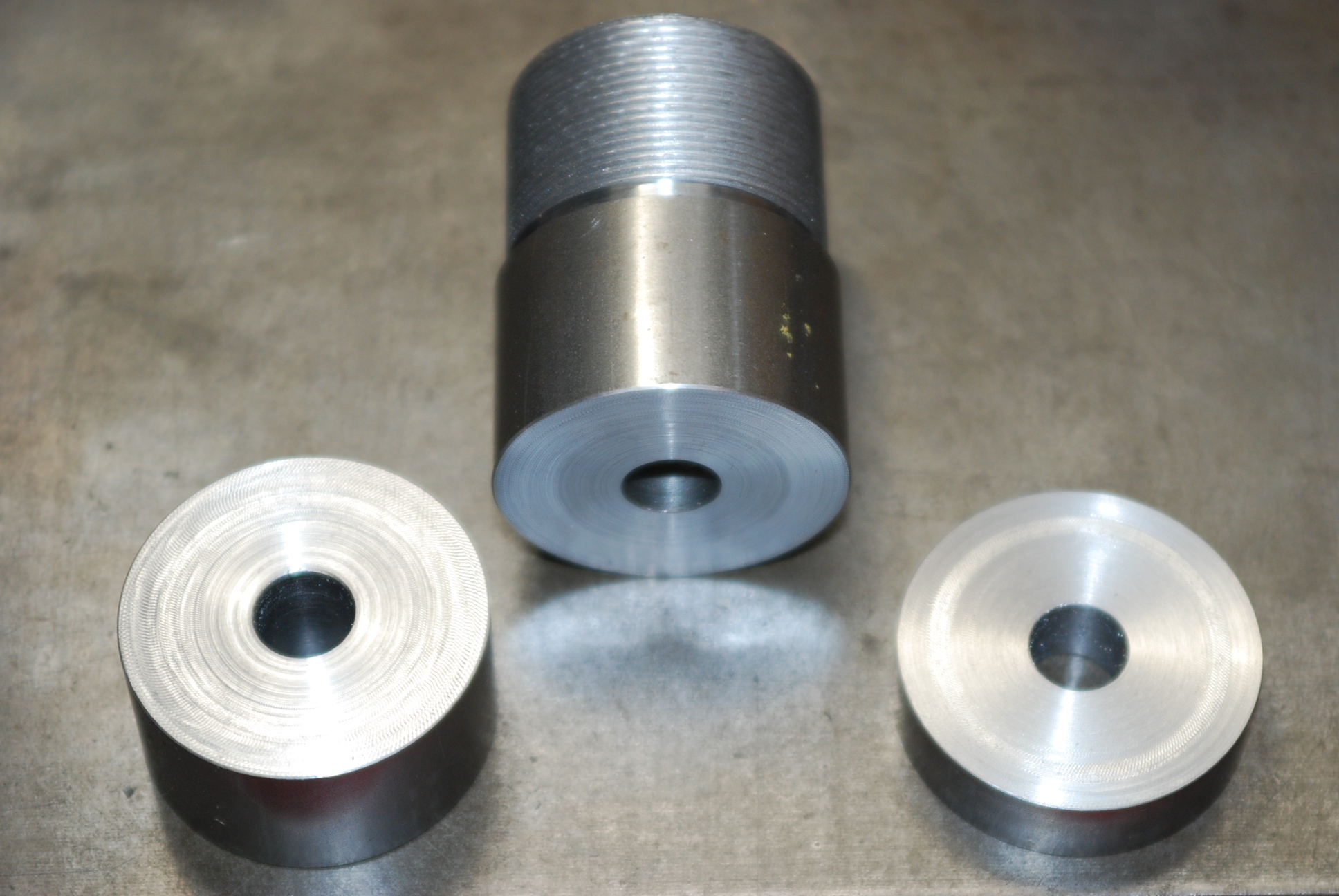

Sorry,but i forgot to inform you as to what were the two different ends in the last photo.
Well when i measured the length needed for the unit i had machined to take the Draw Bar i had a little over 1 1/2" to cut off.
Not the one to waste anything i enviseged that maybe in the future i will wish to hold some other unit in the Morse Taper and that the length of the Draw Bar is too long so i cut the 'off cut' to two sizes,like big washers  and that is what you see either side of the finished threaded plug (for want of a better disscripsion)
GerryB

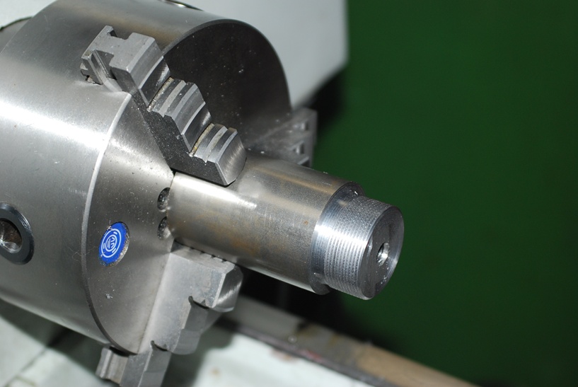

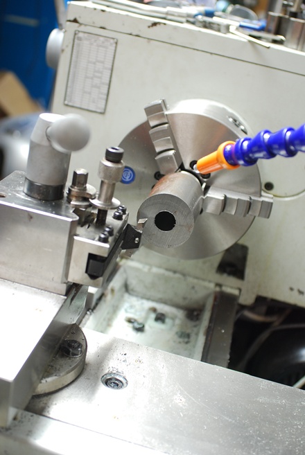

« Reply #91 on: November 17, 2011, 11:46:22 PM »
G.Day
 Each,
Well i hope its a good day for you,its 37oC at the moment so its too hot
 to go into the oven(shed)
Also i tried yesterday to send this post but nothing seemed to happen
when i hit the 'Post' button.
Now i realize that the server could be having problems,but why do i
loose every thing including the attached photos?
Any way here goes again.
I did scan the various leads given me as to the 'Cat head Chuck' issue
but had no luck,maybe i was not doing it right.
So i decided to make a suitable unit to do what i needed,not too
difficult,actually quite easy.

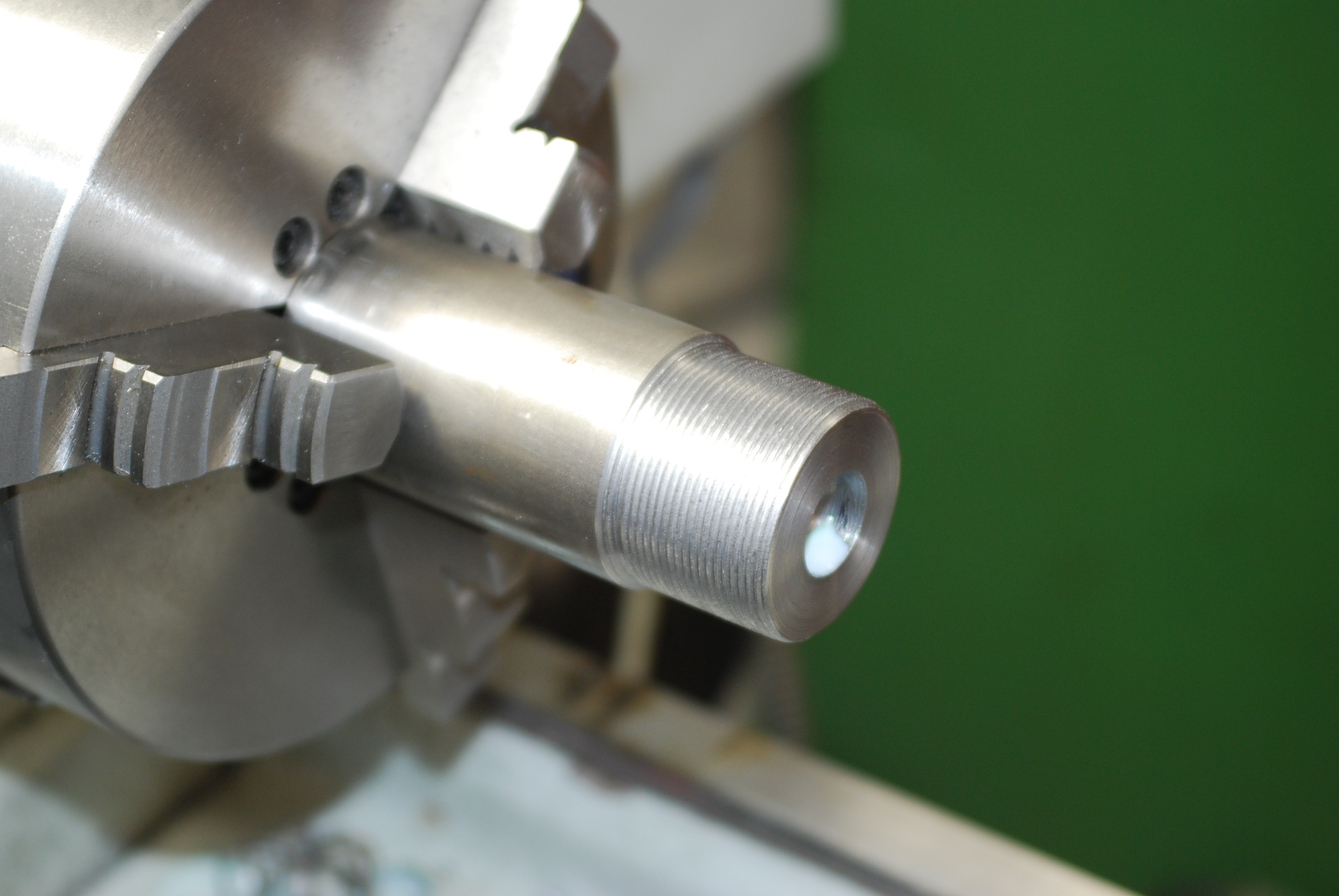

I fount a suitable piece of MS 2" X 4".
Chucked in the Three Jaw and reduced an inch at one  end to 42mm,then
cut a thread 1.5mm pitch.
Removed and tasted in the Head Stock for fit,perfect.
Re chuck and bore out the centre to a suitable size.
When setup to bore i placed a stop on the Bed Rails to stop the cutter
1mm from the face of the Chuck.
I did not want the cutter coming into contact with the Three Jaw
Chuck,also it prevented Swarf building up in the Chuck and made a nice
wall to keep the Suds in play during the boreing.

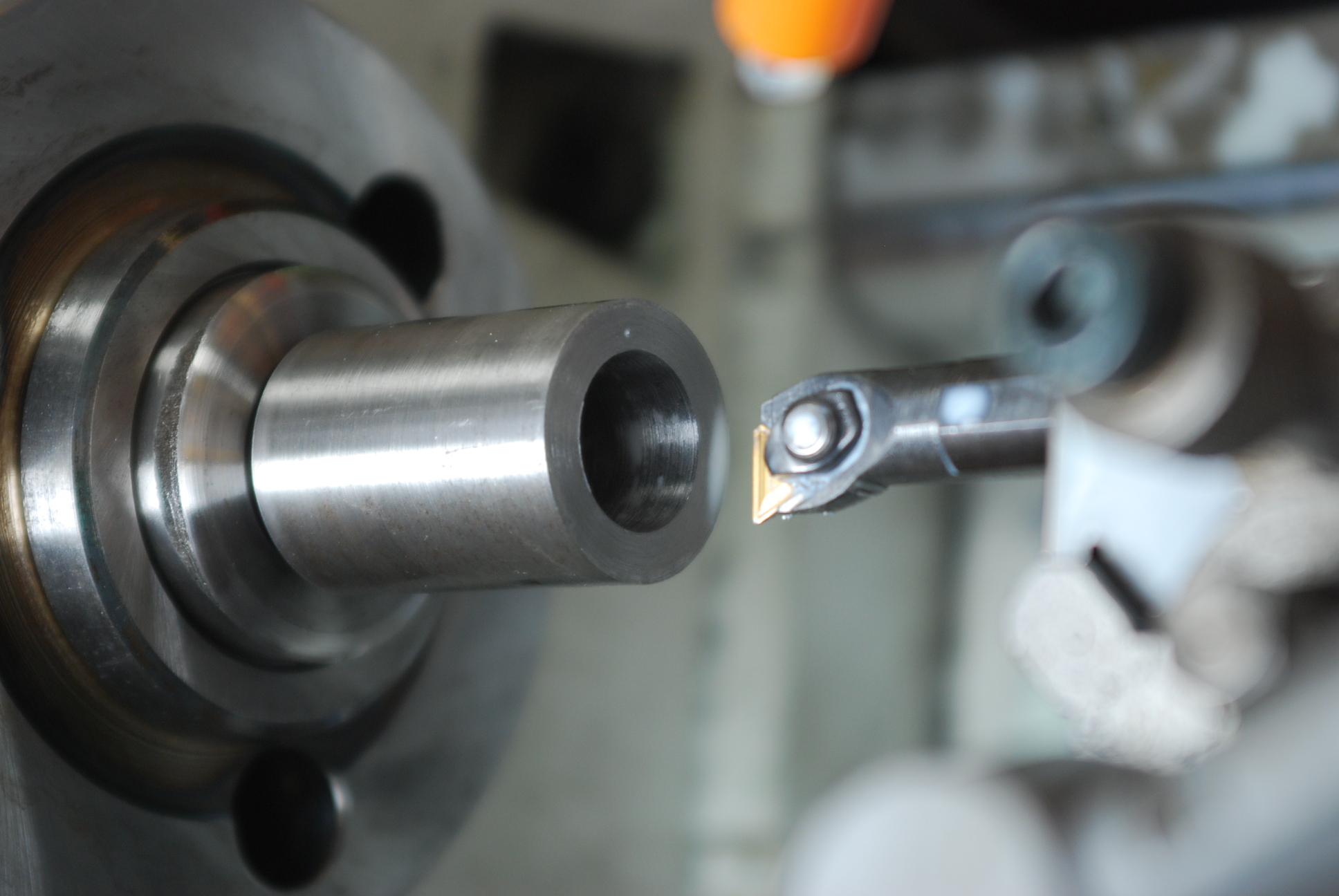

Once i had finished boring out to a suitable size i reversed the item in
 the Three Jaw and cut off the 1mm blank from end.
GerryB

« Reply #93 on: November 18, 2011, 09:42:32 PM »
I have reduced the size of this photo so here goes.
It is the first set up of reducing the Dia to 43mm and then cutting the 1.5mm tgread.
GerryB

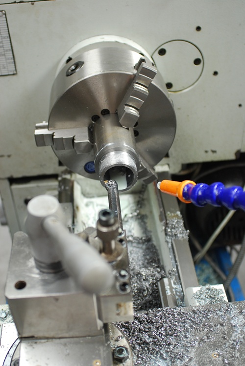

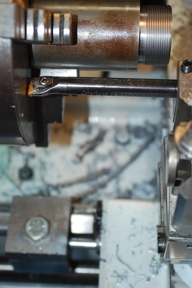

Offline GerryB
  • Posts: 120
Re: Chinese Lathe CO6230A
« Reply #94 on: November 19, 2011, 12:57:13 AM »
It would seem that i will have to set up each Photo individually at the moment as it will not accept more than one at a  time.
The second Photo shows the set up for keeping the Boring Tool from coming into contact with the  Chuck.
I have secured a Saddle Stop on the Bed Ways.
GerryB

« Reply #95 on: November 19, 2011, 01:26:52 AM »
This one shows the set up for Boring

« Reply #96 on: November 19, 2011, 01:28:41 AM »
And cutting off the 1mm end.

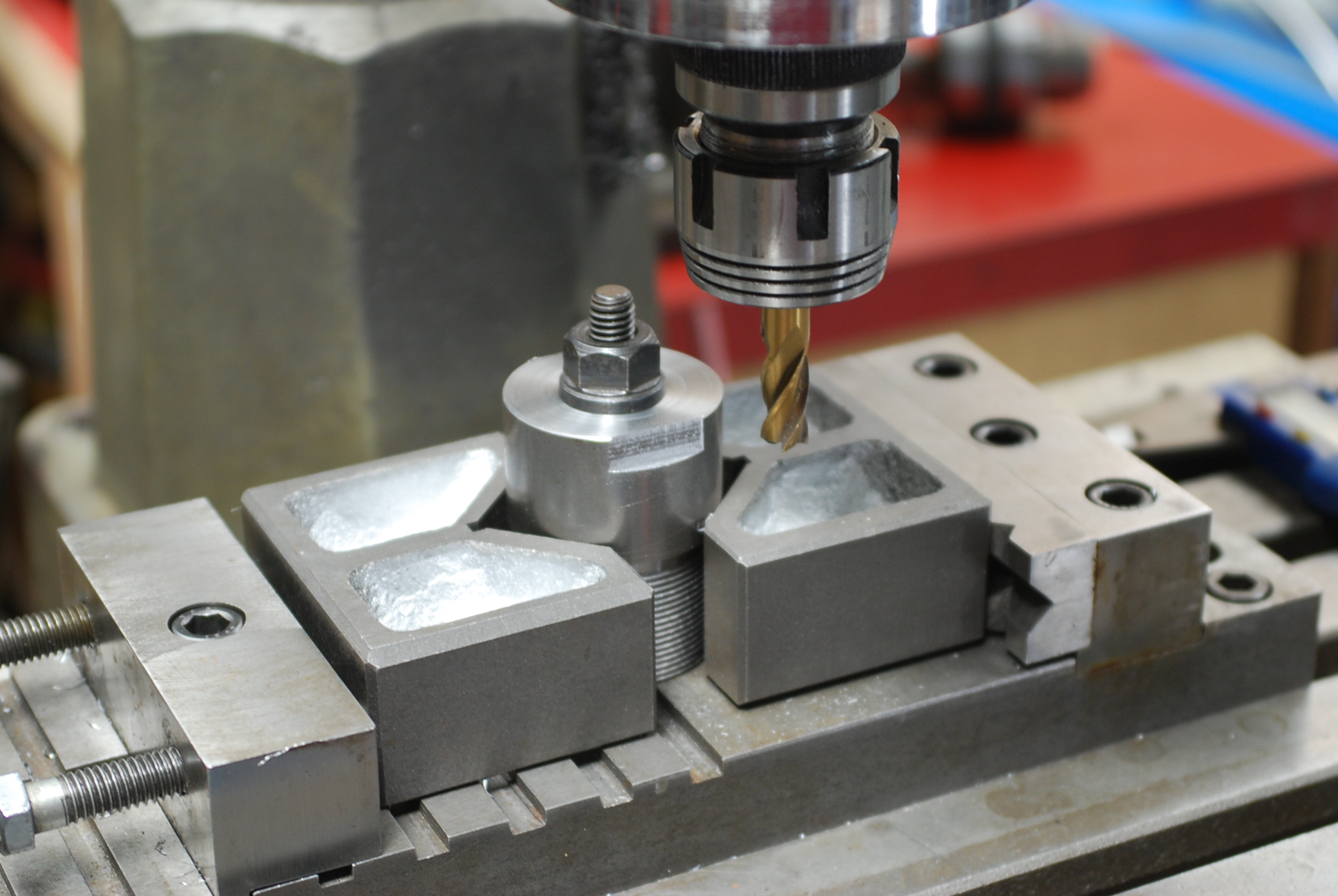

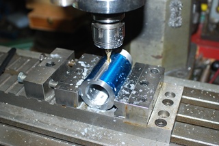

Offline GerryB
  • Posts: 120
« Reply #97 on: November 19, 2011, 01:55:05 AM »
Now i decided that i would use an Adjustable 'C' Spanner that i have so its on to the Mill to cut some slots.
I know that i could have just drilled a couple of holes suitably placed and used a Tommy Bar but then what would i do with my nice Adjustable 'C' Spanner?No do not answer)

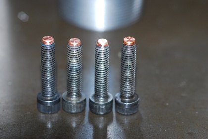

I also decided that i would use 4 6mm Alan Cap Bolts for the adjustable Claws (well it is a Cat Chuck)
I found 4 suitable bolts and decided to fit Copper Pads to the ends that are in contact with the work so as not to mark the item being held.
Of cause you do realise that it only supports an item and rotates with the same,not like a Fixed or Traveling Steady.
There is also plenty of room to fit other Claws.
I envisaged using 1/4"x40tpi which would help in setting up to Thous of an inch.but that may come later.
The last Photo shows the completed unit so it now waits for the Barrel set up for which i built it.
