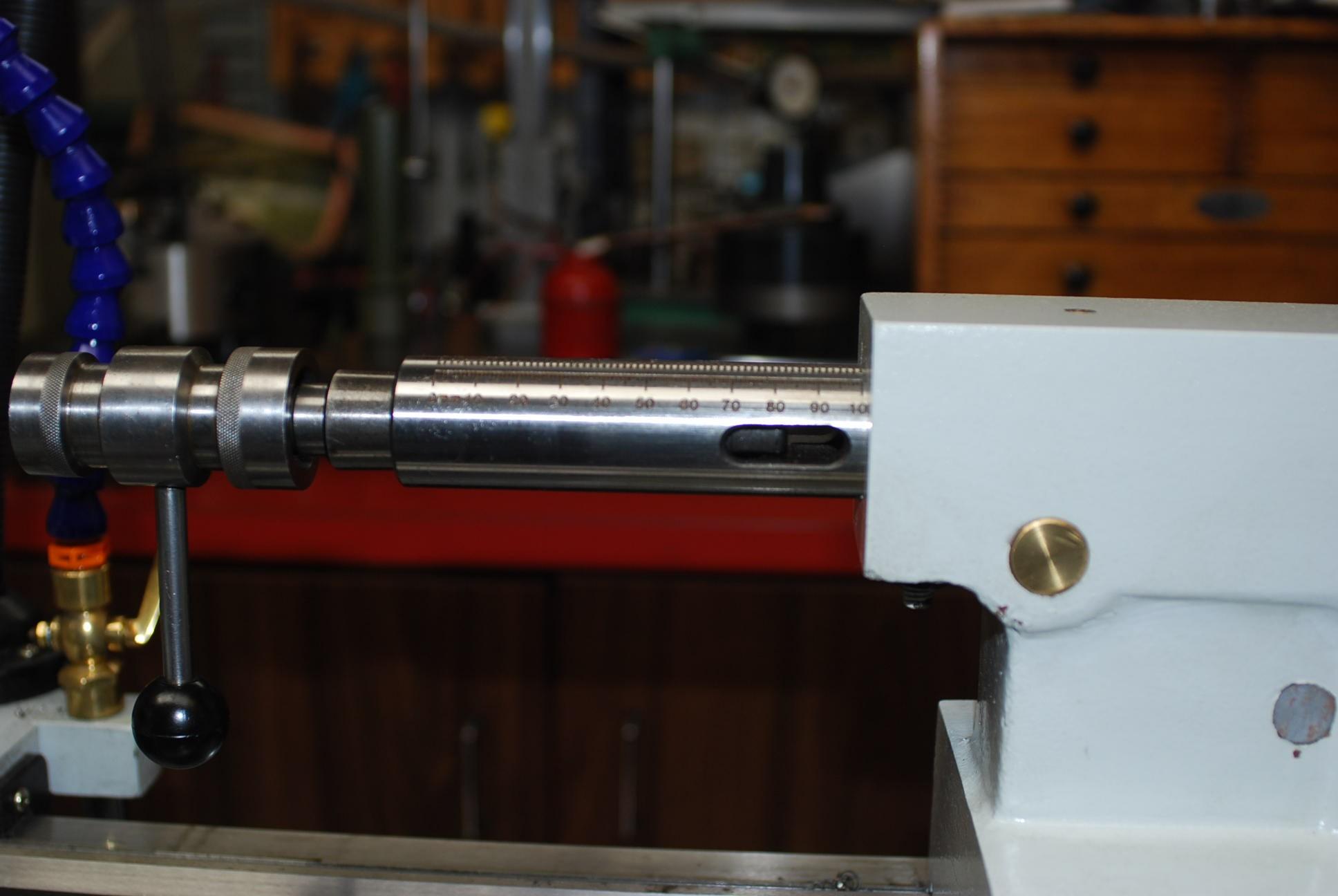

I had deko at the Tailstock of my lathe and it would seem that someone has heard you and done something about it.
My Tailstock is already accepting 3 morse tanged  and the not tanged tools.
They eject correctly when the handle is wound back also they have a slot in the shaft so that tools that have become jammed can be unjammed by the usual method of tapping a tapered tool into the slot and thereby forcing the jammed drill or whetever out.

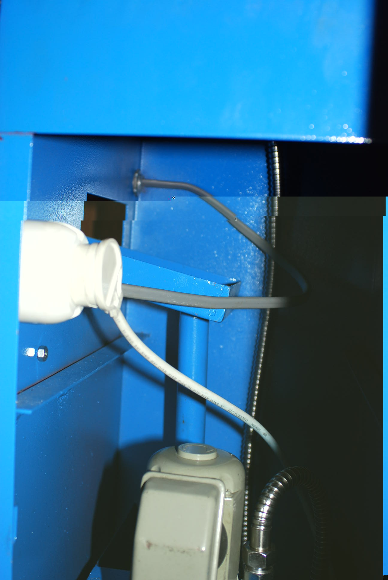

You will notice in the last lot of photos that the last photo together with photo 4 is the attampt to fit the Foot Controled Brake unit.
In photo 4 the leaver that transfers the movement from the foot unit to the Brake unit is in place.
The last photo shows the Micro Switch in position but not secured as i was still finding out how it fitted and operated.
There was no mention of it in the Instruction Manual delivered with the lathe.
I finaly set it up and secured the various shafts etc. to how i think it should be.
On final set up it worked very well,it will stop the machine dead no matter what speed i set it to run at.
I dont purposely stop the operation with the foot  brake as i think it should be used in emergency.
I do use it on the lowest speed though when cutting threads,its a God send.

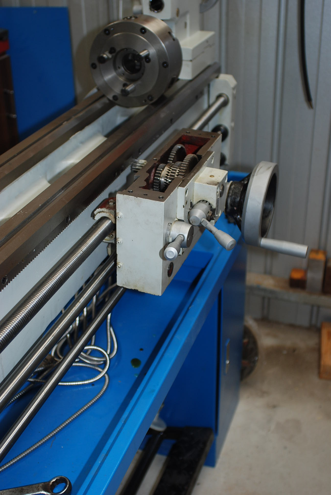

The next step in setting up the lathe was to paint the unpainted arears of the Apron and the  Drive Gear Box.
I was luucky that the Gear Box that drives the (thread cutting) Apron has been modified so that the security bolts that hold it in place are not now a part of the internals thereby allowing the removal without losing the oil.
The drive shafts were fitted together with the Apron,so far no problems.

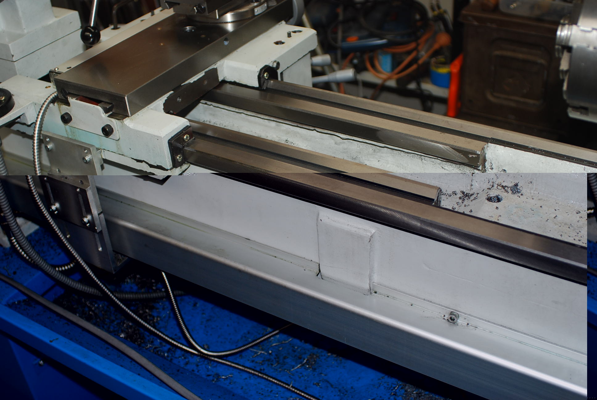

Went to fit the Saddle Unit only to find that it has to be secured to the Apron,so undo the drive shafts etc and leave in place whilst the Sallle is connected to the Apron.

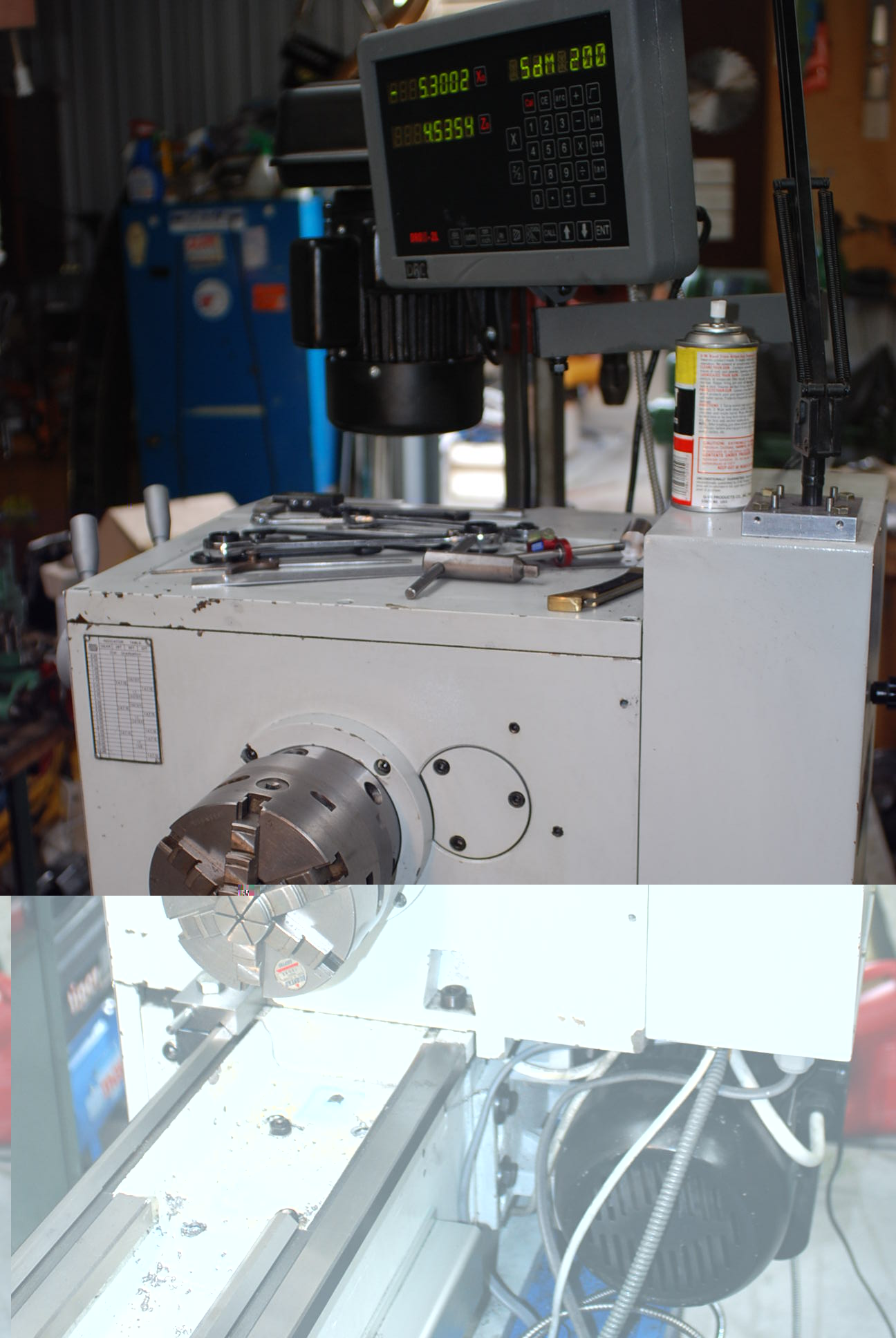

At about this time i received the DRO unit that i had purchased from the manufacturer in China.
This unit was identical to the one i had purchased from a company in Singapore,but was cheaper.
I did have to pay $15 extra for the supply of a smaller sized unit to fit on the side of the  Saddle,as they recomended.(see photo)
I do not know wether the previous models of this lathe have two unmachined lumps on the back of their bed but mine has.
I do not know what they are for but they caused me to mount the 'X' DRO unit lower lhan i should have liked,but i have had no ploblems.
The suppliers of the DRO units also supply you with well machined pieces of Aluminium angle and plates drilled and tapped to fit the units plus capped bolts.
The only problem i came up against when fitting the RDO unit to the Saddle was that the armoured cable would not go straight out from the end of the unit but fouled against the  top of the Saddle.
I had to remove again (third time) the SAddle in order to mill a small slot to allow the cable to go straight back.
I know that i could have let the cable bend out and over the saddle but i prefered to allow it to go back unhindered.

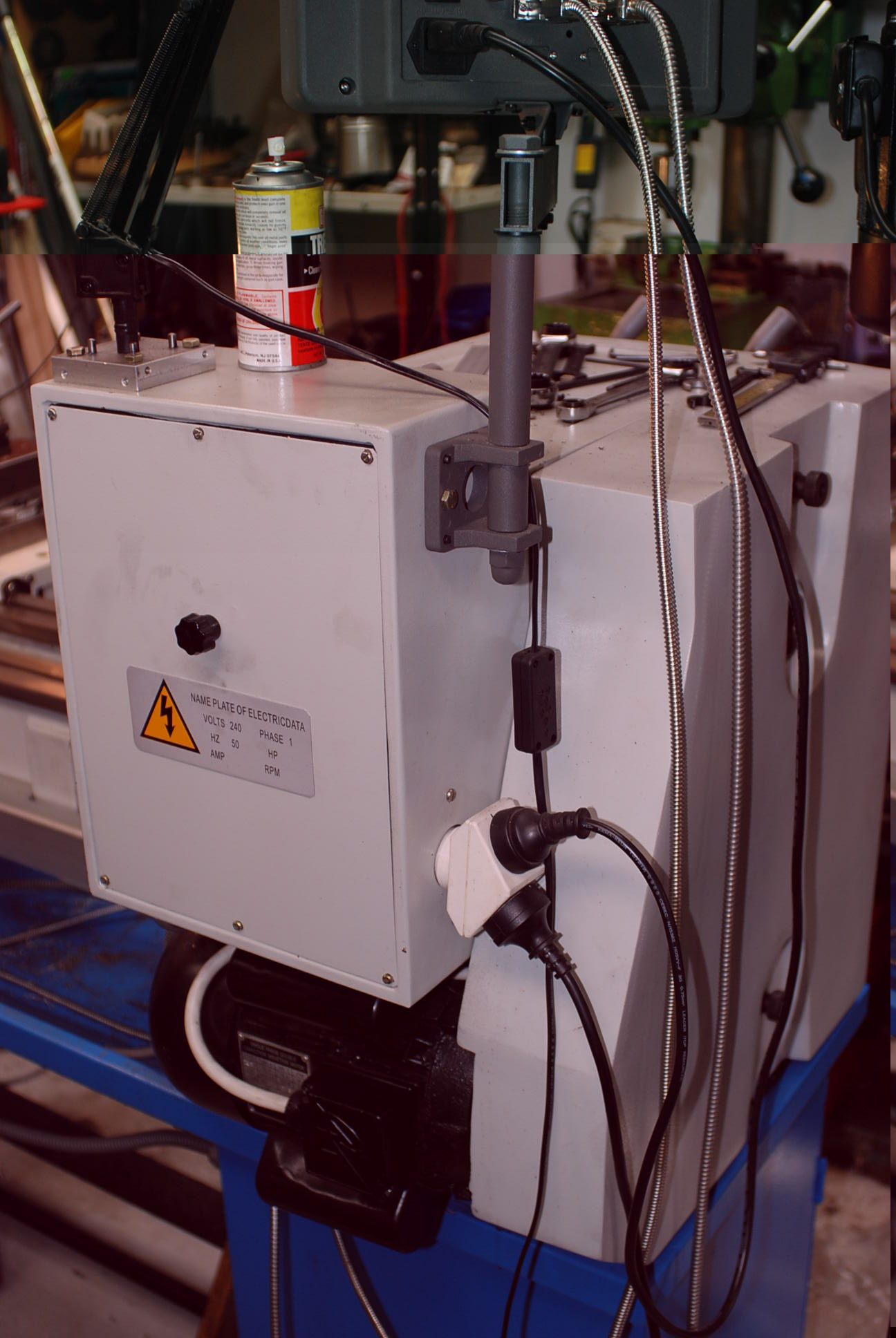

At this point i decided to mount the DRO Read Out Unit on the top of the electric box also fit an outlet to supply the unit with power.
After all that i fitted an angle poise lamp to the top of the electric box,this i have found very usefull as i can swing it around to give extra lighting to the lathe operations also the Milling Machine and a Piller Drill.

Yes it was pointed out to me by one of the  guys that helped me with the bed instalation,that the Apron traversing handle was in the prefered position.
I did not realise the worth of the position untill i went to the South Bend and rembered the times when hot swarf would pepper the back of my hands.
The brake unit works very well,i have not had to alter the sequence since i found out how it was installed.
I did have to work on the electrics for some time tracing what does what and installing the connections for the Suds Pump,Foot Brake,Halogen Lamp.
There was no information in the instruction manual so it was in my favour that i was once employed as an electronics engineer so could find my way arround.
I will have to take a look at the Tail Stock/DRO contact posibility,i never thought of that one,thanks for directing me and others who may be reading these conversations.
I have only the 9 speeds on the headstock,no problen so far.

I checked out the possible problem with the Tail Stock/Saddle contact and found that the two caped screws that secure the DRO pick up unit are about 25 thou proud,so contact the front of the Tail Stock ok.
I envisage a problem with the DRO unit being damaged if i should attempt to run off the top slide before removing the DRO.
I shall  have to devise a suitable stop arrangement to prevent screwing the saddle too far forward.
A few more photos of the rebuild showing the backs of the Apron and Gear Box before i painted them.
I do realise that even if they did rust that it would not impart too much of a problem except for the disconnecting  items on the Apron.
You also can see what i was on about back awhile when i saw possible problems with the lubrication of the shaft that drives the worm.
You can see now that the worm is semi enclosed in a cast iron surround that gives a sump like surround for holding lubrication.
This was what i wanted to fit a suitable oil feed pipe to before fitting to the Top Slide.
Any way i did not fit any lubrication feed but did subject the unit to plenty of oil,will keep an eye on it though.

I had trouble with the Suds Pump set up.
During extensive operation it was noted that Suds was coming from the base of the cabinet that houses the Pump.
After many attempts to locate and rectify the problem i finely found that spray was coming from the Pump half of the unit.
I removed the whole unit and removed the Pump,inspected and could only find a cotter pin fitted in a hole in the shaft just above the impelller.
I could see no use that the cotter pin was having so removed it,that cured the problem.
There must have been some reason for the cotter pin to be there,only thing i could envisage that it afforded some king of circulating effect on the suds.
If i do have to replace the pin i will have to provide a baffle/lid to stop suds splashing up.
I did do a mod on the electrics due to the suds unit being connected to the electric control box without any form of being able to disconnect.
I fitted a suitable socket inside the cabinet at the top out of the way and fitted a plug on the pump  cable.
So now when i wish to remove the pump unit as a whole,to clean and service i am not encumbered by the length of cable .
