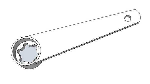

I recently took delivery of a new Grizzly G0704 mill/drill. Weiss (WMD20VL clone) Fit and finish looks good but I do have a problem with the drawbar setup. First the drawbar retainer cup starts to remove its self long before the collet is properly tightened. I would think that there would be a setscrew to prevent this but I can find no evidence of it. I called Grizzly Tech. service last Friday but the guys in the know were unavailable. Perhaps they will call with answers later this week. The next issue is where do I get a third hand? The instructions caution one to place a hand beneath the tool being removed to prevent it falling onto the table and possibly the floor. With one hand backholding the spindle while the other hand turns the drawbar the table will just have to fend for its self.
I know how the drawbar system is SUPPOSED to work but this system is a prime candidate for a power drawbar mod. In the meantime I am going with plan "B". I spent the afternoon making a spanner that fits the spline of the spindle. This will allow me to change tooling similar to way I do on my X-2. I can still use my combination spanner/mallet. I still must add a handle but the hard work is completed, making the spanner head. I have a posted a CAD sketch showing how I made it.
Still need to tram it so it will cut true. I will be back if I need help.

« Reply #6 on: January 17, 2011, 04:55:27 PM »
Thanks for the suggestions. I am posting some pictures to help in understanding the problem. I did receive a call from the Grizzly tech and was told that the nose of the spindle should have two flats for a spanner to hold it. I believe that is the way the X-3 spindle is held. In any case I have no flats.
The theory of operation for this drawbar is that the retainer cup will supply a place for a 17mm spanner to backhold while you tighten or release the collet. It is designed so that continuing to turn the drawbar anti clockwise it will contact the top of the retainer thus forcing the collet loose and not requiring the mallet. Theories don't always work in real life. The fact that both the drawbar and the retainer cap have right hand threads and there is no positive lock to prevent the retainer from turning dooms this scheme to failure. Both the Grizzly tech and I agree that this machine is a PRIME candidate for a power drawbar. That may be an option for later consideration.
This is what is seen when the access cap is removed. The spline is approx. 1/2" below the top of the motor cover.
With the cover is removed this is what you see.
With the retainer cap removed you can see the, somewhat odd, drawbar. It has a 8mm square spigot for turning it. The supplied spanner is only 4 1/2" long which limits over torquing or promotes under torquing, take your pick.
Here is the spline I made the spanner to fit. I pretty well followed the sketch I posted previously.
Two views of the spanner I made. I still must weld the handle to the body.
This is how it will be used once I get a new drawbar made.
Once the project is complete I will be able to continue using this to secure and remove tooling.
Joe
