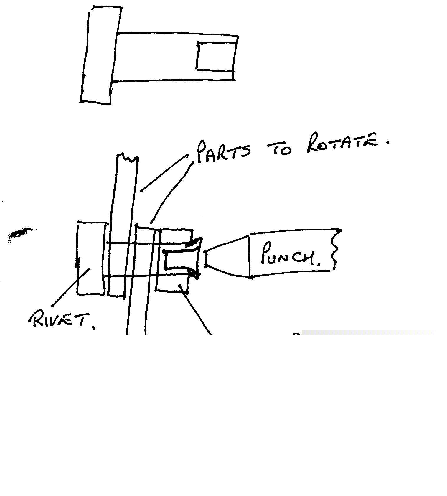

John (bogs)
How are you using the bifurcated rivets in a model application my take on that type of rivet is that they are used to hold leather or such . correct me if i am wrong but I remember them as rivet split up the shaft leaving two legs , that you can open out and fold over

I have tried those before Jason, and they don't quite look right, just like any other mass produced fittings. Plus these are shouldered bolts and plain shanks, not usually available, so I make them myself.
I used the reshaped heads a fair amount when I took Elmer's basic mine engine up a level or two.
Both square and star headed were used to cover up bearings that weren't on the original build.
Yep, the bifurcated rivets are drilled to exact depth for just gripping onto the backing washer and not the other two plate parts. They have to swivel against each other as the angle of operation changes.

Stuart,
You are quite correct in your assumption of it being a two legged rivet, maybe I should have called it a semi tube rivet.
I was just using a term we used in the forces when working on aircraft, where the two legged versions would never be allowed, except maybe by some of the fabric trades, but even then, I would have expected them to use the same as I used purely for safety's sake.
They make disassembly very easy, just drill down to the bottom of the hole with a larger drill and the whole lot comes apart.

Thanks John for the explanation  and CoC
More like a manual pop rivet with a tapered pin to expand the part outside the joint

Would it be correct to say that one can adjust the amount of play between the pivoting parts of the riveted joint by just punching it a bit more ?
I've not seen rivets used a lot in model builds of late, and I'm wondering why, as it seems a good method to use for many things...

Normally Arnold, you use a rounding over type of punch to make it look slightly like a dome head rivet, but a taper punch is plenty good enough for what I am doing, in fact I will be using a 90 degree centre punch end so the swelling is more towards the surface, so leaving the parts turnable loose rather than clinching them together.
The depth of hole plays an important role, too deep and it swells inside the rotating parts and locks them up, and yes, the easy way is to gently punch until you get the correct side float (not sloppy) and still have nice fairly free rotation.
If you want to get very technical and work it out with a calculator, there are charts about to give you starting points. But really it isn't necessary, I just drill down to depth until the drill tip reaches a point the same thickness as the parts being joined, and put a supporting washer on the opposite side of the head. I leave about 1/16" protruding from the washer.
