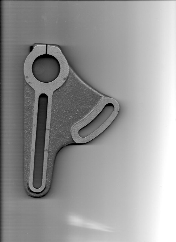

Hi Lads ,, a bit help needed
Has anyone got a myford slotted quadrant for metric /dp/ba threads ,, if so any chance of a photo and a bit measure up of it  :dremel:

Is that the thing with two slots at an angle ?? And a biggish hole at one end to pivot on ????
like this ...

Hi Rob
YES  I've got one... just took the piccy ...
Sorry, a bit dieseled up at the mo.
Been on the sozzle  :beer:
What measurements do you want .. all of them ???
BC

« Reply #10 on: January 15, 2011, 12:07:01 PM »
What a Star  :bow: :bow: :bow: :bow:  :D
Just what i need  :D i no the bore size so i can work everything out from that  :ddb: :ddb: :ddb:

Re: Myford slotted quadrant
« Reply #13 on: January 15, 2011, 02:16:39 PM »
Why do you need one ?
John S.
« Reply #14 on: January 15, 2011, 02:24:41 PM »
Hi John
So i can cut a 16 DP worm on a shaft   :dremel:

Don't know if it will physically fit but if you replace the 24tooth gear with a 52 tooth one and select 11 tpi that will give you the same ratio, or very, very close to it.
John S.
« Reply #20 on: January 17, 2011, 03:09:10 PM »
Hi John
probably would  :thumbup: i worked it out to be  very close to 5TPI  ,,,,,,,,,,, done casting now  :coffee:

« Reply #23 on: January 19, 2011, 04:23:47 PM »
Cheers Lard  :thumbup:
Chris ,,,,,,,, its well worth the effort to set up a small foundry  :dremel: :ddb: :ddb: :ddb:
Here it is machined up ,,, pattern needs to be altered as i had a slight miss calculation on the thickness  :doh:  ,,,This one will get me by until i cast another in cast iron this summer .
Now i can get back to  what i was doing  :ddb: :ddb:
