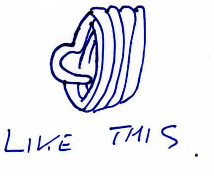

Finished off the governor and got it hooked up to a drive belt, bin using one of those long springs john gave me but it keeps coming apart in the end I tried a spot of supper glue on the joint how do you guys join them up.

Stew,
For joining the spring belt, you bend out a tiny half loop hook at each end from one of the spirals and just link them together. If it is a standard Mamod type, one end should be tapered down so that it screws into the other larger end.
