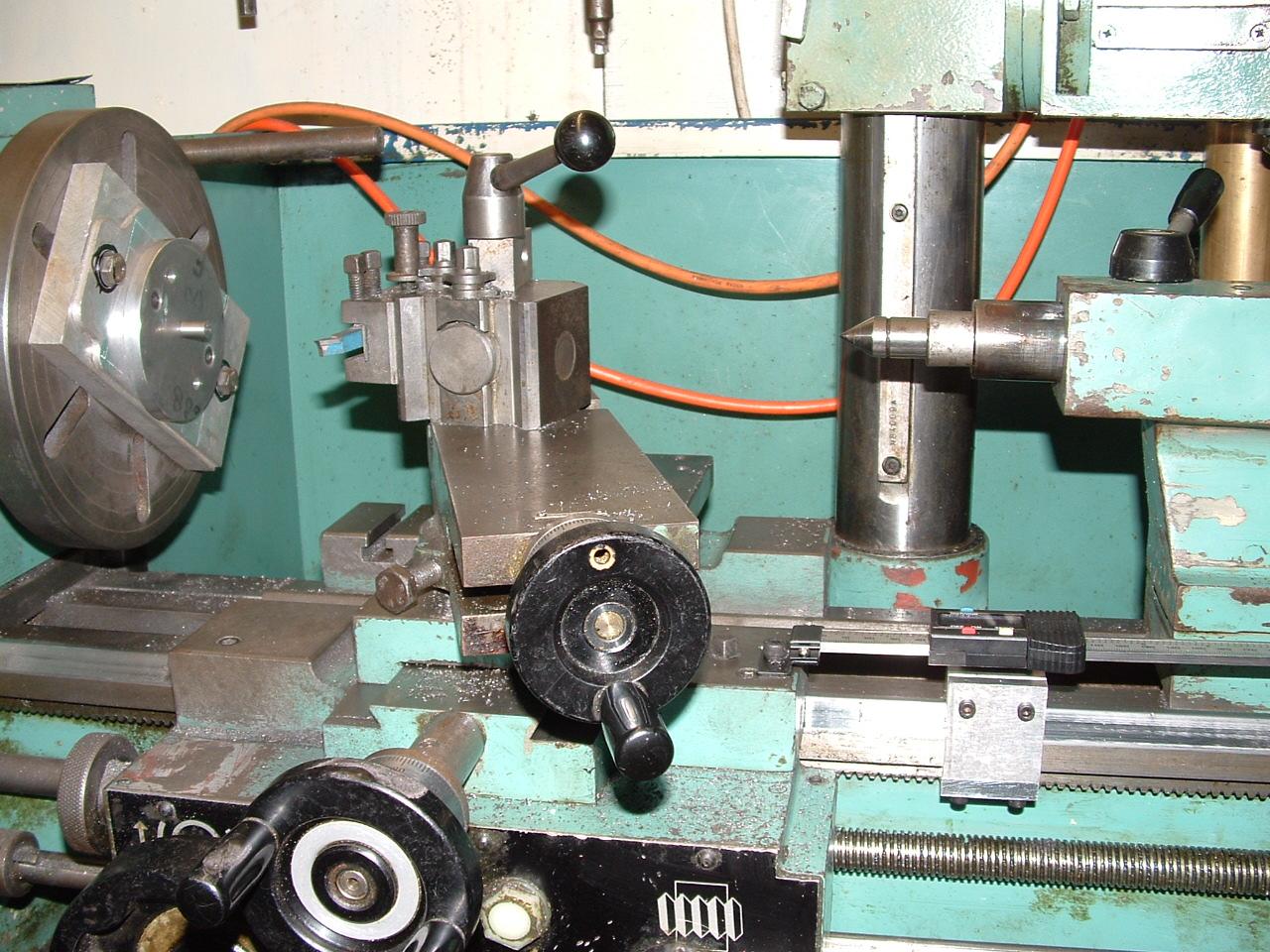

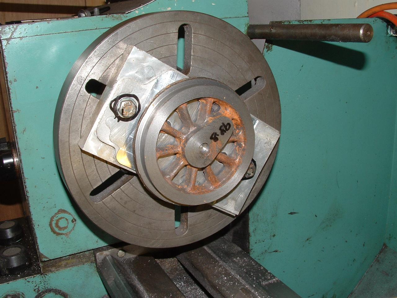

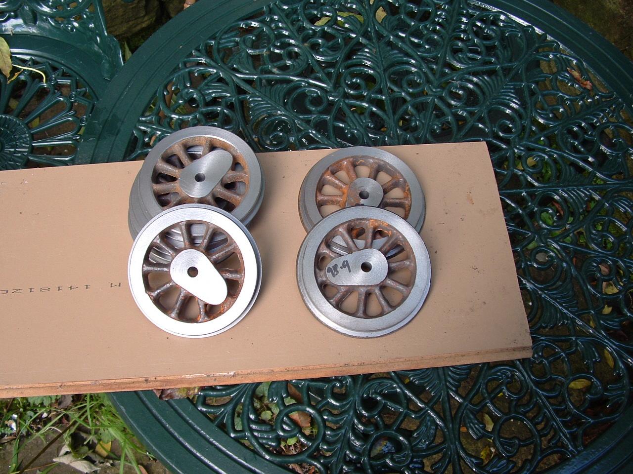

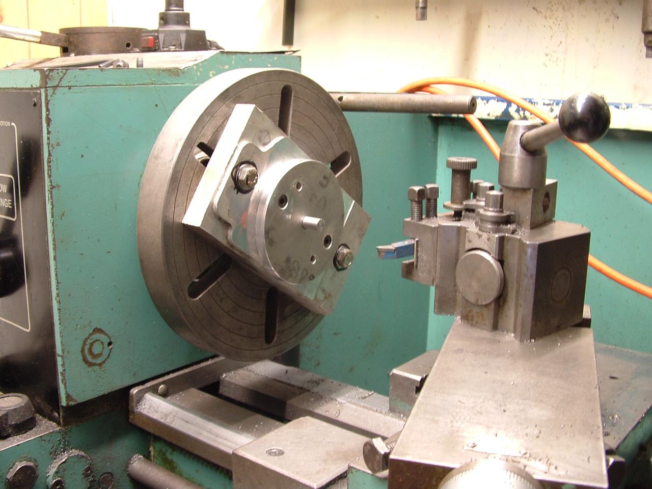

« Reply #15 on: October 19, 2016, 08:16:17 AM »
Well, three and a half years (more) and not much progress.
But I did finally get around to attacking the wheel castings that have been sitting around gathering dust.
I made up a fixture plate to make it easier to hold the wheels in the same position.  It needs a slight modification before I give the wheels a final 'to size' skim.
Here a few pictures to show the results.  Four down, two to go.
You will notice the 'Poor Man's'  DRO bolted to the carriage.  Should have done that years ago. It makes life so much easier.
Ignore pic file names. Don't know how that happened.
