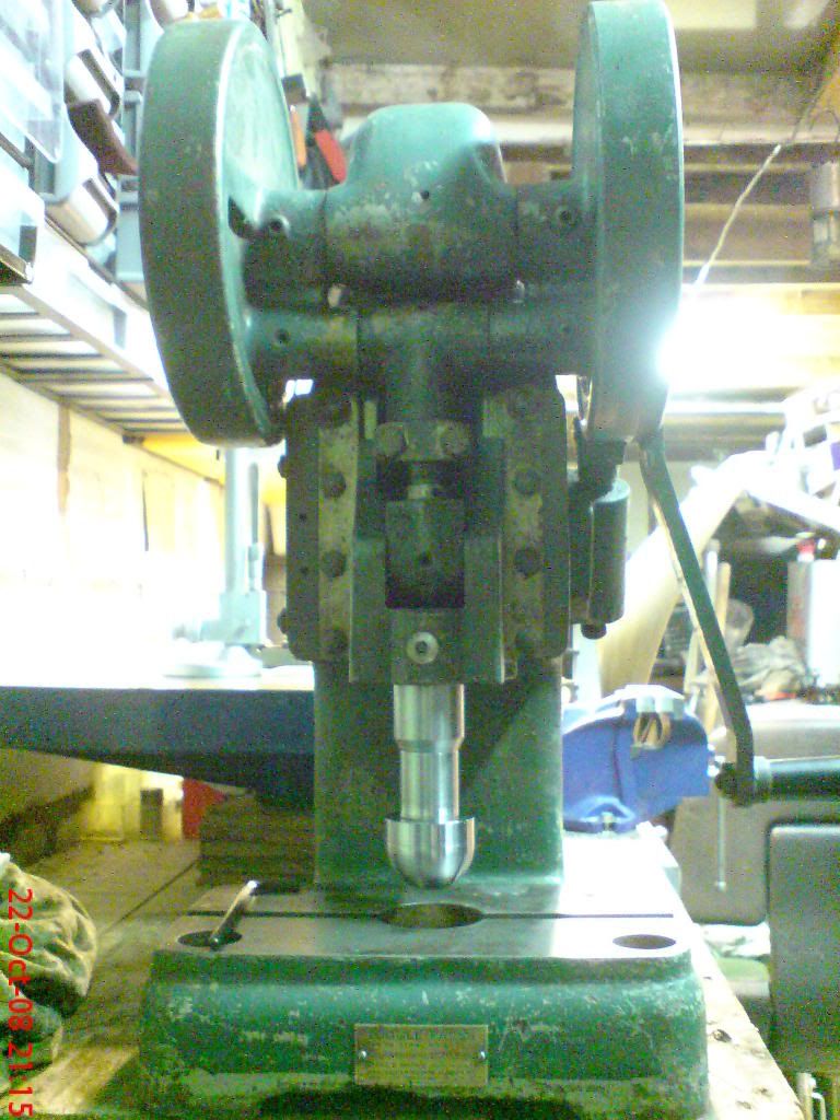

My donated toggle press (what a beast!!!)

Still waiting to see those sphere's made for the Aeoipile. I saw that punch press as I scrolled through this thread.  :poke:

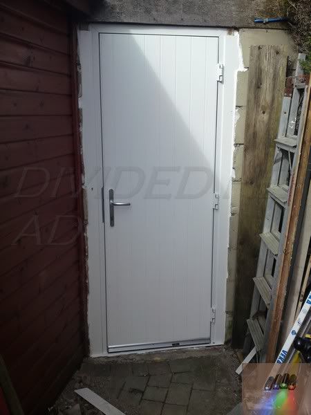

First there was a new composite door with PVC frame that came for free.... I know  :jaw:  Donations are always welcomed  :)

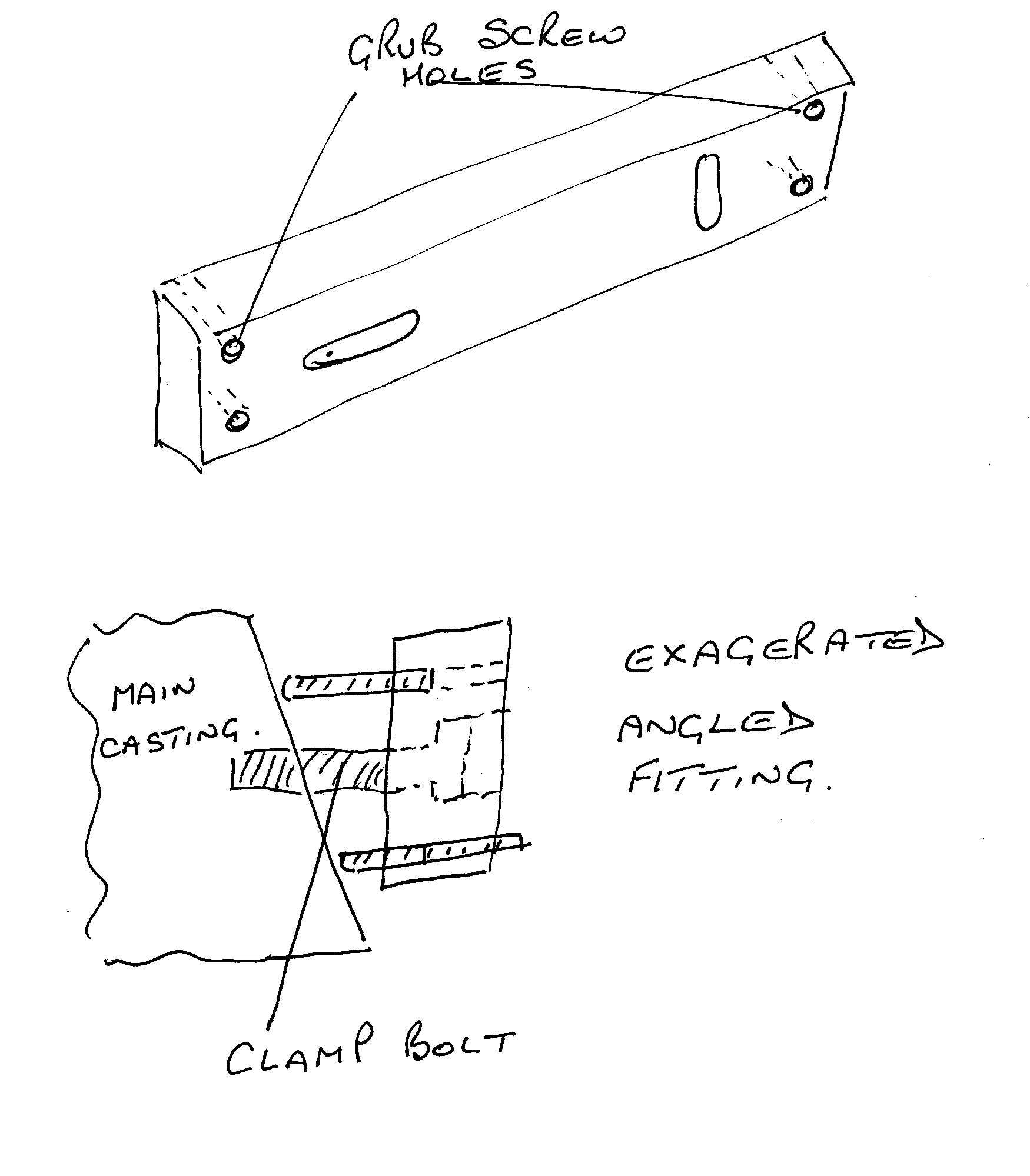

« Reply #44 on: May 22, 2011, 04:44:01 PM »
Sorry about the delay, after my mate called today and plugged his flash drive into my computer, I can't get my computer to display my camera icon, so I can't access it. Anyway, I used another camera and swapped cards over to get to the pics.
As you can see, they are only a single bar mount, you can just see the two ends amongst the garbage hanging off the back of mine in the top shot. One end is bolted and levelled up to the machine, and the spigot on the bottom of the display head drops in a hole on the other end of the bar.

Thanks John, just what I needed to see.
It was the round bit on the head unit end that confused me.
I know I have the bracket now. :)

« Reply #64 on: May 30, 2011, 03:29:18 AM »
Ralph,
The standard practice for these sorts of mounts is to drill a hole in each corner and put a grub screw into each hole.
Then with the main clamp screws just tweaked up, and using the jacking grub screws, you can level the holding bar very accurately against almost any uneven surface.
The main clamp bolts don't have to be super tight, as very little force is required to move the heads, but if you are worried about it bending the mounting rail, you put more grub screw holes in strategic locations that are just tweaked up to touch after the four corner mounts have the rail perfectly level and vertical in all planes.

Re: A few pics of my shop...
« Reply #65 on: May 30, 2011, 06:42:22 AM »
Just what Bogs says, I have the air lift cylinder on my bandsaw mounted that was and it's onto a rough casting at about a 15 degree angle but the mounting is vertical.

« Reply #66 on: May 30, 2011, 06:48:28 PM »
Ok, so you guys have much more smarts than me  :smart:    :)
I'll have to investigate and see what I find. It does appear to be working perfectly now that it has no bits of swarf stuck in the plug!
If I check it and all is good I'll probably leave it alone. No point in fixing what ain't broke!  If it needs tweeks I will insert jacking points and go from there  :thumbup:
You might have thought that the manufacturer would have put such things in place? Or at least suggested it in the instructions?!  :poke:
Anywho, been playing quite happily over the last few days (henceposts at 4am!... Lost track of time!) Steady yourselves.... Nearing completion of my rocking engine!! Only started it about a year or so ago  :bugeye:  no pic's yet though.... Still computerless  :(
« Reply #67 on: May 31, 2011, 02:16:23 AM »
You are quite correct Ralph.
I only showed that because it is standard practice when mounting things onto uneven or angled surfaces. Now everyone knows the secret.

« Reply #68 on: May 31, 2011, 07:16:46 AM »
There are manufacturers of these cheaper DRO's supplying backing plates with jacking screws. I think my Meister manual has it in it but never come supplied with back plates.
When I installed mine, I used jacking screws on both the reader head and scale as the brackets where welded up and you cant always get them perfectly true.
I perfect spot for them would have been on your Y axis instead of using packers.
