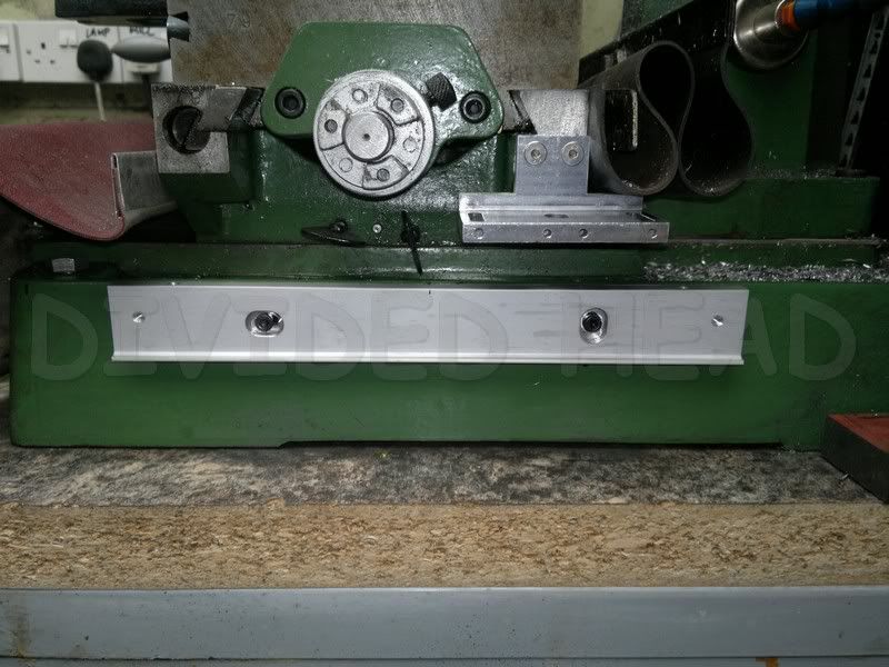

Well.... I just spent about an hour writing a full blown post on my works and it got erased when my mum's computer decided to shut down IE8... POS!  :hammer: :hammer: :hammer: :bang: :bang: :bang:
So here we go again!
Thanks for the tips fellas, will look into them if my tech nerd fails (shouldn't do.) at least I have every picture and video saved on 2 external hard drives
Now, on to the mill....
First was to butcher a few of the brackets provided with the DROs....
http://i289.photobucket.com/albums/ll221/dividedhead/machine%20mods/New%20mill%20-%20DROs/Pic446.jpgA few pics of my shop...
In the instructions it has all sorts of jiggery pokery with a finger/dial gauge... I opted for a different approach, being so damn lazy!   :coffee:
My little Wixey digital angle meter. accurate to 0.1 of a degree will do me.  (thanks for the batteries John  :thumbup: )
This approach will work just fine as it's set to zero on the mill table and then used to make sure the brackets are square to the table.
http://i289.photobucket.com/albums/ll221/dividedhead/machine%20mods/New%20mill%20-%20DROs/Pic451.jpgA few pics of my shop...
http://i289.photobucket.com/albums/ll221/dividedhead/machine%20mods/New%20mill%20-%20DROs/Pic452.jpgA few pics of my shop...
The rear mounting plate for the 2 part shield is fitted, the good thing about this is it is the mountig plate for the scales with the holes pre drilled and tapped.
So once it is in position the scales should be too... Checked with the wixey .... Spot on!
http://i289.photobucket.com/albums/ll221/dividedhead/machine%20mods/New%20mill%20-%20DROs/Pic455.jpgA few pics of my shop...
My mill foot is angled so I needed to set the bracket away at the top till it was plumb with the mill table.
Using the wixey on it's side it was zeroed on the mill table and then the plate moved out at the top till it read zero, making it the same. It needed an ~3mm gap at the top so 2 pieces of 1/8 HSS steel were employed as packers and once they were wriggled into position and all was tight it was checked again with the wixey.
This is actually plumb with the mill table!
http://i289.photobucket.com/albums/ll221/dividedhead/machine%20mods/New%20mill%20-%20DROs/Pic454.jpgA few pics of my shop...
Another bracket butchered and the drop bracket and spacer are created and fitted...
http://i289.photobucket.com/albums/ll221/dividedhead/machine%20mods/New%20mill%20-%20DROs/pic464.jpgA few pics of my shop...
http://i289.photobucket.com/albums/ll221/dividedhead/machine%20mods/New%20mill%20-%20DROs/pic468.jpgA few pics of my shop...
The rear scale is fitted in much the same way but I had to fab up a new bracket from scratch to fit around the oil nipples and
fit to existing holes since I couldn't get the drill in without removing the mill's column.... Erm, no chance!
http://i289.photobucket.com/albums/ll221/dividedhead/machine%20mods/New%20mill%20-%20DROs/pic473.jpgA few pics of my shop...
Can we say "bodge it and scarper clamping method" ?  Well doesn't everyone use a piece of 6mm threaded bar in a pinch :scratch:
http://i289.photobucket.com/albums/ll221/dividedhead/machine%20mods/New%20mill%20-%20DROs/pic476.jpgA few pics of my shop...
Fitted. ready for test (see above posts for that! )
http://i289.photobucket.com/albums/ll221/dividedhead/machine%20mods/New%20mill%20-%20DROs/pic485.jpgA few pics of my shop...
Last bit of fab'n'fit, the mounting of the head. There is absolutely no where on my mill to fit the mounting bracket.
so it's on the wall with it!
http://i289.photobucket.com/albums/ll221/dividedhead/machine%20mods/New%20mill%20-%20DROs/pic495.jpgA few pics of my shop...
http://i289.photobucket.com/albums/ll221/dividedhead/machine%20mods/New%20mill%20-%20DROs/pic499.jpgA few pics of my shop...
http://i289.photobucket.com/albums/ll221/dividedhead/machine%20mods/New%20mill%20-%20DROs/pic498.jpgA few pics of my shop...
And my first attempt at programing. The pocket mill feature. Shallow as a test on a bit of the left over bracket they supplied.....worked a treat!
http://i289.photobucket.com/albums/ll221/dividedhead/machine%20mods/New%20mill%20-%20DROs/pic502.jpgA few pics of my shop...
Well, that's it. Now for a bit of round tuit catch up...
Ralph.

Nice one Ralph, your machining accuracy has just got at least 100% better, despite the cobbled up jobs on the brackets (I did the same with a couple of mine).
I found it bliss not having to compensate for backlash, and as you have seen how I work, the handles and their scales are never looked at, I rely purely on the truthfulness of all my Sino DRO's, and not once have they let me down.
BTW, put the protective cover on the display head, they really do keep it protected from swarf and keeps it nice and clean from those grubby fingers poking it all the time.

Ralph - just one little note ....
....In the instructions it has all sorts of jiggery pokery with a finger/dial gauge... I opted for a different approach, ........My little Wixey digital angle meter. accurate to 0.1 of a degree will do me. ....... This approach will work just fine as it's set to zero on the mill table and then used to make sure the brackets are square to the table........
Levels of various sorts are great to trim the scales in roll and pitch, but can't help in yaw.  With, for example, the Y scale, by using the level you can take out any vertical twist and and difference in height front-to-back; but what the level can't assess is if the two points on the base casting that the scale is mounted to are genuinely parallel to the Y axis. What you really need to do is to mount the scale base to the mill's base casting; run the table all the way over to the left as it is your first photos, and pop a mag mount indicator on the end of the table with the finger running on the scale base, and then run the table back and forth in Y - you may well find you have to shim the front or back end of the scale to get it true.  (BTW, when I fitted these same scales to my Warco GH mill, I fitted the Y scale to the left of the base so as to leave free access to the gib lock screws).

« Reply #63 on: May 29, 2011, 11:09:19 PM »
Hi Dave,
I understand what you are saying bout the guages.
I'll look at it tomorrow when I'm in the workshop. No harm in checking.
I couldn't fit to the left hand side of the mill as the power feed unit is there. I can still access the locking screws quite easily though.... That's why the bracket is fitted to the back edge of the bed.
Ralph.

« Reply #64 on: May 30, 2011, 03:29:18 AM »
Ralph,
The standard practice for these sorts of mounts is to drill a hole in each corner and put a grub screw into each hole.
Then with the main clamp screws just tweaked up, and using the jacking grub screws, you can level the holding bar very accurately against almost any uneven surface.
The main clamp bolts don't have to be super tight, as very little force is required to move the heads, but if you are worried about it bending the mounting rail, you put more grub screw holes in strategic locations that are just tweaked up to touch after the four corner mounts have the rail perfectly level and vertical in all planes.

Just what Bogs says, I have the air lift cylinder on my bandsaw mounted that was and it's onto a rough casting at about a 15 degree angle but the mounting is vertical.

Ok, so you guys have much more smarts than me  :smart:    :)
I'll have to investigate and see what I find. It does appear to be working perfectly now that it has no bits of swarf stuck in the plug!
If I check it and all is good I'll probably leave it alone. No point in fixing what ain't broke!  If it needs tweeks I will insert jacking points and go from there  :thumbup:
You are quite correct Ralph.
I only showed that because it is standard practice when mounting things onto uneven or angled surfaces. Now everyone knows the secret.

There are manufacturers of these cheaper DRO's supplying backing plates with jacking screws. I think my Meister manual has it in it but never come supplied with back plates.
When I installed mine, I used jacking screws on both the reader head and scale as the brackets where welded up and you cant always get them perfectly true.
I perfect spot for them would have been on your Y axis instead of using packers.
