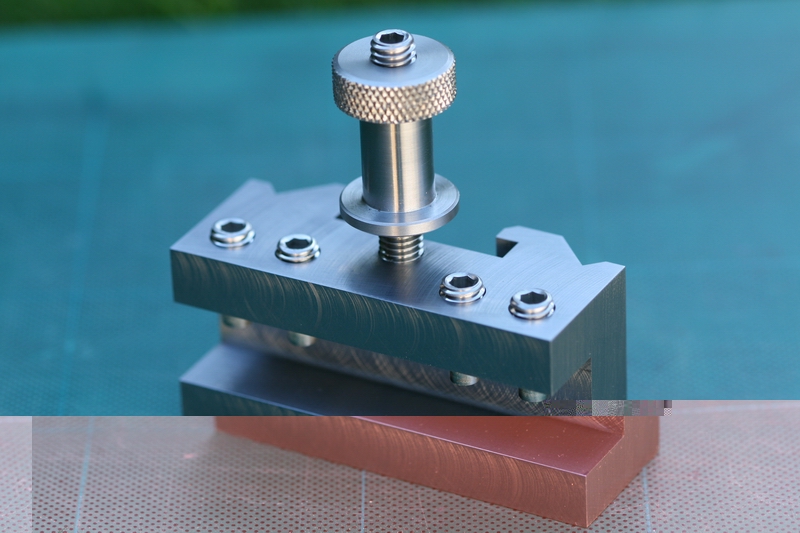

I have recently completed 5 of these additional toolholders, but drew the line at trying to case-harden them. Another one is earmarked for a threading-tool holder as shown by the Bog Master.

Very nice machining job. Very clean and crisp looking.
Re: 'Dickson ' type toolholders
« Reply #2 on: November 29, 2010, 03:11:44 PM »
Yup. That is some mighty fine looking work!
« Reply #3 on: November 29, 2010, 05:04:25 PM »
Really nice clean looking job

Spurry, have you got any set up pictures? I have a T2 post  ( on a Colchester master)  and would like to make some holders.
« Reply #5 on: November 30, 2010, 07:20:38 PM »
Thanks for the kind comments, but I do feel like an amateur having seen some of the magnificent threads on this forum.
Lee
When I started making the holders, (some time ago) I did not bother too much with pictures. Sorry. As the two angled cuts were the most critical I decided to start with those, but had to rough out the rear central slot first. The main toolblock holder was stripped of its cam mechanism - this helped enormously. The angles could then be checked for fit as machining progressed.
The toolholder blocks were just rested in a small V block in the vice.
The toolholders are unhardened, as I could not find anywhere local to do it, so it remains to be seen how long they last.....I wish I had a surface grinder too.

I made a set of 8 from mild steel many years ago, and I can't imagine going back to the old methods.  I never thought of hardening them but, if you wipe the mating surfaces every time before fitting them, they should last for ever.  One word of advice: removing the outer skin from the lump of bright drawn mild steel, then cutting a large slot across it for the tool to fit into, will cause it to distort slightly, so rough them out all over before finally finishing to size.  This doesn't matter too much, of course, except for the two angled surfaces.
Interesting, I cut the Vs first so I could get a rough centre from a line scribed on the face
I found I could cut both Vs in one set up by stepping across and down by the appropriate amount (ISTR this was 34mm across & down for the small myford sized blocks) The depth of the T slot is the only critical thing as I remember.
I wouldn't bother to harden them, it wont change the strength at all and there is no real wear mechanism so they should last until destroyed in a crash ;)
