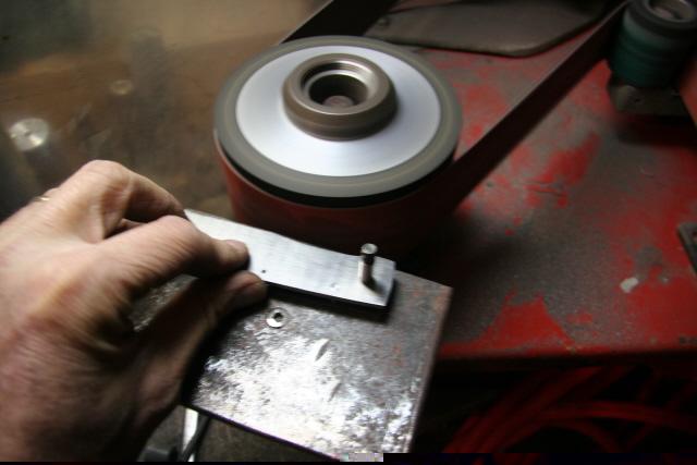

The next pics show how I clean up the blade on the disc sander to remove the burs left by the saw. Then I mark the holes with a punch and drill with a 1-72 tap drill.

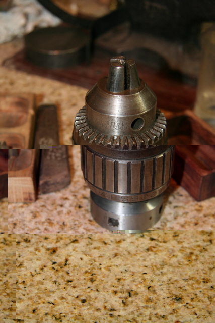

Tell me about that drill press?
Offline Blade
  • Posts: 119
Re: How I build a custom knife
« Reply #13 on: November 18, 2010, 12:03:15 AM »
The drill press is  a turret made by Burgmaster, by pushing backwards on the handle you can switch to the next drill bit, there are 6 chucks. The head moves clockwise so I have my drill bits in order starting with an 0-80 tap drill then 1-72 and 2-56 drills. I also have two countersinks for 0-80 and 1-72 screws. I have three of them two are model 0-b and one is a model 1-d, the 0-b's are 1/4" capacity and the 1-d is 1/2" capacity. They are great machines for knifemaking because I don't have to change bits all of the time between different sizes.

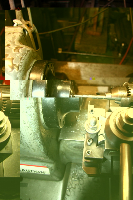

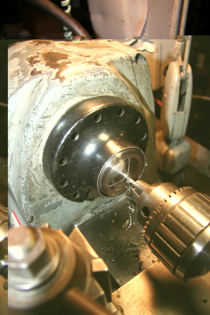

The next step is to make a couple of washers out of black toughened nylon. I use a couple of different cutters to punch out the washers. Then I place the two washers on the sides of the blade and measure to determine the thickness of the stop pin center section and the backspacer or standoffs which are held between the scales by the three screws.
The last two pics show 3/16" 416 stainless in the lathe being turned for a stop pin. On this type of knife I use a shouldered or stepped stop pin because there is nothing to retain the pin.

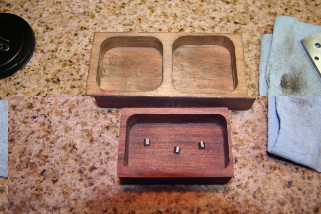

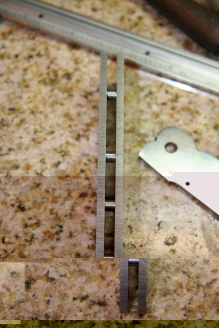

The next picture shows the liners assembled with the standoffs, these parts have to be all the same dimension or you will have a problem with the blade being off center and hitting the sides or binding and not opening and closing smoothly.
The other picture is of some little boxes i make on the mill for handling parts as I am working on them, the two compartment box is nice when you are polishing screws or some other repetetive steps because as you finish a part you just transfer it to the opposite side.
