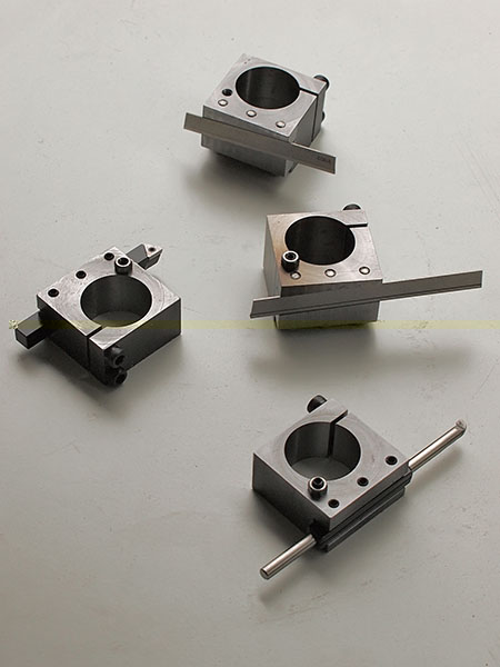

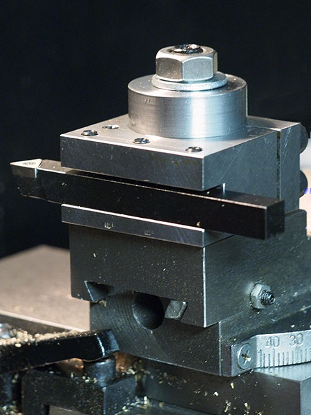

After some discussion on another thread on this board, I've finally finished my "clamp on" Toolpost.  My C2 Sieg lathe came with a standard dovetail cheap toolpost, which has been adequate for the 3 or 4 years that I've had the lathe.  There were always problems with chatter, especially when parting off, which I put down to overhang of the compound slide, and general flexibility in the whole "system".  I spent a lot of time doodling the alternatives, which mainly fell into the dovetail or clamp on styles.  The dovetail type was discounted because I felt that they were unnecessarily complicated, also I was concerned about some of the wear points with unhardened metal.  I do worry a lot.  So it was to be a pillar with clamp on toolholders, following especially the ideas of Ralph Patterson, George Carlson and Bruce Simpson....thanks guys!!.
The toolholders were 25mm slices off of a 50mm x 50mm square S1214 (free machining)bar.  After that the details pretty much sorted themselves out.  A 35mm diameter central post was used to provide the maximum clamping area and the maximum stiffness.  The hardest bit was generating the nominally 35mm diameter hole, but it ended up ok, using the 4 jaw in the lathe.  I did investigate the possibility of watercutting the bore, the person I spoke to wanted $432 for twelve holes.  Laser cutting was a possibility at $10 per hole, but there was the problem of the heat affected bit possibly being hard to get through.  A holesaw was bought, but neither my C2 lathe, or the X2 mill provided enough oomph, so the 35mm holes were drilled and bored.  The diameter of the bore was kept as close as possible to the post size, I have no way of measuring the bore other than a vernier, which wasn't a great deal of help, the last couple of cuts on the bore were very light!! That effort has been vindicated by the clamping provided by the two screws being huge.  I'm pretty sure that non arthritic fingers could provide sufficient torque to enable light cuts to be taken.
Originally there was to be a single M8 clamp screw, but this was changed to two M6 clamp screws when the M8 one wouldn't fit!!  Rather than make all the set screws and stuff, good quality (Unbrako) socket head fasteners were sourced.
So far the "upside down" parting off process has been a revelation.  Running the lathe backwards at 1200rpm, chatter free, no dramas is fantastic.  Worth the effort for that alone.  Today I turned a piece of Grade 5 titanium, and ended up with a superb surface finish!!  All in all its turned out very well, and it would be fair to say I'm pretty chuffed.  I ended up with twelve standard toolholders, and two parting toolholders.

I've done some more pratting about parting off, I was a bit concerned that the "1,200 rpm " was a fluke.  Well, glad to report that it wasn't.  The 1,200 rpm was on 1/4" dia brass, so higher speed could be expected, but just now, purely in the interests of providing real data the experiment was repeated and expanded, the results were..........
1/4" brass, 0.04" blade, 1,450 rpm, no worries could probably go faster but there's not really a lot of point.
5/8" 2011 T3 (I think it was T3 anyway), 960rpm, 1/16" wide blade, some dibbled on kero (paraffin) was used.
1/2" silver steel, 700 rpm, 1/16" wide blade, there was some chatter at about 730rpm, hence the 700!  Some dribbled on oil/kero was used
Both parting blades were the Warner HSS 1/2" blades from Little Machine Shop, and the spindle was rotating clockwise
http://littlemachineshop.com/products/product_view.php?ProductID=1728&category=202639332
So the main purpose of the project has been 110% achieved, since the original set up mean't that parting off was always heart in mouth stuff at very much lower speeds.  For the 1/2" silver steel for instance a typical parting speed was about 200rpm
So I'm even more chuffed than I thought I was!

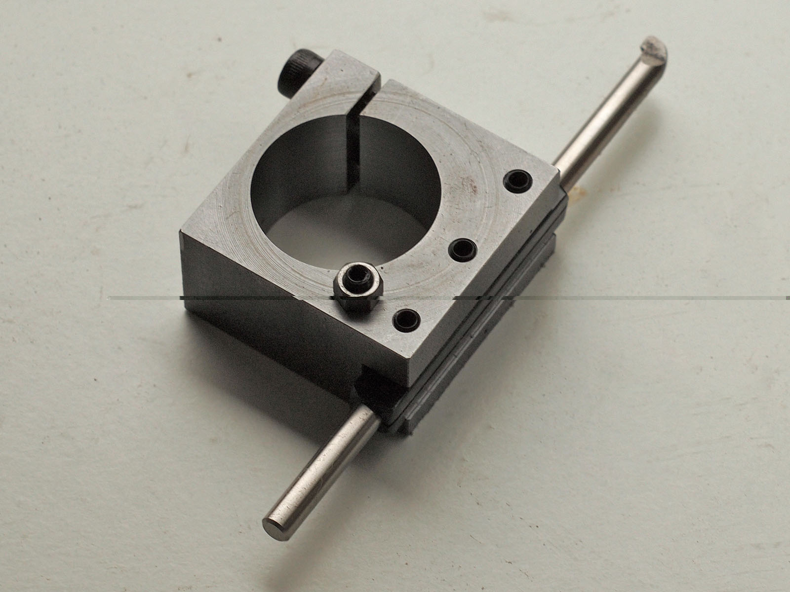

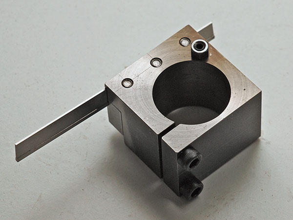

 I've had some requests to show more detail of the parting toolholder, so as they say...yer tis
 Again parting is done with the motor running in reverse.
Hope that these photos make things clearer
cheers
Bill Pudney
